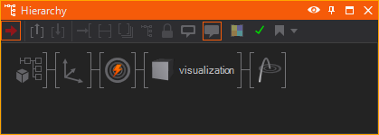

In order to use the Touch Simulator you will need to place it in 3D space in your Scene simply by using Axis Nodes. Define an Id that should be used to reference this Node with a Draw Touch Ray Node. It can be used to visualize the Ray it is casting in the respective Touch Modes.
Like with the Tracked Controller the Draw Touch Ray Node will search for the 3D Touch Simulator Node with the same Id and visualize its Touch Method with the chosen DrawTouch property group. The Cube Node in the screenshot is used to visualize the Controller itself but you can use any other Geometry as well.
