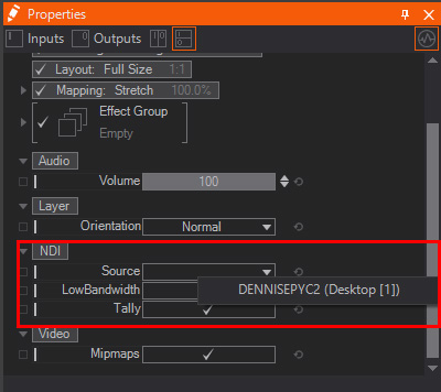

The NDI Properties can be found by  clicking on the 2D Layer - NDI Receiver Layer. You can select a NDI Source from there if one is available, by click  the Source drop down menu and select an appropriate item from the list. As for all NDI related sources, you can activate the LowBandwidth property to save bandwidth on the network.

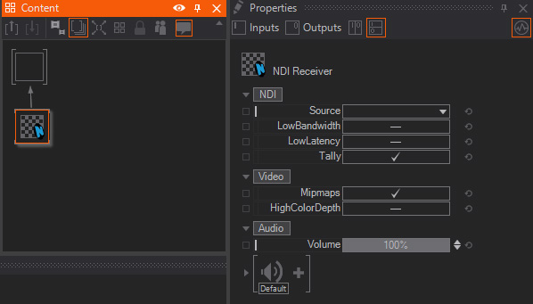

NDI Receiver Node
Drag&Drop  the NDI Receiver node into the hierarchy editor. This will create a Material node with an NDI Texture Source as BaseColor. To modify the properties for the NDI Receiver node, select the NDI Receiver from within the content editor. If you click  the NDI Receiver node you can change all of the values inside of the property editor; for example, select a Source or adjust the Volume as the audio will be embedded into the NDI Stream.
Use the click  the Source drop down menu and select an appropriate item from the list.

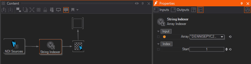

NDI Source List
You can make use of the provided Array from the NDI Source List node by binding the output of the NDI Source List to an Array Indexer node with a String input. As soon as your network has several NDI Streams available you can switch trough the streams by changing the Index Value of the Array Indexer.
The output of the String Indexer would be bound to the NDI Receiver Source selection.

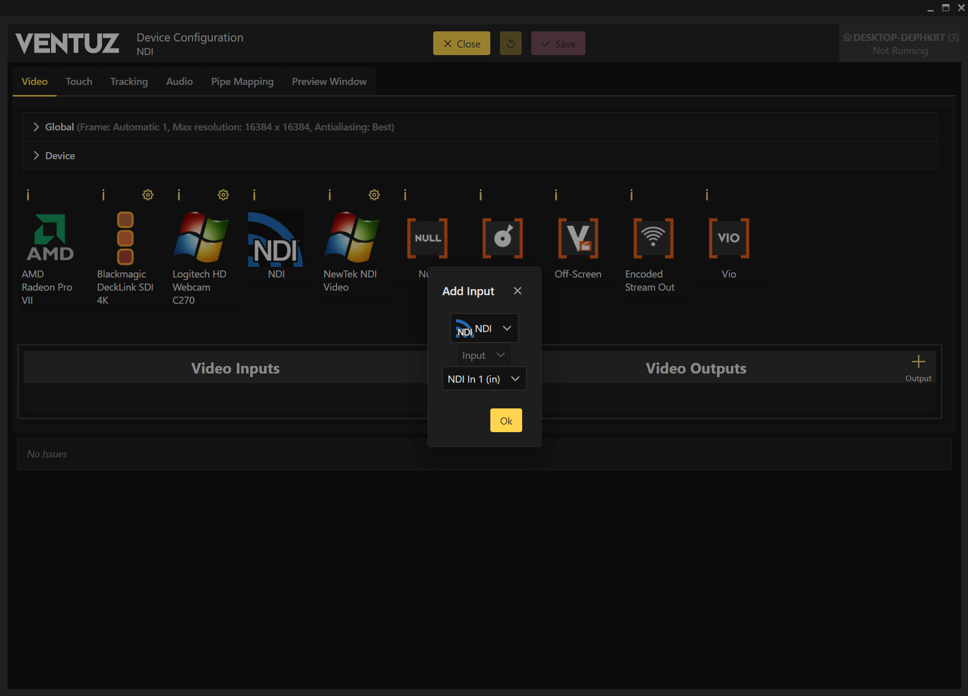

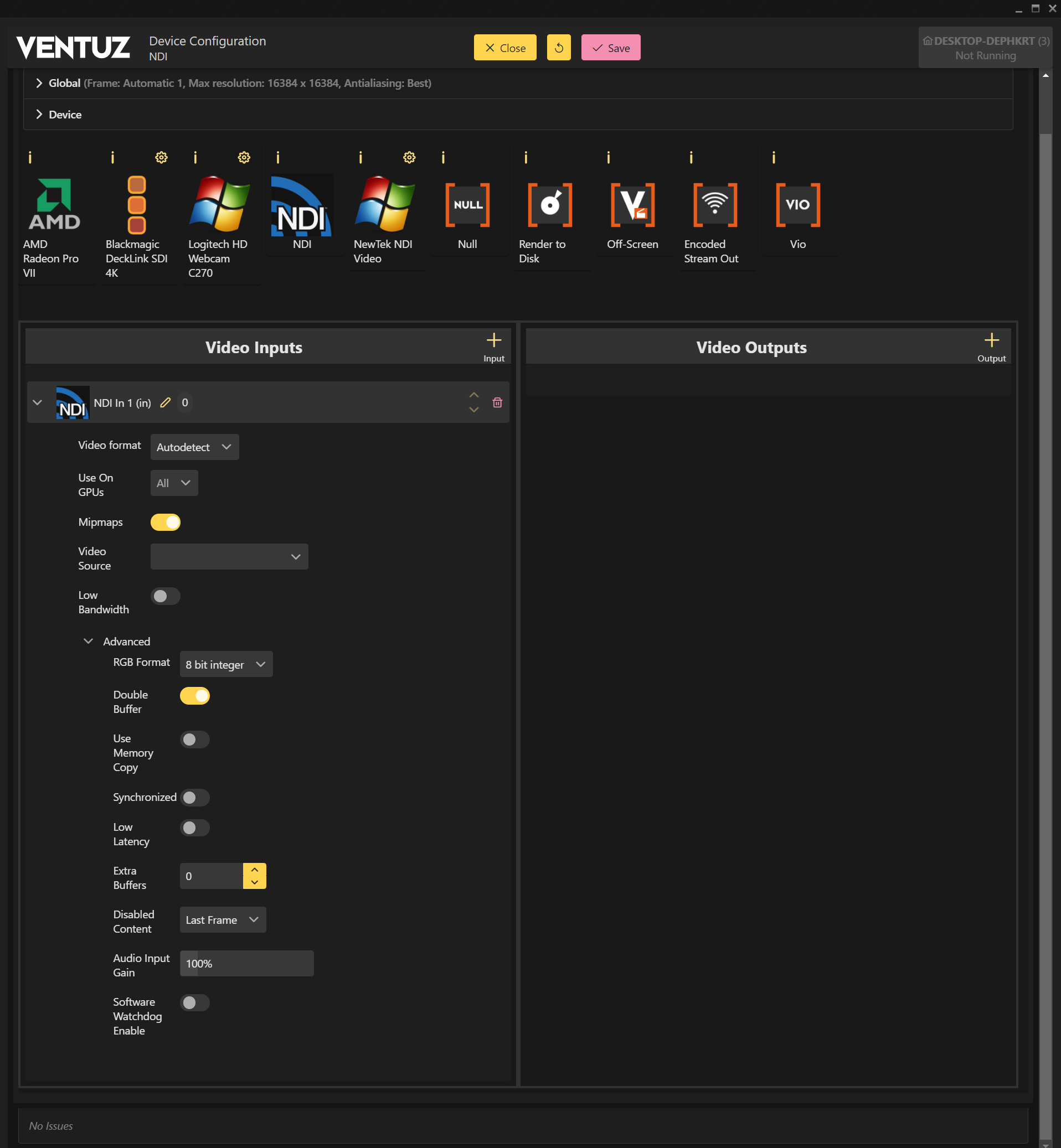

Open the Configuration Editor.
To setup an NDI Input, Drag&Drop  the NDI icon from the Devices top bar into the Inputs section. A dialog box will pop up where you can define which Port should be used as an input.
Input Properties
 click the small triangle in front of the NDI Input Source to unfold the NDI Properties. Additional options can be found by  click on the small triangle beside Advanced Settings. This will show you all of available properties for the selected NDI Input:
  • Video Source: here you can type in the Video Source if you already know the string. The formatting would look exactly like this : VENTUZ-PC (Windows Explorer). If you already have an NDI Stream available and use the NDI Video Monitor to select the Source, you see the exact string you would need to enter. See the Screenshot taken from the NDI Video Monitor selection :
  • Low Bandwidth: this checkbox enables a low bandwidth stream.
For more detailed information about the Advanced Video Options please refer to the user manual.

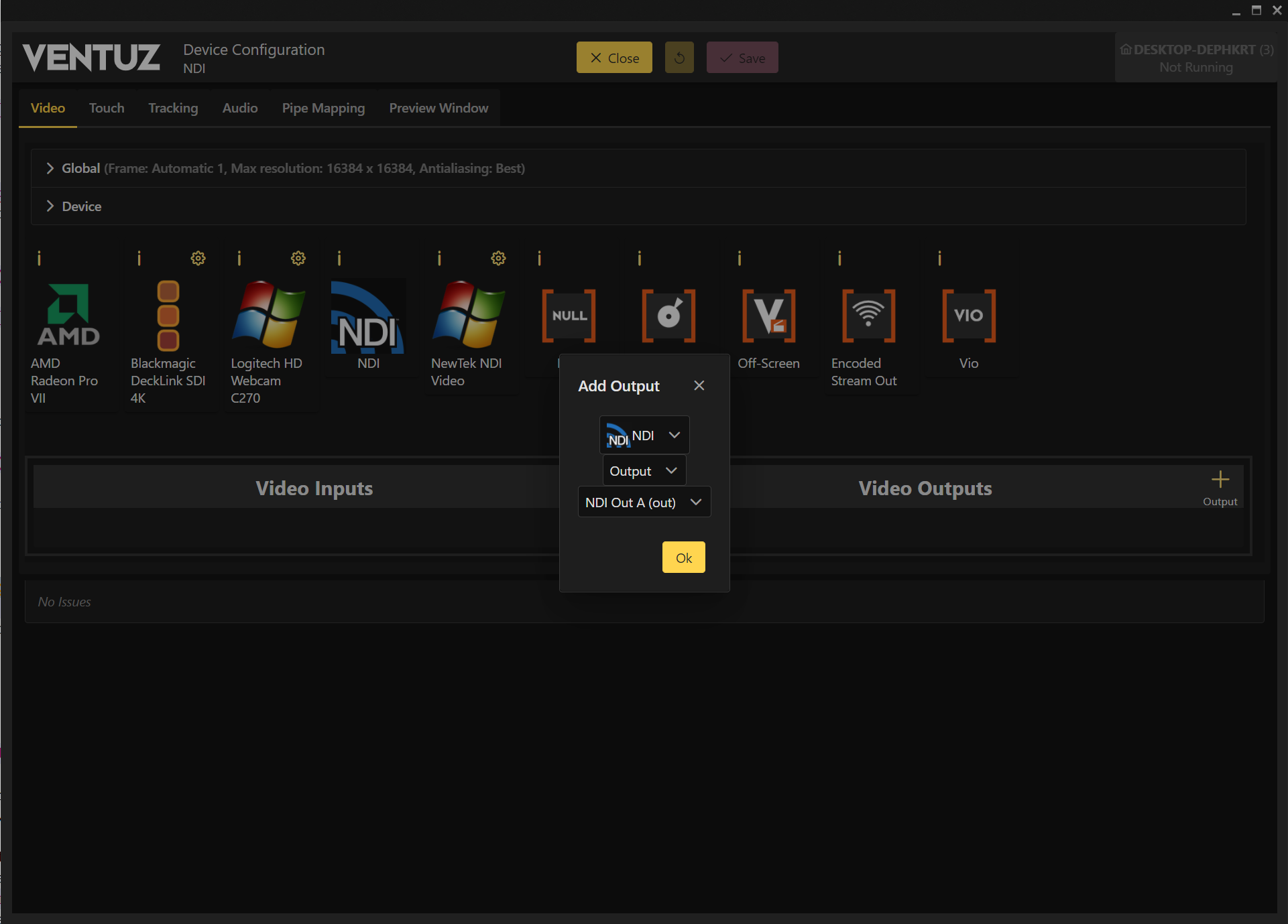

To setup a NDI Output, Drag&Drop  the NDI icon from the Devices top bar into the Outputs section.
A dialog box will pop up where you can set the output mode to output or external keying. You can also define the Port from Out A to Out D.
Depending on your licensed output options you can also configure multiple outputs.

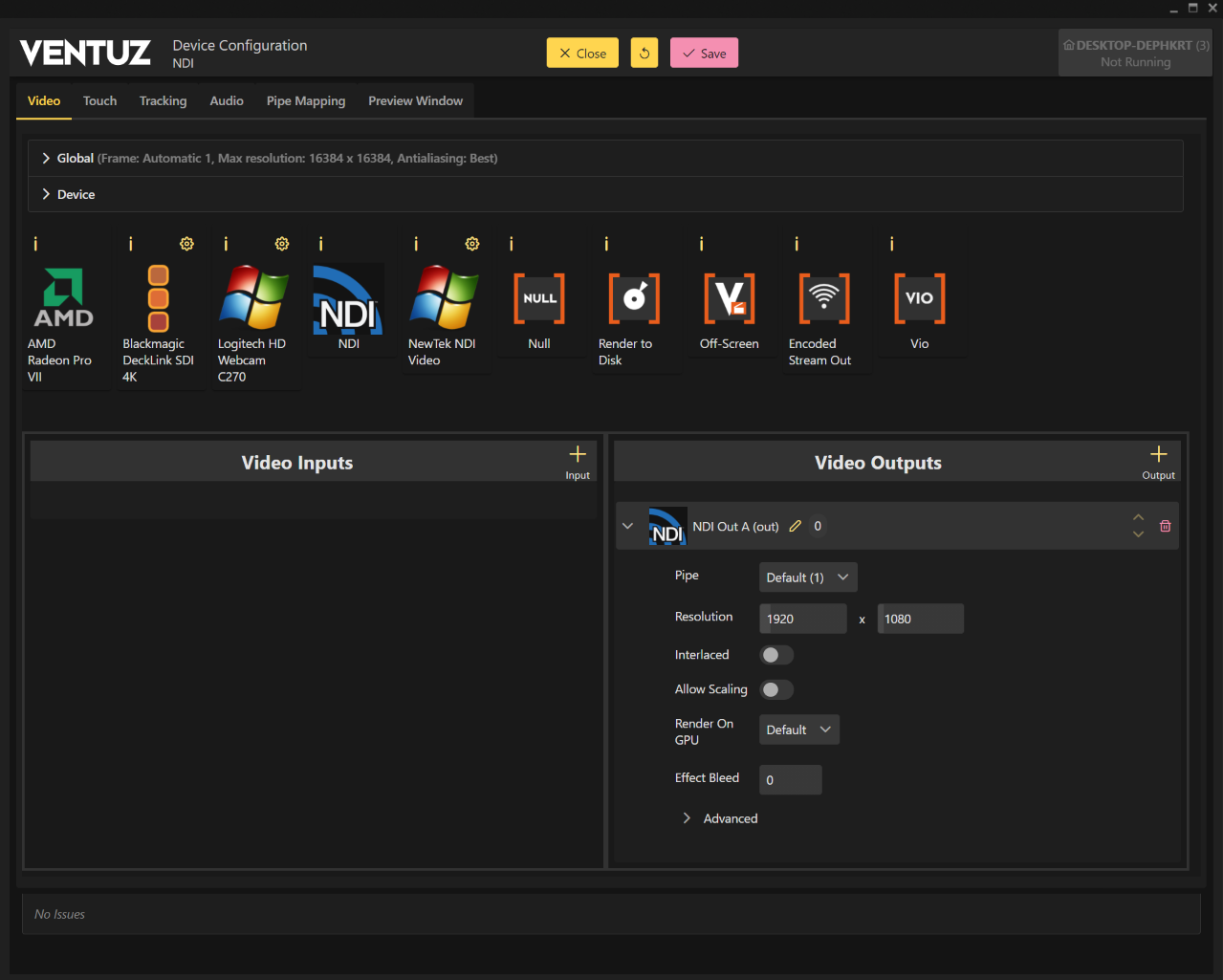

Output Properties
The Format Options shows you all of the output Formats supported by NDI out. For the rest of the output properties, please refer to the Video Options or Advanced Options.

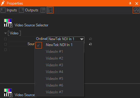

Video Source Selector Node
Video Source Selector This node allows for the selection of different available sources to activate them.
You can use the Video Source Selector node to select and/or switch between the different NDI inputs.  Click on the ordinal and select your NewTek NDI In here.

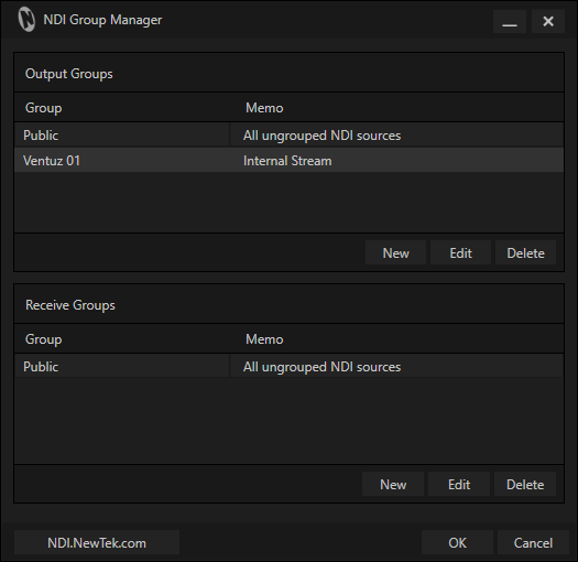

The NDI Group Manager organizes NDI sources into groups
You can determine if those sources are public or private. It is also possible to define the visibility of your streams based on a device or system.

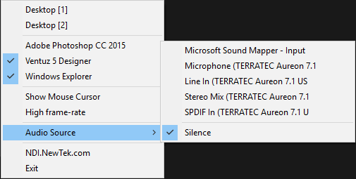

You can install this tool, for example, on a Laptop. Once installed you can set your presentation window as a source and stream it into your network.
click  on the NDI Scan Converter icon and select your Audio and/or Video source as well as to use the High frame-rate.

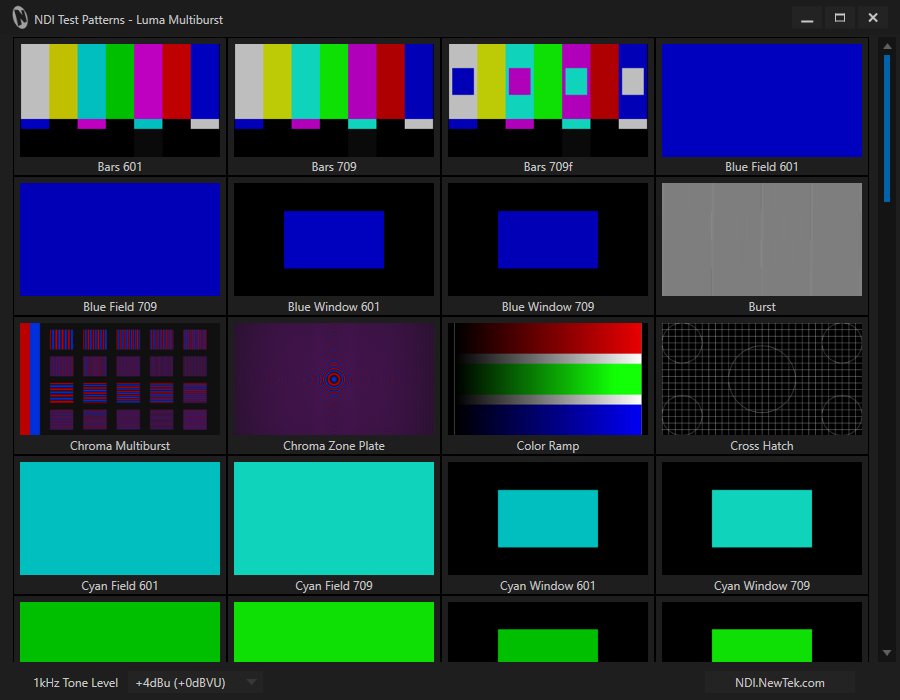

Test Patterns
Icon Description
This tool sends a reference Video and/or Audio
The tool tests your stream and network. It is useful to test and adjust the quality settings for your Scan Converter. You can chose from a wide variety of Testpatterns.
