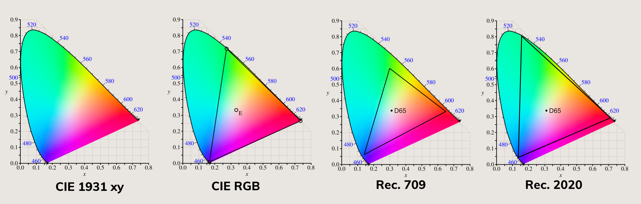

The human eye is able to see a wide range of colored ​light. In detail, light is defined as the visible part of the electro-magnetic spectrum in the range of ~380nm to ~780nm. This results in a wide range of perceivable color. This range defines the basic ​CIE-1931 color space.
The perceived color can be defined by three variables. For example with a red, green, and blue part or xyY, with the chromacity in xy and Y for luminosity. Via mathematical transformation, these color coordinates can be transformed to achieve other combinations.
A color space defines the range of the chromacity and luminosity. Starting with the chromacity, the computer graphic's color space is usually defined, by 3 primary colors. Red, green and blue. The triangle in-between these primaries are the supported colors. Colors outside the triangle and the color space, are called out of gamut. Each color space also defines a whitepoint for a reference white. In most cases D65.
Wider color spaces such as Rec.2020 are able to handle a broader range of chromaticity compared to standard Rec.709. The color space most commonly used for the last several decades.

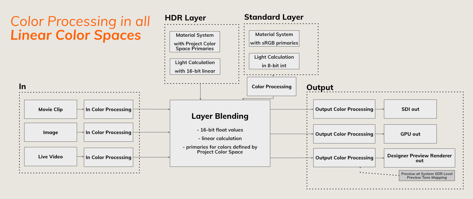

Color Processing Pipeline
With every type of input, 3D rendering, and multiple outputs, a sophisticated color processing pipeline is necessary to handle all the different input and output color spaces and blend them correctly.
All incoming video data, such as movies, live video or any texture, uses a color processing chain to be converted into the 16-bit linear color space, selected in the Project Color space. In an HDR Layer, light calculation is done with 16-bit precision with no fixed maximum brightness level. The Material System uses the Project Color Space primaries for its color settings. If a Standard Layer is used, the internal calculation is still done in 8-bit fixed integer values with the sRGB primaries, and then processed to the linear color space of the Layer Blending. (Note: The Standard Layer's color calculation looks very slightly different compared to the whole engine is in SDR mode.)

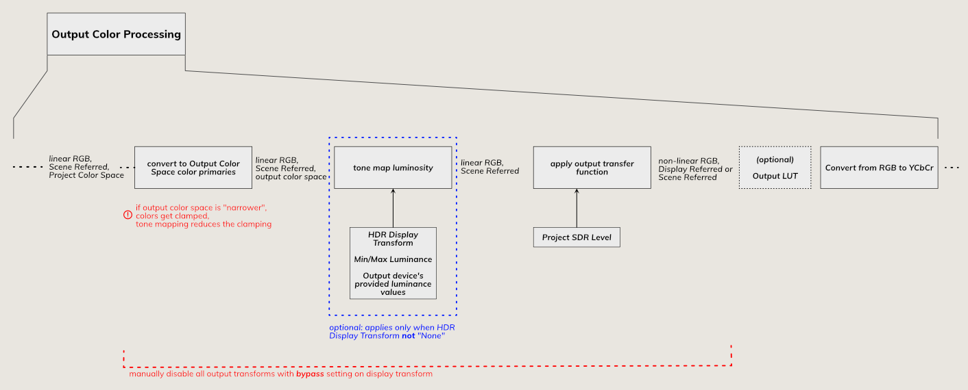

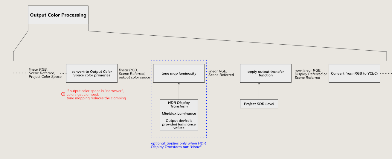

On the output side, for each output a specific color processing is done to ensure color space flexibility and accuracy.
All color processing is done via shaders in real-time, there is no pre-loading to convert into the memory. The shaders are build upon multiple mathematical-transforms and done on the GPU per frame.

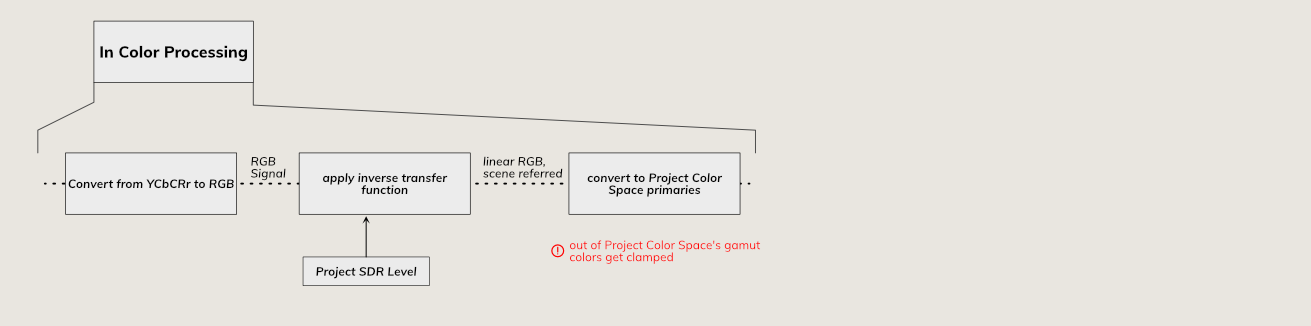

In detail:
  1. An incoming stream is transformed from YCbCR to RGB channels, with a channel matrix.
    • This is only necessary for non-RGB data.
  2. The non-linear signal is multiplied by the inverse transfer function of the input's color space.
    • Ventuz reads out the metadata, to automatically apply the correct functions.
    • If the input stream uses a display-referred color space, the Project SDR-Level is used to set the values for the reference white (1:1:1).
  3. The now linear data is converted to the Project Color Space values with a transform, including the input color space primaries and the Project Color Space primaries.
    • If the input is a wider color space compared to the Project Color Space, (Like Rec.2020 to Rec.709) possible out-of-gamut colors are clamped.
      • It is recommended to not use videos which are color graded in a wider range than the Project Color Space, except it is known that they do not exceed the range of the Project Color Space.
Practically, all this is done in one step, in real-time.
The output processing, basically inverts the process. First the linear RGB values are converted to the output color space. The output color space is set by the output device. Again, out-of-gamut colors will be clamped. The optional tone mapping can compress a higher dynamic range to the lower range of the output and prevents clamping. The tone mapping is applied for luminosity, but this also "shrinks" the wide colors in the process a bit. Different tone mapping functions are selectable.
Next, the output transfer function is applied. For display-referred out streams, like all GPU outputs, the Project's SDR Level is used to encode the data to the correct brightness values. If necessary, the color channels are converted to YCbCr. Again, this is done via a shader on the GPU, per frame, before it is displayed.

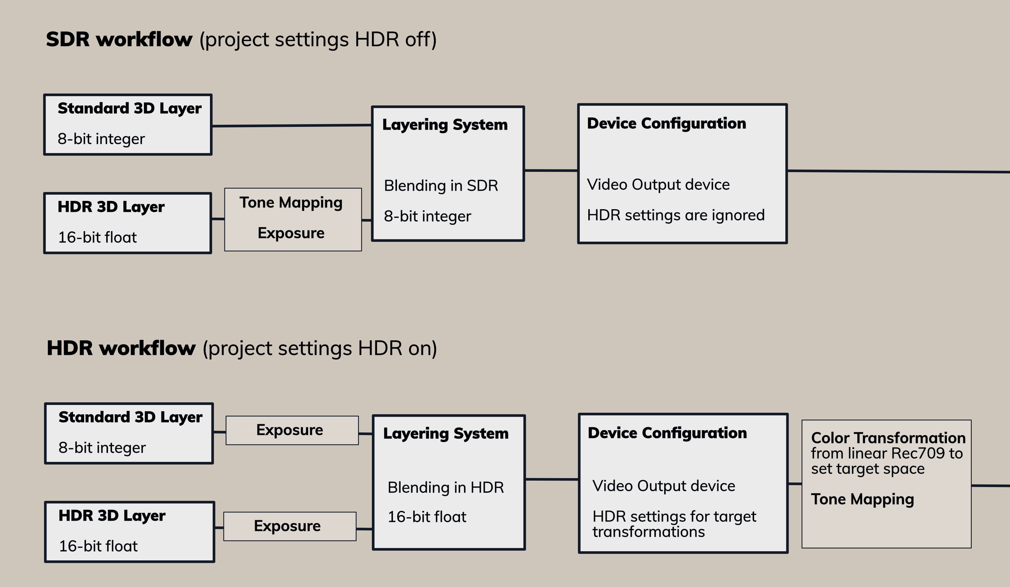

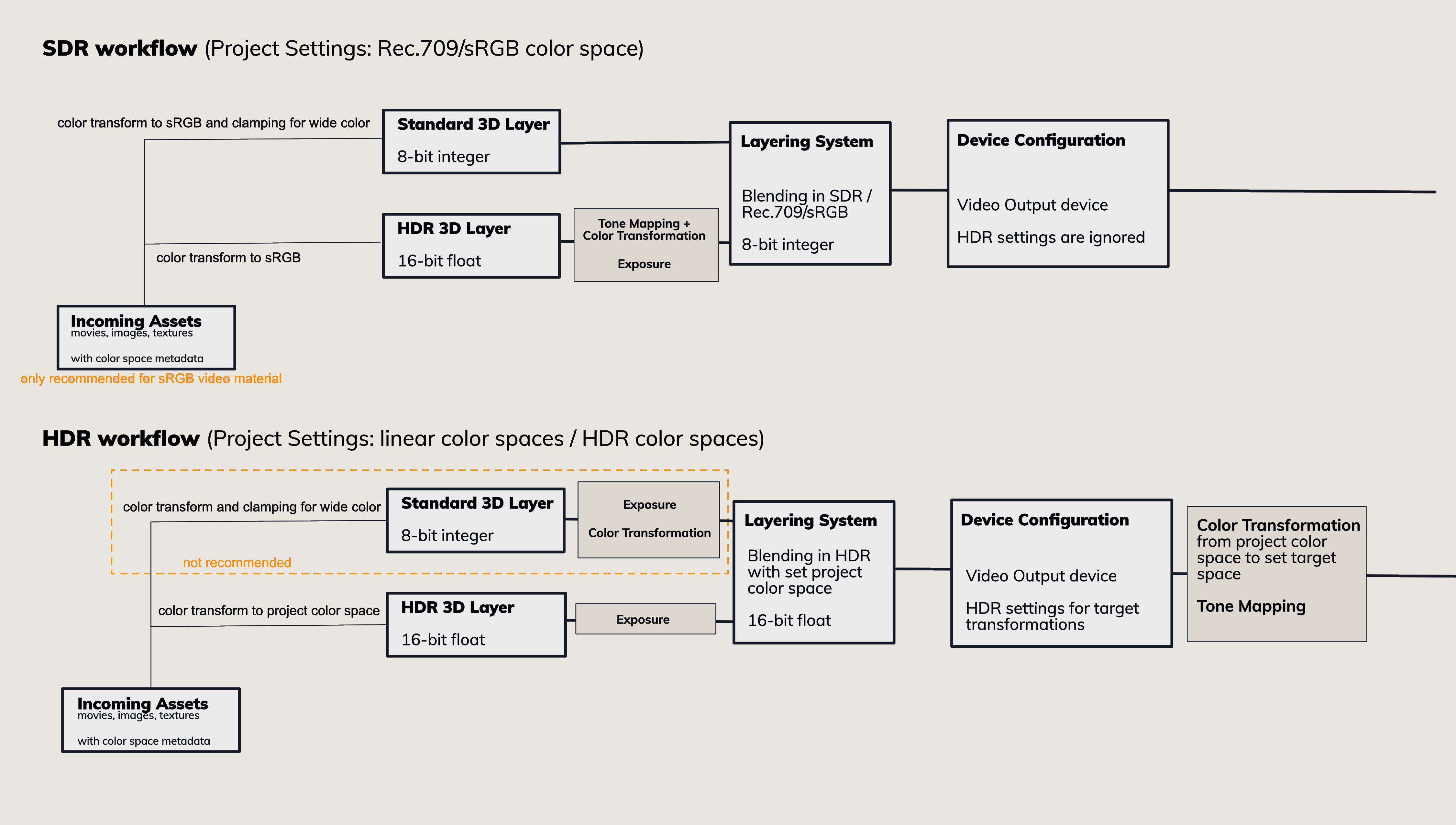

SDR workflow vs Wide Color Space / HDR workflow
The engine has two main modes for the color processing mode. The SDR mode, with the Project Color Space set to Rec.709/sRGB and the HDR workflow with all linear color spaces and wide color spaces.
The SDR mode is exactly the same as the pre Ventuz 8 rendering. The main Standard 3D Layer calculates in 8-bit integer values with Rec.709/sRGB primaries and are gamma-influenced and therefore, not linear. Also the Layer Blending is done in 8-bits per color channel.
The HDR-Layer calculates linear in 16-bit float, with the same primaries, but can be tone mapped via the Engine settings on the Layer's Root Node. For lighting via HRi maps and lighting effects like glare and bloom the HDR Layer is best to use, which is also true in SDR scenarios.
Also in the SDR workflow, all incoming assets, like movies, are color transformed as described for In Color Processing above.
A breaking change in Ventuz 8:
Prior to Ventuz 8, the video data was always interpreted as Rec.709.
Ventuz 8 reads video metadata and applies color processing as needed.
For the HDR workflow, everything is calculated in linear 16-bit float except the Standard 3D-Layer, which still uses 8-bit and then is transformed to the Project Color Space. The default settings for a Layer are set to High Dynamic Range for the Engine property.

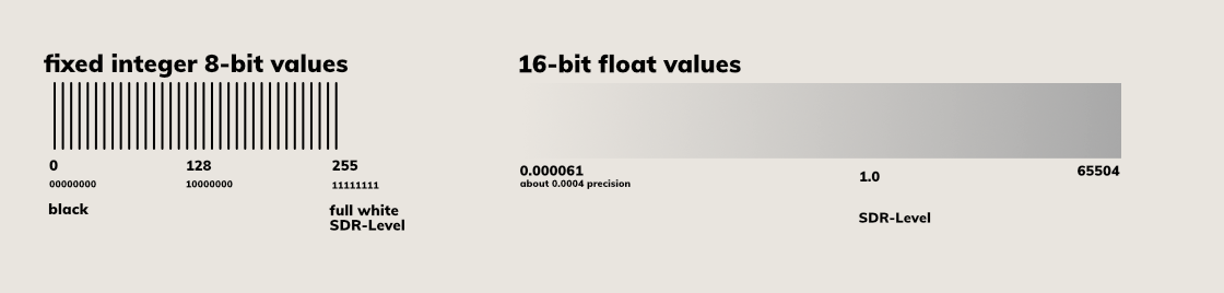

Calculating in linear colorspaces changes the engine to use 16-bit values and uses transforms in the render chain for color conversion. This has an impact on performance. Using 16-bit instead of 8-bit doubles the memory and bandwidth in use when working with textures. When using Post-Processing effects that need the frame to be stored in memory to use it the next frame(s), like feedback or delay, this should be taken into consideration.
In general incoming textures are saved are stored / held in memory in the original color format and converted via a shader when rendered and played out. With this approach, Ventuz can automatically determine the minimum processing for conversion. (So a sRGB 8bit texture is converted only when rendered to 16bit) This is done per rendered pixel, and not dependent on the whole texture. For the main conversion of sRGB to linear, GPUs have a fast processing chain which is used by Ventuz. Since modern GPUs have a decent amount of memory, bandwidth, and processing power, the performance impact will only be noticable for extensive use and/or (very) high resolutions.

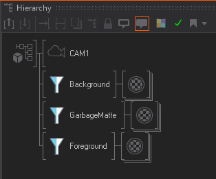

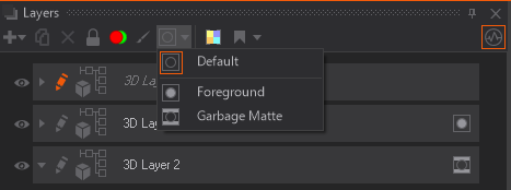

Each layer can be assigned to one of the 3 ranks. Also inside of a 3D layer, parts of the hierarchy can be filtered to be in one of the 3 ranks. The ranks are rendered independently.
Setting rank in a layer Setting rank with filters in a 3D hierarchy
In Internal Software Chroma Keying, Ventuz adds a chroma keyer to the video input. Then the garbage matte is used to cut away parts of the input that might not be covered by green screen. In a trackless environment a masking image will suffice, in a tracked studio a 3D Scene containing simple virtual boxes around where the physical green screen is can be used to mask out the borders of the green screen while the camera moves.
The four signals, input, garbage matte, background, and foreground are composited properly to form the final image.
