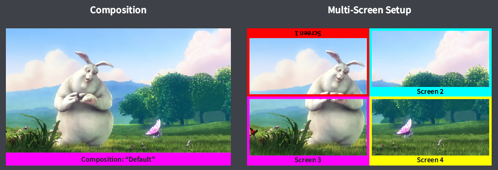

Screen
Once a Scene is created, the Ventuz Configuration Editor presents many options to display one or many Scenes.
Screens give the operator the ability to map a scene to one or many unique displays such as LED screens, projectors and flat panels. Each one of these displays can have different sizes, resolutions, orientations, bezels and overlaps. Using Screens, a whole Composition can be mapped, sliced, or cut to display a whole scene as one large beautiful image across unique displays.
Screens can be created and adjusted inside of the Render Setup area of the Ventuz Configuration Editor. Resolutions, pixel density, physical screen size and orientation can all be adjusted for each screen to take the gaps or overlaps that exist between each display.
Screens are used to show a whole Composition, slices of Compositions, or both.

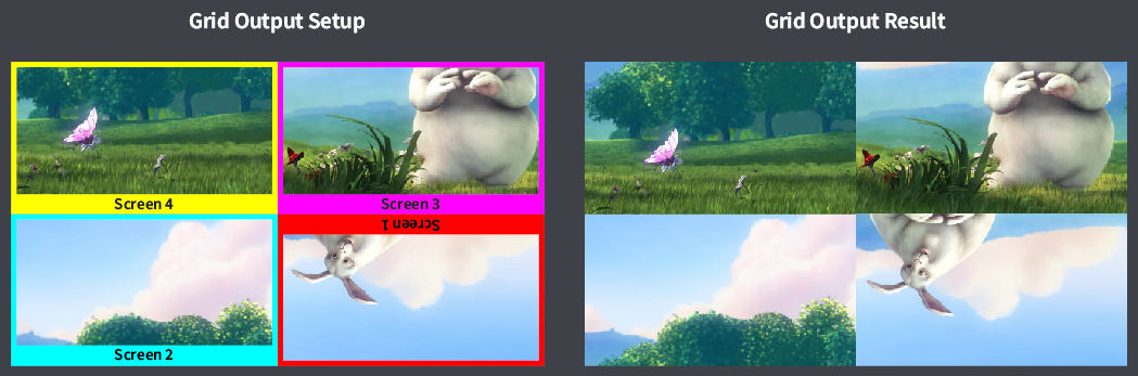

Output
Outputs represent the physical output of a computer running Ventuz Runtime. Each Output can accept one or many Screens.
Screens can be assigned to Outputs; There, they can be adjusted, rotated and scaled. This way, the slices of the Composition using the Screens (from above), can be assigned to a physical output of a Ventuz Runtime to give its signal to a physical display such as a projector or LED wall.

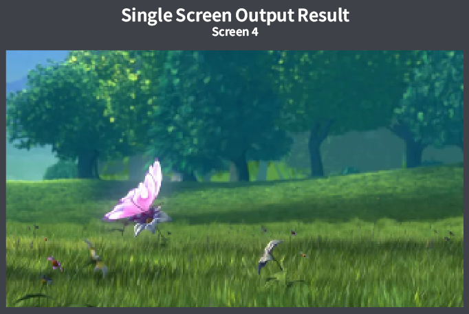

It is also possible to output one Screen to one physical output. This screen can either be scaled to an entire Composition or a slice of a Composition, like shown here.

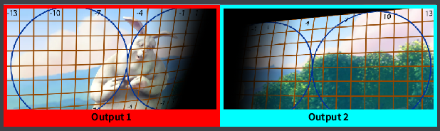

Shaping, Warping and Blending
When a setup has overlapping or converged projectors, the Shaping engine is the way to perfectly align all projectors in a setup.
Pixel accurate warping, customizable blending and per-output gain, lift and quality adjustments can be made in the Ventuz shaping and warping engine.
