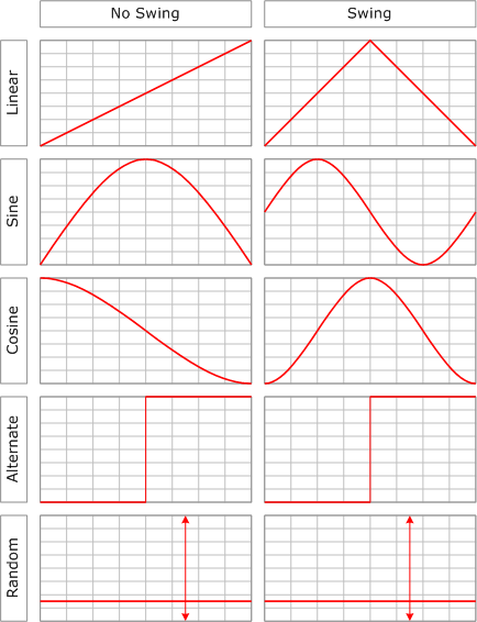

Function defines the mathematical function used by the Mover to calculate the values in one period. The duration of a single period is defined by the Duration property. The Sine and Cosine functions result in smooth ease-in and ease-out animations. The Linear function produces constant animations, whereas the Alternator mode switches between Min and Max values. The Random function produces random values within the specified range - one new value in each period. Infinite will run indefinitely from 0 on in a linear manner. Each period the result will increase by the given range.
Enabling Swing will produce a continuous and smooth curve. With the functions Alternate, Random and Infinite the Swing property has no effect.
