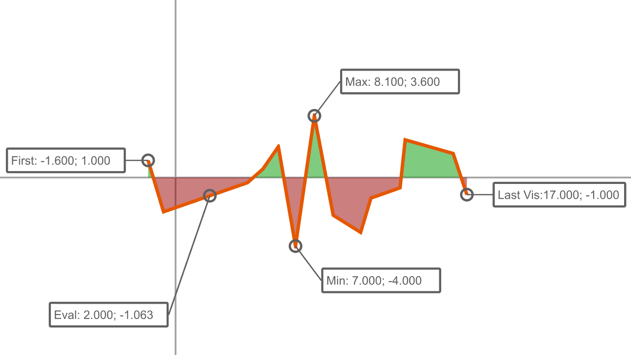

Both Chart nodes have a few output properties that provide some characteristics of the input array and the resulting geometry. The LastValue properties provide the last visible value pair based on the original input values. The LastPos provide the last visible value pair in the local 3D space of the chart geometry. These value are affected by the Size properties. The MinPos properties provide the position of the smallest Y value in the local 3D space of the chart geometry. MaxPos does the same for the largest Y value. The VisibilityXMarker output array provides values which indicate if a key value from the Values input array is visible. 1 means that the according key is visible. 0 indicates that the key is not visible. A value >0 & <1 means that the VisibilityX lies between two key values.
Output Description
VisibilityXMarker array providing values which indicate if a key value from the Values input array is visible: 1 means that the according key is visible; 0 indicates that the key is not visible; a value >0 & <1 means that the VisibilityX lies between two key values.
EvaluationValueX the X value for evaluation of the corresponding Y value (y = f(x))
EvaluationValueY the Y value for the corresponding X value
EvaluationPosX the corresponding X value for the evaluation in the local 3D space of the chart geometry
EvaluationPosY the corresponding Y value for the evaluation in the local 3D space of the chart geometry
FirstValueX the X value of the first key point
FirstValueY the Y value of the first key point
FirstPosX the corresponding X value of the first key point in the local 3D space of the chart geometry
FirstPosY the corresponding Y value of the first key point in the local 3D space of the chart geometry
LastVisibleValueX the X value of the last visible point depending on the VisibilityX property
LastVisibleValueY the Y value of the last visible point depending on the VisibilityX property
LastVisiblePosX the corresponding X value of the last visible point depending on the VisibilityX property in the local 3D space of the chart geometry
LastVisiblePosY the corresponding Y value of the last visible point depending on the VisibilityX property in the local 3D space of the chart geometry
LastValueX the X value of the last key point
LastValueY the Y value of the last key point
LastPosX the corresponding X value of the last key point in the local 3D space of the chart geometry
LastPosY the corresponding Y value of the last key point in the local 3D space of the chart geometry
MinValueX the X value of the key point with smallest Y value
MinValueY the Y value of the key point with smallest Y value
MinPosX the corresponding X value of the key point with smallest Y value in the local 3D space of the chart geometry
MinPosY the corresponding Y value of the key point with smallest Y value in the local 3D space of the chart geometry
MaxValueX the X value of the key point with largest Y value
MaxValueY the Y value of the key point with largest Y value
MaxPosX the corresponding X value of the key point with largest Y value in the local 3D space of the chart geometry
MaxPosY the corresponding Y value of the key point with largest Y value in the local 3D space of the chart geometry
