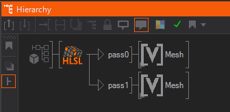

Passes
A shader node has a number of outputs that corresponds to the maximum of the number of passes over all techniques in the shader. Each output is labeled with the name of the pass as used in the shader source code for easy identification. If the number of passes changes due to modifications of the shader source code, the number of outputs is adapted as well. Note however that an output will not be removed if there are nodes attached to it.
If multiple passes are required to render the same geometry, the respective nodes should be linked to both outputs (using CTRL + SHIFT while dragging, see Hierarchy Editor). This avoids creating two copies of all the nodes in the subtree, but there is still a memory overhead compared to using the content only on one output.
