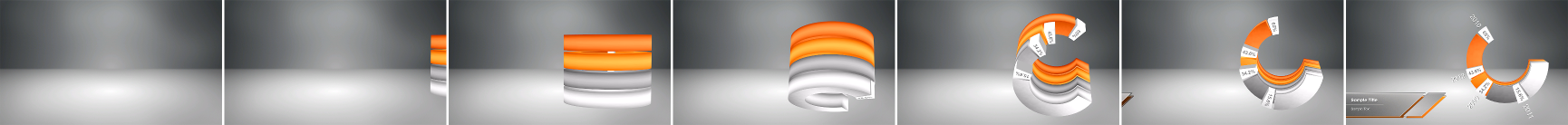

The primary action after cueing a template is to Take it. This confirms that the operator has finished doing all required modifications and/or that the time has come to bring the cued content on air. To take a cued content, press F1. The Ventuz Template Engine will calculate the best animation from the old to the new content and performs it. Depending on how the templates have been designed, this can either mean the old template moves out before the new template comes in or some specialized transition. Regardless of the animation, the cue becomes empty, ready for the next template.
Some templates have multiple points along their animation that can be interesting to the audience. Such templates are called multi-takes and the number of takes required is shown in the Show Control (see below). When it's time for the next step in the in-animation, just press Take again.
