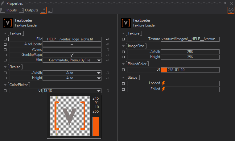

The ASync Boolean enables asynchronous loading so that the renderer is not stalled when the Node needs to load a texture. This is especially useful when you want to change the File Path during Runtime.
If UseOrientation is enabled the texture is rotated accordingly to EXIF metadata in the image file.
In addition this node can resize images/textures on load and create Mipmaps. The GenMipMaps property enables this feature.
Please note that the GenMipMaps property only affects loading of standard image types, like PNG and JPG. It will not be taken into account when loading image types like DDS and VZT. DDS and VZT images already contain mipmaps, and these mipmaps are used as provided, ignoring the settings in the Texture Loader node.

Color Picker
One or more ColorPicker items can be added to the TextureLoader via the Custom Model. Adding a ColorPicker item adds a new input property to specify x and y position of the color to be picked on the texture. A new output property provides the color of the selected pixel.
Note that the texture in the picker is scaled down to 128x128 pixels.

On the output side the node provides the resulting Texture and its Width & Height.
