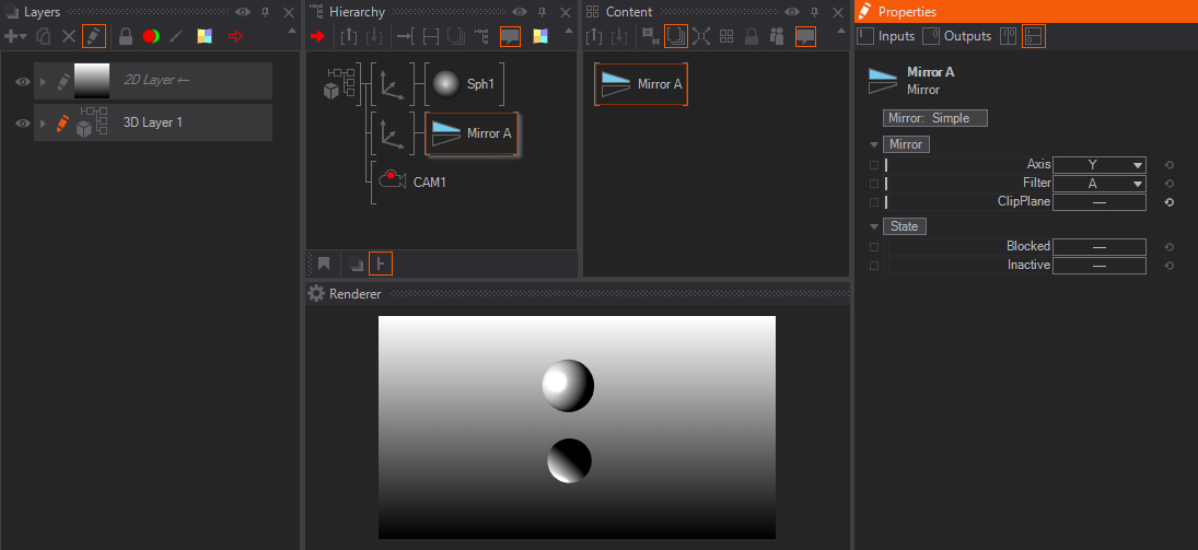

To use this type of mirror, add the Simple Mirror node to the scene and you will have a flat surface which has a simple reflection applied to it. Keep in mind that the Mirror plane is endless and can not be scaled, just rotated. The part of the surface which contains no reflection is fully transparent - therefore the created Mirror Surface can be used against a different Background or even a Layer. You can not change the color or other parameters of the reflection. The following image shows a very basic setup for a Simple Mirror.

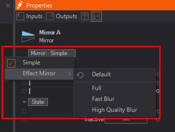

To use the effect mirror you can simply switch the property from Mirror: Simple to Mirror: Effect or drag&drop  the Mirror Effect node from the Toolbox into the Hierarchy Editor - a warning will appear and remind you to place a flat geometry behind it.

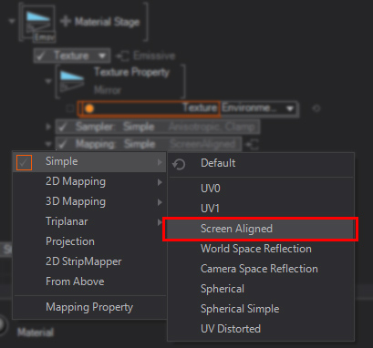

To use the generated mirror texture output you would need to apply the texture by using e.g. a Material node, select an emissive or specular texture input and set the Mapping to Simple - ScreenAligned
This way it is possible to have full control over the generated texture and you can make use of it as a real Material Stage. You can now assign a completely different Target for this stage, use a different blend mode or send it into a mask-channel.

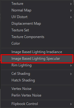

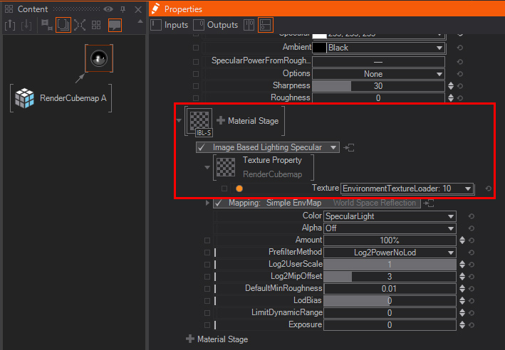

The RenderCubeMap has also an Texture Output available. Since this is a "six sided version" of a "reflection", a cross texture, you can not simply bind it to a screen aligned mapped texture slot - it uses completely different shader code. In this case you would need to add a Material node and add an IBL Specular Reflection material stage.
Now you can bind the Texture Property Output from the RenderCubeMap to the Texture Property from the IBL stage.

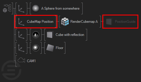

Whenever you plan to use the Cube Map Texture Property Output only, you do not need to have geometry sorted directly behind the Cube Map node. This gives you more freedom to bind the reflection where- and whenever you want. For an easier workflow you can still put a cube behind the RenderCubeMap Node to help you identify where the Cube Map reflection is rendered, i.d. the source/origin position of the reflection. Just add an Axis in front of the RenderCubeMap Node and reposition the "node" or better source position. As soon as you found the desired position you can block the geometry to hide your guide.
