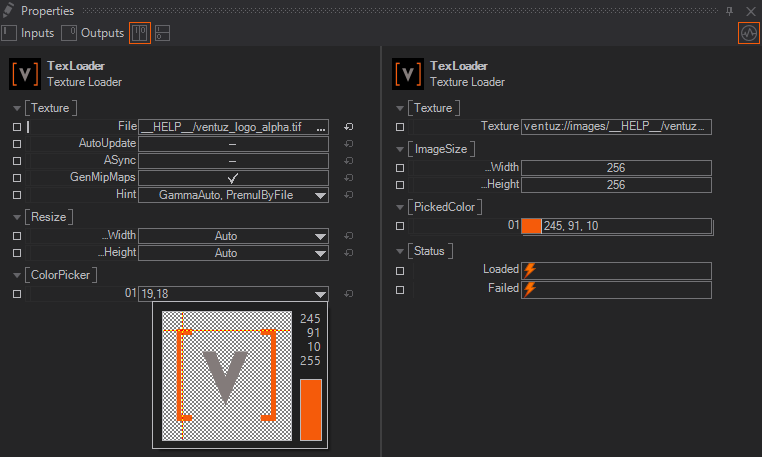

One or more ColorPicker items can be added to the TextureLoader via the Custom Model. Adding a ColorPicker item adds a new input property to specifiy x and y position of the color to be picked on the texture. A new output property provides the color of the selected pixel.
Note that the texture in the picker is scaled down to 128x128 pixels.
