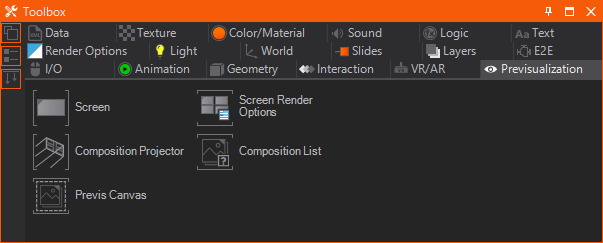

To begin using a SimpleScreen for previsualization purposes:

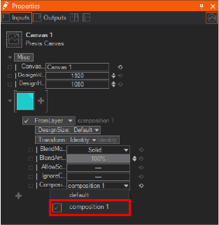

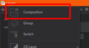

To show Content coming from a Composition Layer on the previsualization screen, a 3D Layer is needed.
The Composition for the newly assigned Composition from Layer property needs to be defined.
This will show the content of the Composition Layer created in the previous step on the previs screen.

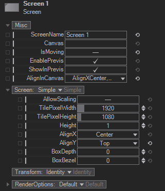

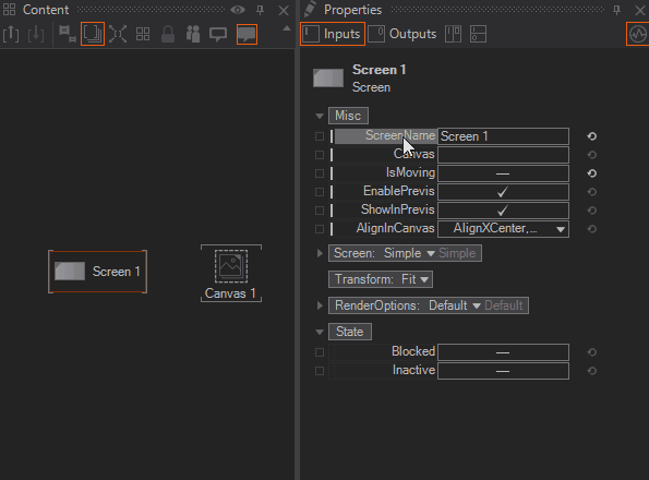

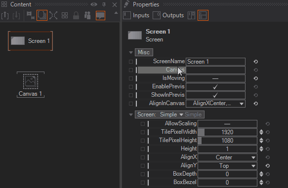

To create the Screen, which will provide and show content in our previs scene:

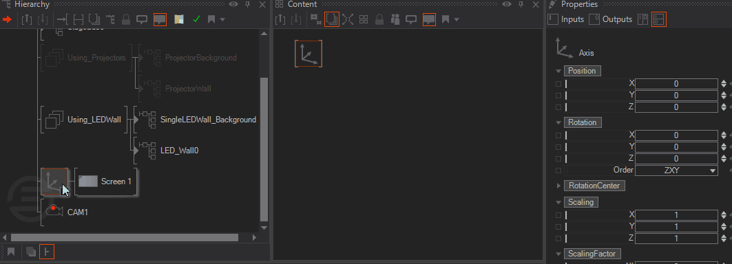

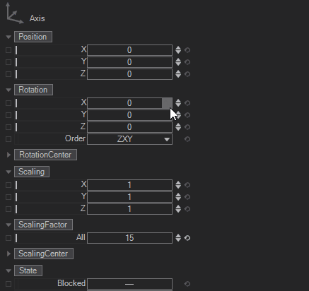

We want to match the LED Wall model in our previs layer. With the exposed X/Y/Z Position Values, they can can be used for the Screen node's Axis already.
As you can see, the Screen position now matches our geometry except the scale and the alignment.

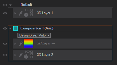

To show your generated content on this Screen:
You can now create and use any kind of Layer inside the Composition Layer. We will create a simple 3D Layer and show a rotating Ventuz default cube / mesh. You could also use a Movie Layer and show a full size Movie on the Previs Screen.

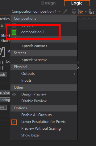

To show the Composition Layer content, use the Preview Selection Menu to select what is to be shown in the Renderer Window.
Select composition 1 from the Preview Selection Menu drop down list:
Now content of the Composition Layer is shown - the small Ventuz Cube mesh.
We also want to have the mesh animated or rotating. Using the build in feature Animate Floating Point numbers.
Switch back to the Composition default with the Preview Selection Menu.

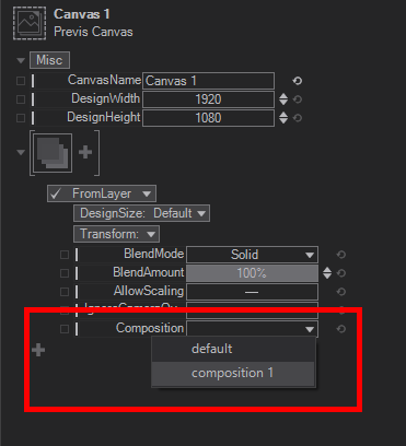

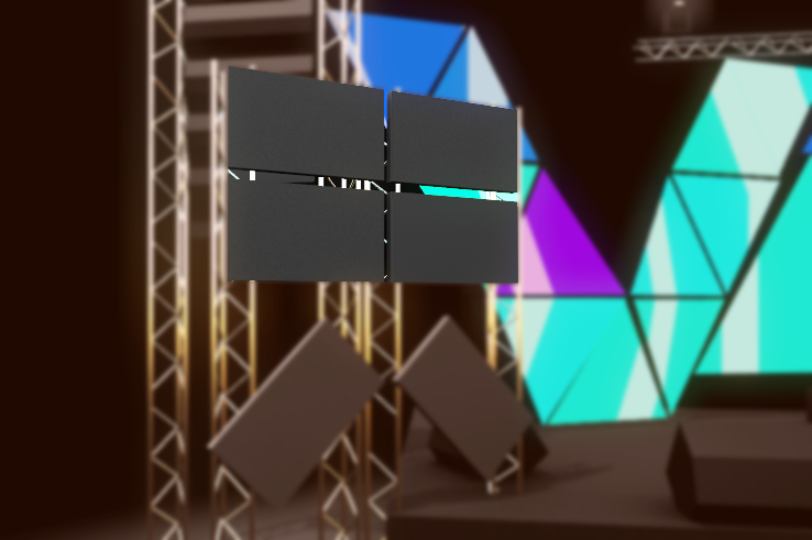

This example will use Screen Tiles and a spinning Ventuz default Cube displayed on four 16:9 1920x1080 screens of the same size with a Bezel.
To have the correct placement and Bezels of the tiles, the physical dimensions of the screens and their bezels are needed.
If you followed up the Simple Bezel example from above, many of the steps are the same but involve additional steps to correctly place the Screen used for the previsualization.

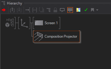

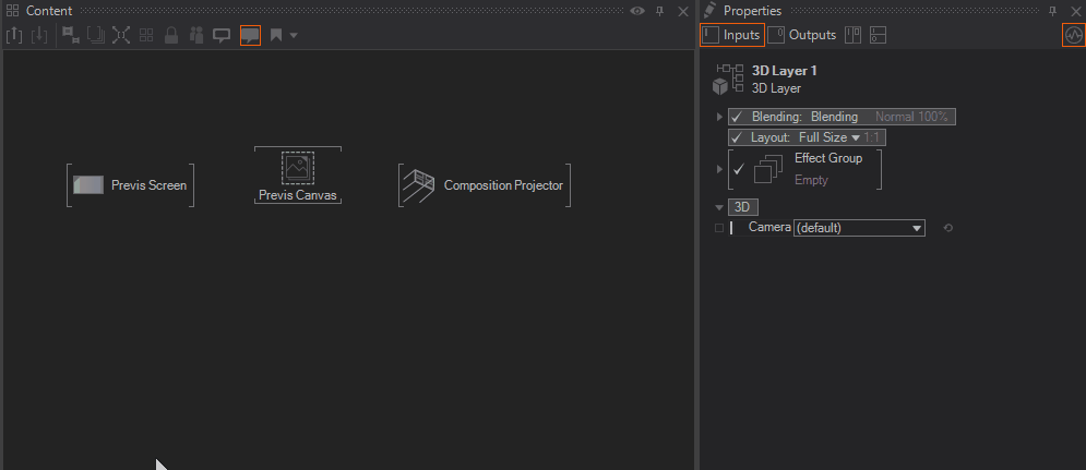

To begin using a Composition Projector for previsualization purposes:
This sets the "Source" of the Composition Projector to the selected Composition.
Now this Projector is projecting this Composition Layer to any Screen that is connected and configured to receive it.
An Axis Node can be placed in front of the Composition Projector to place its projection where it's needed in the Scene.

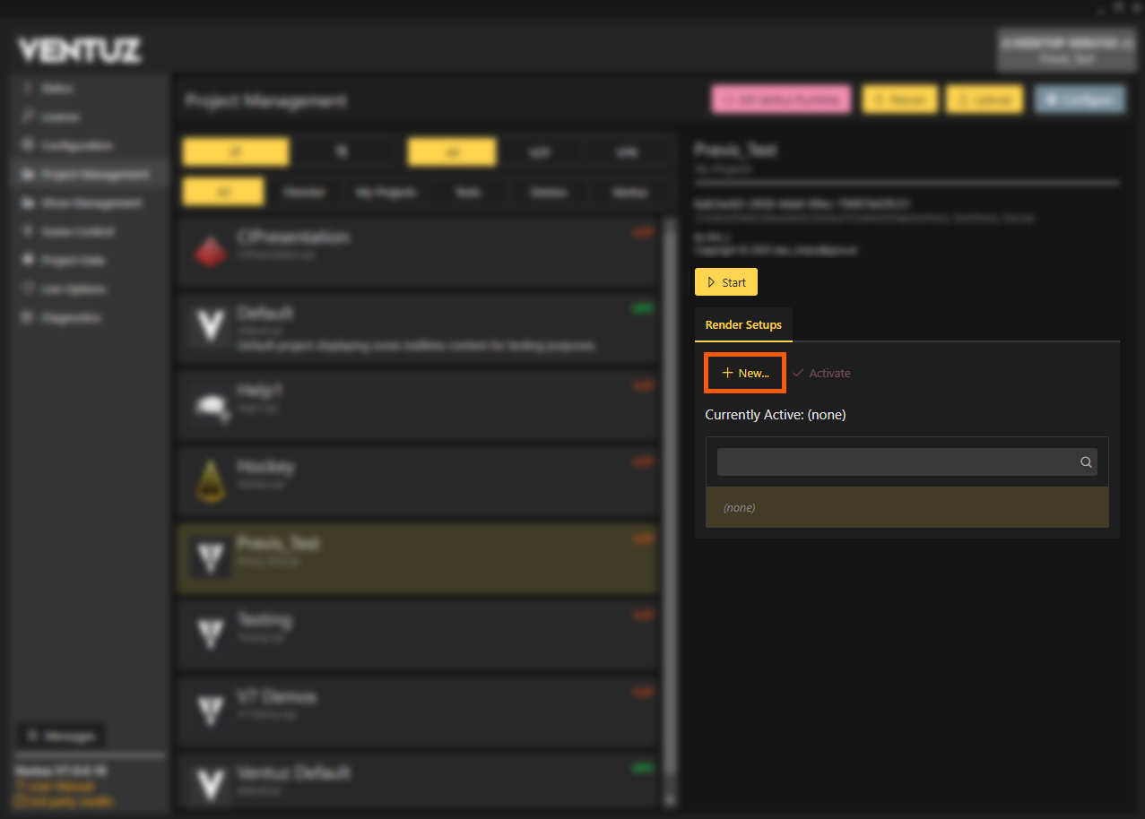

2. click the dropdown menu that shows None and click Manage render setups.
While in the Project management tab, see on the right hand side the Render Setup related part. Here you can activate and select existing render setups, or create new one.
Render Setup Editor will automatically open with the new Render Setup file loaded and ready to be edited.

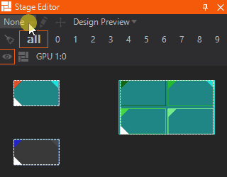

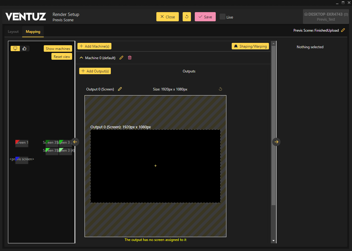

On the left panel of the Render Setup window, there are multiple screens from the created and configured previs Scene.
Screen 1 (red corner) is the Simple Screen, a single FHD screen.
Screen 3 is the Bezel Screen and is visualized by multiple tiles (4 tiles all named screen 3 - green corner) and the <previs screen> (blue corner).
In Ventuz 7, the <previs screen> can also be viewed in Ventuz Designer can be assigned or mapped to a physical output, this is why it is shown here.

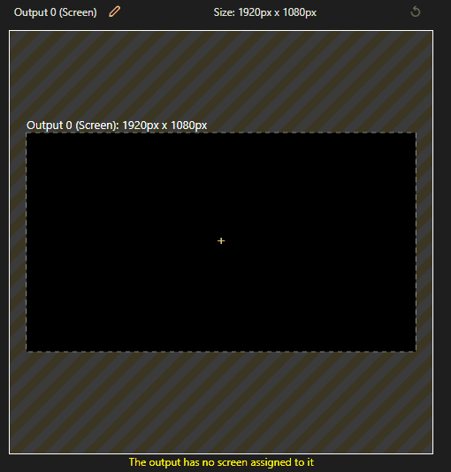

By default, no screen is mapped to any output (middle pane of the setup editor) though an output was added and exists by default: Output 0 (Screen).
To map the Screen 1 to an output:
When the output has a screen assigned to it, the yellow warning below the output "The output has no screen assigned to it", will disappear.

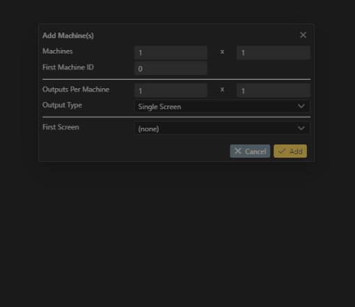

In these steps, the Bezel Screen, consisting of 4 tiles, will be mapped to 4 individual outputs on the same machine.
The Bezel Real World example that contains a 2x2 grid of displays Scene will be used for this example.
The popup screen can be used to automatically define how the output mapping for the Bezel Screen will be setup.
Each of the new outputs inside of this new machine has the corresponding screen assigned to it.
