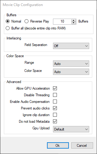

Configuration
The configure button at the bottom of the property editor brings up the movie clip configuration dialog.
Buffers
Here the way video frames are buffered is configured:
  • Normal buffering is sufficient for normal playback and point looping. The number of buffers used can be adjusted. More buffers means more memory usage but improved reliability, especially with poorly encoded streams. Using the Loop feature will double the amount of buffers needed.
  • Reverse Play will do additional buffering to allow backward playback with the Scrub property. The number of buffers and the amount of memory used will be tripled!
  • Buffer All will decode the entire clip into memory, allowing to seek immediately to any frame, at a high memory cost.
Audio is only available in Normal mode.
In some situations, the node may need to allocate more buffers than specified in the configuration. The amount of memory used for video and audio buffering can be monitored with the MemoryMB output property.

Disable Threading
For most codecs, each MovieClip node will create as many threads as there are cores available. It may be counterproductive if more clips are played at the same time since the threads will get in each other's way. Also, they may steal time from the Ventuz main thread, which will cause stutter.
  • Playing many clips: enable the flag
  • Playing one large clip and multiple small ones: it is the best to disable threading for the small ones and keep threading enabled for the large clip.
Enable Audio Compensation
Often the audio hardware is not perfectly in sync with the video hardware. In such cases, the audio must be slowed down or speeded up to compensate the tempo of long video clips. This is called Audio Compensation and is explained in detail at the Sound Nodes.

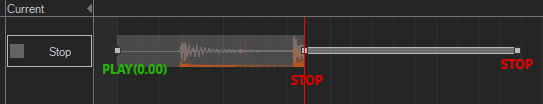

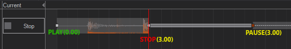

The behaviour of the Stop Keyframe requires some more explanation.
In Sample 1 we see the keyframes, the first one is Play and the two following ones are Stop keyframes. In this case the movie will start playing until the first Stop keyframe is reached and stay at that frame.
Sample 2 behaves a little different, in this case the movie starts playing, but when it hits the Stop keyframe it will seek to the position of the Pause keyframe to it's right. It would show the same behavior at the Stop keyframe if the right one would be a Play instead of a Pause.
Sample 1
Sample 2
So we can make a general statement. The Stop keyframe first of all looks to the right to see if there is keyframe with time he needs to prepare for, if this is not the case, he looks to the left and takes over the current playback time.

Configuration
The way video frames are buffered is configured:
  • Normal buffering is sufficient for normal playback and four point looping. The number of buffers used can be adjusted. More buffers means more memory usage but improved reliability, especially with badly encoded streams. Using the Loop feature will double the amount of buffers needed.
