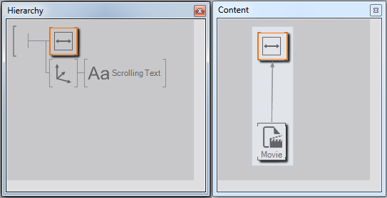

The first step is to build the scene itself, that will represent the template for the Director. For this template we only need a Viewport node with a Movie Clip Loader as a texture and a 2D Text node with a Scroll Text node as text provider. Instead of the Scroll Text you may use any kind of content - for example an RSS Ticker may be interesting.

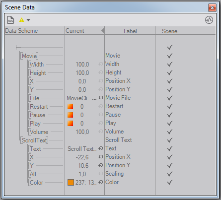

Now that you have the actual appearance of the Template ready to use, you must provide some modifiable Data to the operator of the Director. To do so you have to drag and drop
the wanted properties into the Scene Data Editor (you may open it by clicking on "View" -> "Scene Data Editor" in the main menu bar).
Drop every property that you want to be modifiable into any of the columns but the leftmost one. Consider the Size and Position properties of both the background and the text. Also you may add a Color node to the text and bind its Color property.
You will now have a list of unsorted properties often with meaningless names. To sort them you may click long
on the root symbol
and then choose "Create Sub Folder". Then drag
the Data behind that new Sub Folder. If necessary you can create a folder inside another folder as well.
Next you may want to label the Data in a way, that the operator later recognizes the properties. Double click
on the Label property in the Scene Data Editor to rename a Label.
