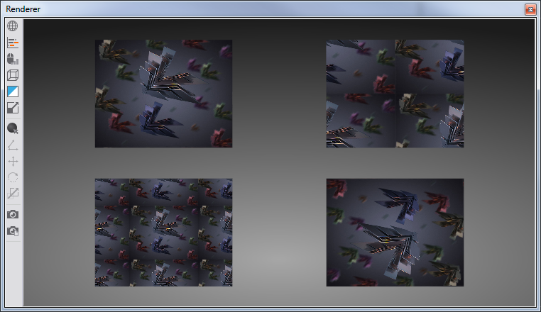

The properties AlignX and AlignY define the center for texture scaling and rotation. Via PositionX and PositionY the texture on a geometry can be moved along the X and Y axis. The property RotationZ rotates the texture on the Z axis. ScalingX and ScalingY scale the texture along the corresponding axes. ScalingFactorAll is a factor which is additionally multiplied on ScalingX and ScalingY to get the resulting scaling.

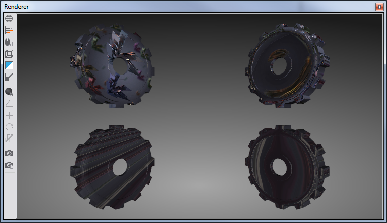

If the property MappingProjected is enabled, the texture coordinates of the geometry are transformed to achieve a an effect as is the texture was projected on the geometry from a certain point in 3D space. The property MappingType specifies how texture coordinates in a geometry vertex should be transformed:
| SphereMap | The original texture coordinates within the vertex are used for sphere mapping. |
| CameraSpaceReflectionVector | The reflection vectors, transformed to camera space, are used as texture coordinates. A reflection vector is computed from the vertex position and normal vector. |
| CameraSpacePosition | The vertex positions, transformed to camera space, are used as texture coordinates. |
| CameraSpaceNormal | The vertex normals, transformed to camera space, are used as texture coordinates. |
| PassThru | The original texture coordinates within the vertex are used. |

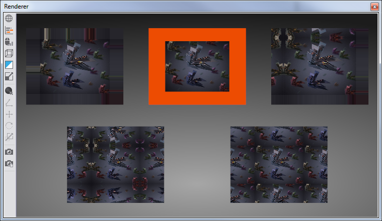

The MappingU/V/W properties define how the texture content is addressed. Following modes are possible:
| Clamp | Texture coordinates outside the range [0.0, 1.0] are set to the texture color at 0.0 or 1.0, respectively. |
| Border | Texture coordinates outside the range [0.0, 1.0] are set to the border color. |
| MirrorOnce | Similar to Mirror and Clamp. Takes the absolute value of the texture coordinate (thus, mirroring around 0), and then clamps to the maximum value. |
| Mirror | Similar to Wrap, except that the texture is flipped at every integer junction. |
| Wrap | Tiles the texture at every integer junction. This causes the texture to be repeated on the object if needed; no mirroring is performed. |
The BorderAlpha and BorderColor properties define the alpha and color value of a texture border if an appropriate MappingU/V/W mode is selected. The Base property in the Matrix category allows to manipulate the position, scaling and rotation of the texture via matrix in addition to the manipulation via properties. The Order property defines how this matrix is multiplied with base transformation matrix. In case of Override the manipulation via properties is discarded and only the matrix has an effect on the texture mapping.
