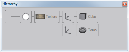

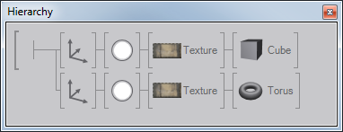

The following basic examples show two different possibilities to build scene trees in the Hierarchy Editor which result in exactly the same rendering output, but are different in terms of performance.
The first hierarchy applies a separate Color and Texture node to each geometry. But this is not beneficial because both Color and Texture are the same for the geometries. The better way to build such a scene is shown below.

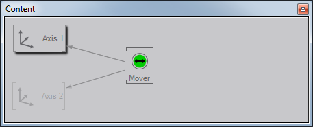

The same principle applies to Content nodes which provide values or resources to Hierarchy nodes. If an Axis node receives values from a Mover and the Axis is copied normally, the Mover will be copied as well. But if the parameters of the second Mover remain the same, it is dispensable because the second Axis could receive its values from the first mover:
In such cases do not use the regular copy [CTRL+C, CTRL+V] but the so called reference copy, as described in section Moving and Copying, to decrease the time it takes to build the hierarchy. This will save memory and speed up validation time.

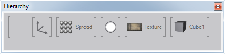

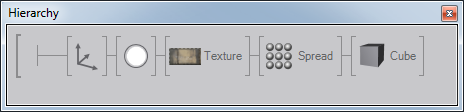

To avoid unnecessary duplication of nodes, the subtree should be reduced as far as possible. The following screen-shots show a bad and a correct use of the Spread node.
In the first version not only the Cube is duplicated but also the Color and Texture node. This is unnecessary because the Spread node does not affect the Color and Texture node. All duplicated copies remain the same. This way every copy of the Cube node creates two unnecessary nodes which only consume memory and reduce the scene performance. The correct use of the Spread is shown below. Only the Cube is duplicated because Color and Texture are applied to any copy of the Cube anyway.
