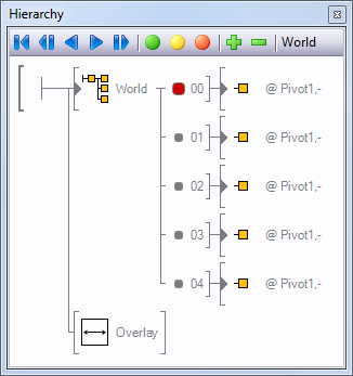

Our scene will consist of two parts: The slides themselves and an overlay layer for a header and footer. Start with adding a Slide Manager node and a Viewport to the scene. Double click
on the Slide Manager and rename it to World. Rename the Viewport to Overlay.
For now, deactivate the Viewport by selecting it (
click) and then pressing CTRL + A. We will use it later to add a header/footer to the presentation. For now, lets focus on the slides.
After adding the Slide Manager to the scene, a button bar appears on the top of the Hierarchy Editor. This is called the Slide Manager Toolbar. Use the plus/minus buttons to adjust the number of slides you require. For this How To, we're just going to need three. The slides that no longer have a connection to the Slide Manager will be listed on the bottom of the Hierarchy Editor underneath the label "Unlinked Item". Simply select all nodes there and remove them.

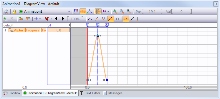

Switch to the Diagram View by pressing the button left of the Logic View button. This shows the function curve of the progress value over time. Press
to pan and turn
to zoom. Initially, the value will be constant at 100%. Move the mouse over the left of the three blue boxes and drag
it down to the zero line. Do the same for the box on the right. This will have the progress at 0% when in S1 or S3 and 100% when in S2. Click and drag
anywhere in the empty region to move the red time line and see how the value changes in the middle column.

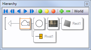

on the triangle of the Slide Manager node to enter the container. You'll see one Pivot node already existing inside the Slide Manager. A pivot defines at which location and orientation in 3D space a slide can be shown. But for now, we can safely ignore it and come back to it later.
Pretty much any node can be used inside a Slide Manager to create the "background" or world. What we are going to do for this example, however, is comparatively simple:
Drag a View node from the Toolbox to the Hierarchy Editor and choose Camera. Insert the camera in front of the Pivot.
on the three dots on the right of the File property in the Property Editor.
Choose a texture that has a number of interesting details in it but is unobtrusive. What usually works best are so called grunge textures, of which are many freely available on the Internet. We will later use a number of regions from this texture as backgrounds for our slides and then move the camera between them to transition between different slides.

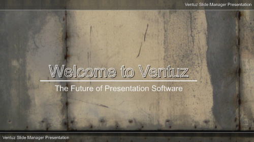

The final touch on our presentation is a nice header/footer. Select the Viewport in the Hierarchy Editor and re-activate it by pressing CTRL + A once again. Uncheck the Background/ClearColor property (if not visible, see favorized properties). The viewport will now clear the depth buffer (allowing the nodes under the viewport to paint over whatever was rendered before the viewport) but keep the color information of what was previously rendered.
To create the header, add a Rectangle with an Axis in front of it to the Viewport. Make the Rectangle wide enough to fill the entire length of the rendering output and adjust the height to an appropriate level. Then use the Y-Position of the Axis to align it with the top of the screen. Add a Color node with a dark color and an Alpha at 60%. Optionally, add a Texture node with the same grunge texture as the background and change the Scaling property in the Mapping node to have it repeat multiple times over the length of the header. This will add just a bit of subtle structure to the header.
Add another Rectangle with a bright color. Make it also wide enough to stretch over the whole screen but very thin. Move it to the bottom edge of the bigger Rectangle. This will create a nice Stroke that separates header from main content. Place some text or logo on top of the header, for example the title of your presentation. Create a footer with the same technique to get the final result.

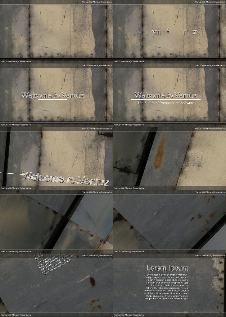

The most difficult part about creating a Ventuz slide show is to create a style or template. Designing a nice background/world, fade in/out transitions for individual slides, Slide content, ... once those are created, filling a presentation with content is pretty simple. Even more so if the designer properly used Interfaces to expose relevant properties so the user does not have to concern about the Slide implementation.
The major advantages of using Ventuz for a slide show are:
Most users design a world and a small number of template slides and add them to their Repository. This is great if more than one talk is done with the same look and feel as creating a new talk then amounts to dragging slide nodes into the scene and changing their content.
