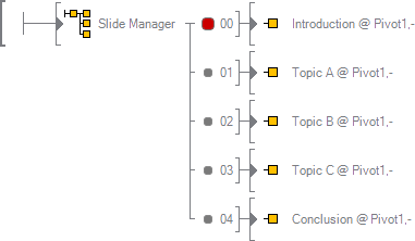

The Slide Manager node itself consists of a Hierarchy Container which is used to host all the nodes belonging to the background, an output for each slide and a Slide node automatically added to each output.
A red circle before the output number indicates the current active Slide. If the circle is green, the Slide is being rendered. If gray, the Slide is completely blocked.
No other node than a Slide (Port) can be attached to a Slide Manager output. There can also be only one Slide per output.
