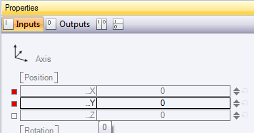

In order to access Properties, Methods and Events of a Ventuz Scene, it is necessary to externalize such elements. So called Externals are represented as concatenated names organized in a folder structure. Externals are always addressed with their full qualified name (e.g. /Line1/PositionY) where the leading / (slash) must always be present.
Externalize
To externalize a member, click left mouse button on the small square button next to the label of the Property, Method or Event while holding the CTRL key to externalize it. The button turns red to indicate an externalized member. Such members are called Externals.
Folders
External names are organized in a folder like structure. By default externalized members are found at the root level of a scene. Therefore all absolute external names are starting with a leading / (slash)
/PositionX
/PositionY
/Text

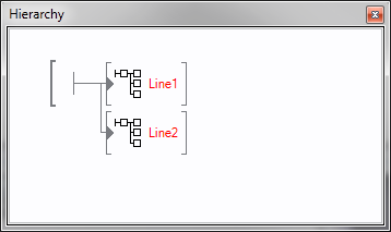

If the nodes that are providing these externals are located inside Containers, the containers themselves can be externalized as well. The container acts as a folder in that case. To externalize a container, the name of the container must as well follow the naming rules of externals before it can be externalized. Open the context menu by press&hold right mouse button on the container in the Hierarchy or Content Editor and select Externalize. The name label of the container turns red to indicate an externalized container level. All members externalized inside such a container will be located under this new folder:
/Line1/PositionX
/Line1/PositionY
/Line1/Text
/Line2/PositionX
/Line2/PositionY
/Line2/Text
Of course multiple nested externalized containers are possible. It is highly recommended to use folders to structure the scenes interface. Too much externals could make the handling very uncomfortable and name clashes could appear.
You can also use Scene Port nodes and let them act as an external folder. To externalize a Scene Port follow the same steps as to externalize a Container. If a Scene Port hosts a nested Scene (see Scene Management all externals of the inner scene will be subordinated under this externalized Scene Port. If the Scene Port node is not externalized the inner externals will not be visible!
To avoid runtime-name-clashes it is recommended to externalize all Scene Port Nodes which are hosting scenes with inner externals!

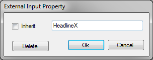

Rename
By default, members are externalized with their default member name (here PositionX and PositionY). This name can be changed by double-clicking on the red button. A simple dialog allows to assign a custom external name. To select the default name check the Inherit box.
To rename folders (containers) simply rename the externalized container in the Hierarchy or Content Editor by double-click left mouse button on it. One can also rename externals in the Externals Editor (see below).
