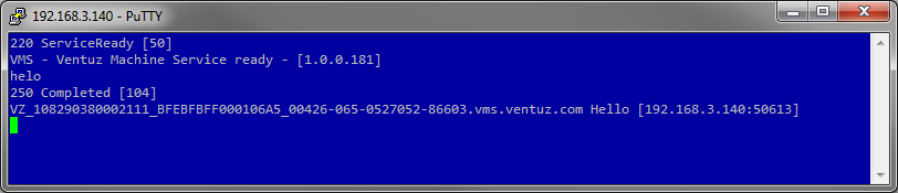

How to connect
VMS runs as a multi-client TCP server on port 19401. The actual communication protocol is text based (UTF-8) and accepts simple human readable commands. A user can use a ​telnet client like ​Putty or ​Microsoft Telnet Client to connect to VMS.
After logging into VMS it displays a welcome message showing the version number of the VMS server.
Typing HELP displays all available commands:
Some simple commands can be executed by command line (telnet). More complex commands (such as uploading new configurations cannot be accomplished by command line, because the data length to be transferred must be known and entered in the command line. It is recommended to perform those tasks programmatically for example with the VMSClient .net class provided in the Remoting4 SDK. The SDK also includes a class VMSDiscovery to locate machine in the network and monitor their states.

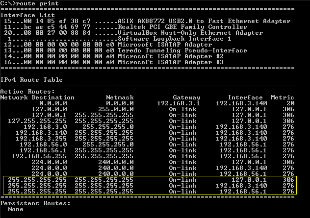

VMS Machine Discovery
VMS broadcasts status and version information every 5 seconds in order to allowed remote clients to monitor all machines with a network. The UDP packets are sent to 255.255.255.255 in IPv4 networks and to 255:255:255:255:255:255:255:255 in IPv6 networks. The VMSDiscovery class can force all VMS services in the network to send their heartbeat immediately if they receive a discovery request. This request is sent by calling the method Discover()
Please note that VMS uses IP Broadcast to send its heartbeat packets (or discover requests). Microsoft Windows routing rules restrict broadcasting packets if your system has multiple connected IP interfaces with the same metric only the first entry in the routing table for one metric value will transfer the broadcasted packets. You can see the current routing tables by entering the following command in the windows command prompt:
route print
In this routing table only the interfaces with the addresses 127.0.0.1 (loopback) and 192.168.3.140 will transfer the VMS broadcast messages. The interfaces with the address 192.168.56.1 won't transfer the broadcast packets.
This ​Microsoft support page explains how to change the metric of network adapters.

HELO
HELO (short for hello) return a message that contains the unique system identifier (SystemID), the version number of the VMS and the IP endpoint of the connected client.
HELO
250 Completed [104]
VZ_108290380002111_BFEBFBFF000106A5_00426-065-0527052-86603 Hello [192.168.3.140:50613]
The unique system identifier is used to identify a physical hardware within the Ventuz network regardless of its IP address or IP addresses. The VMS Discovery uses the SystemID to identify a system if it appears multiple times (multiple IP addresses) or the IP address is changing. The SystemID is constructed by several system identifier separated by an underscore sign (_). Not all system provide proper unique values for Mainboard-serial or Processor-ID. The combination of multiple identifiers should make this string usable for us:
The VMSDiscovery class has a static method GetLocalSystemId() to retrieve the local SystemID. Remote software uses this to filter its own local VMS service against the remote systems.
