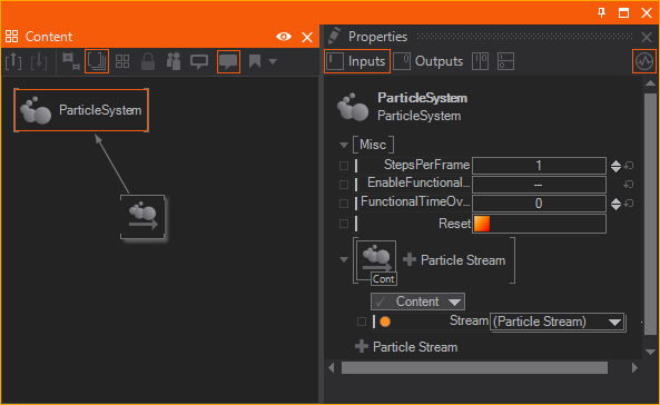

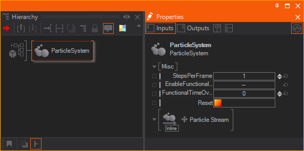

A Particle System must be placed in the scene's hierarchy by using the Particle System Node. It can consist of several Particle Streams. They can be placed either as Property Groups in the Particle System or as Content Nodes and bound to an Input of the Particle System Node.
| Inline Stream | Content Node Stream |

Each particle system can have multiple Streams of modules, allowing to create more complex systems like a Source Emitter whose Particles work as Emitters themselves.
