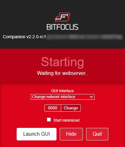

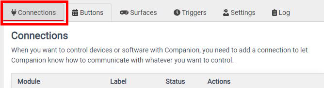

First we want to establish a connection between the Companion and Ventuz Director. To do so we have to create a connection in the Companion. Start the Bitfocus Companion App and  click Launch GUI.

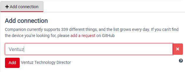

In the GUI, which should have opened up in a browser, select and  click the Connections Tab. Inside you can find a tab labeled + Add Connection on the right hand side, with a Search Panel below. Type Ventuz in the search field and it will show the Ventuz Technology Director Module.  click the red Add button in front of the result to create a new connection for the Ventuz Director.

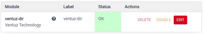

The Module will be listed on the left hand side in the Modules List - it will be labeled ventuz-dir, if you want to change or edit any properties simply  click the red EDIT button. Per default the Target IP is set to 127.0.0.1 / localhost. If you want to control a different machine than your local one, you should set its Target IP now.

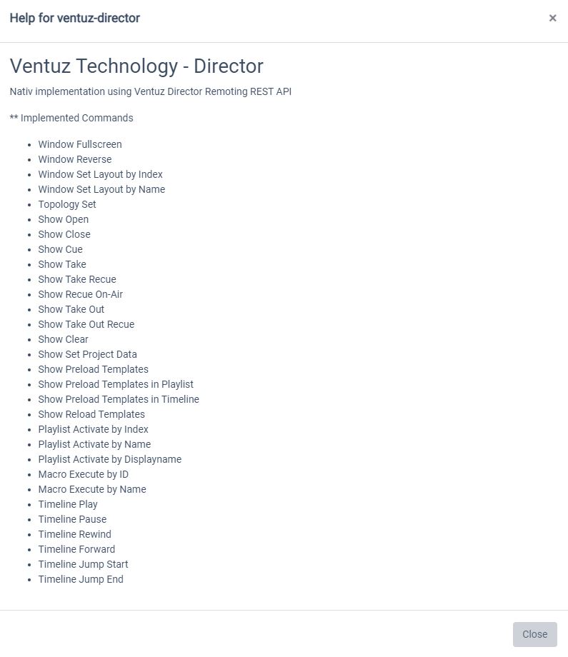

 click the small question mark (?) right behind the ventuz-dir label to get a list of available commands to control the Ventuz Director.

As mentioned above you can get a list of available commands by  click the (?) next to the Module Name. These will come in handy if you want to manually create Buttons from within the companion app.

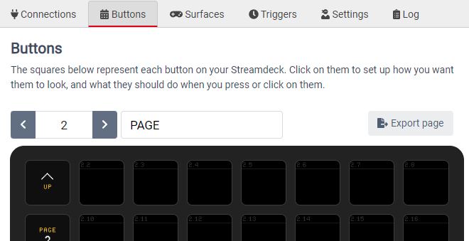

We want to create new Buttons based on our Presets-  click the Tab labeled Buttons to view and edit the Pages of the Stream Deck within the Companion.

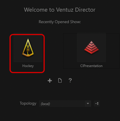

Lets control the playlist of our Hockey Example for the Director by the ease use of the Ventuz Director Presets. Open the Ventuz Director and start the Hockey Example Show with a local topology:

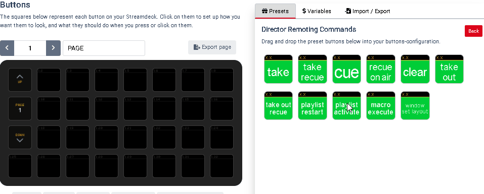

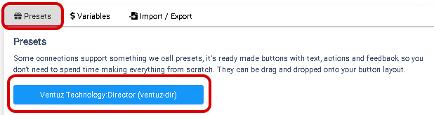

Keep in mind to Enable control via Websocket - like we had to do in the Preparation. Navigate to the Companion GUI and find the Buttons page. On the right hand side you find a Tab called Presets,  click the Ventuz Technology: Director module presets:
Then  click Director Remoting Commands:
You will be shown a list of available Presets - which already appear and look like buttons. You can simply  Drag&Drop these buttons onto the button page.
So  Drag&Drop the playlist activate onto our page 1 of the companion:

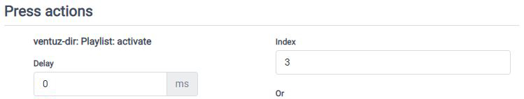

In our case, for the playlist activate the companion needs a valid feedback. Since the playlist activate will set an item in our playlist as an active one, we have to define which item should get activate on button press.
Select the recently created playlist activate button and set in the Press actions and Feedback for Index a value of 3.
Now the playlist activate button will turn green since it also gets a correct feedback from the Ventuz Director. You can also use a ID, name or Display name to activate a specific template. The available properties change by the type of the button/preset. For now we also left the Channel Index at the default value 0 - it will now use the playlist for channel 0. By changing this to another value, you activate the template for another channel (Ventuz Channel 1 starts with 0).

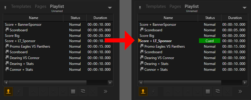

Press the recently created and configured button and notice the template number 4 in the actual playlist will be selected and cue'd:
Again keep in mind that the Index starts with 0 therefore Index 3 is actually the fourth Template in our list. To select and cue the very first template, our index would need to be 0

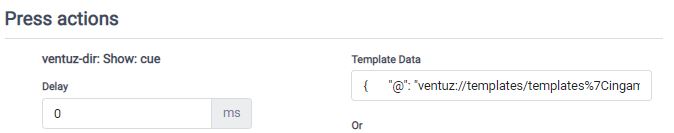

Cueing can also be done with one of the Ventuz Director Module Presets. Just  Drag&Drop the preset labeled cue into one of the empty button slots. Select this newly added button and change the properties on the right hand side of the Companion.
Ensure you apply the changes you do to both, the Press actions and Feedback.
We can cue a template or page by either using the Template Data, URI, Template display name or Page display name.

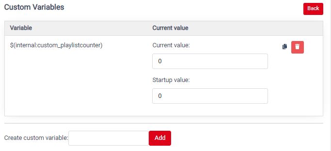

Lets make use of a custom variable and have the playlist skip two steps whenever you press the according button in the Companion or Stream Deck.
Make sure you have the Buttons tab selected and  click the $ Variables tab on the right hand side:
The Custom Variables tab should show up and just simply create a custom variable called playlistcounter -  click Add and the newly created custom variable should show up in the variables list:

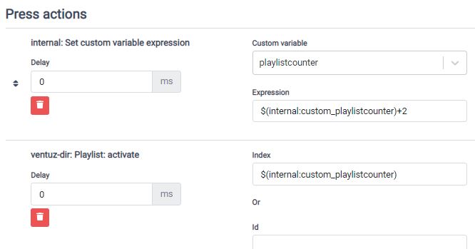

 click an empty button slot and let us create new actions for the selected button by  click the Edit Button tab on the right hand side, and  click Regular Button. You can give this button a description in the Button text field like Skip 2 Templates. Now we add Press actions -  click in the +Add key down/on action and find the internal: Set custom variable expression action. In the Custom variable field we enter playlistcounter and the Expression should read $(internal:custom_playlistcounter)+2.
Add another action, but this time ventuz-dir: Playlist: activate. The Index field should read $(internal:custom_playlistcounter).

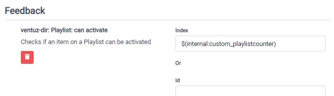

We can add an action for the Feedback and add the ventuz-dir: Playlist: can activate. The Index field will read as well $(internal:custom_playlistcounter).
Now you can skip two playlist items, whenever you press our recently created button. By changing the +2 in the Expression field, you would skip for X then.

You could paste whole template data into the given Template Data input field, like shown in the screenshot below.
