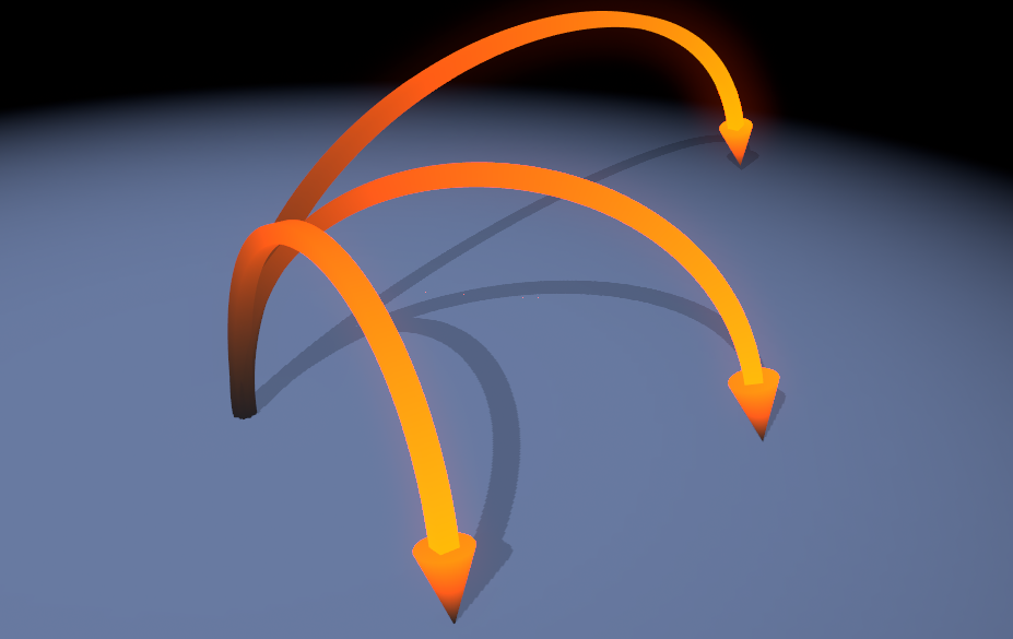

The Arrow Nodes are able to render extruded lines in the scene. There are two types of Arrows for the different kinds of definitions of the line: The Anchor Arrow renders a line from its position to the position of a given Anchor. The Path Arrow extrudes a given Path. The type of the arrow can be changed with the Source property group.

Anchor Arrow
In the Anchor Source property group you can define how the node interprets the given Anchor. The MultiMode adjusts how the given chain of anchors is handled. FromCenter will render all arrows starting at the position of the Arrow Node. Linked will render a chain of arrows along all given anchors. LinkedWithTipAtEnd renders the Tip Mesh on the last anchor only making it seem like a single arrow. Single renders along the whole anchor chain as well but leaves out every other connection between anchors so they appear as individual arrows.
AbsoluteArcHeight and RelativeArcHeight change the curvature of the arrow by adjusting its maximum height. Absolute changes the height in world units and relative creates a height relative to the distance between start and end of an arrow. Curvature changes the course of the arrow - the lower the rounder and the higher the more peaked.
If the shaft is visible through the Tip Mesh you can shorten it with the ShortenShaft property.
