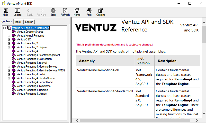

Ventuz 4 is shipped with three different AnyCpu .net assemblies:
Ventuz.Kernel.Remoting4.dll
Ventuz.Kernel.Remoting4.Core.dll
Ventuz.Kernel.Remoting4.Standard.dll
This Ventuz.Kernel.Remoting4.dll is built against the .NET Framework and requires ​Microsoft.NET 4.5. The .NET Core version requires ​.NET Core 2.2. The .NET Standard version requires any framework that supports ​.NET Standard 2.0.
Visual Studio 2012 needs to be installed for all three assemblies because they utilize the new ​Asynchronous Programming technology from Microsoft. Since Remoting4 commands may need time to complete (load or validate a scene or performing a transition) the remote request are all implemented as Tasks. A Task is a Microsoft helper class that can easily handled by the new C# keywords async and await.
Useful classes defined in Ventuz.Kernel.Remoting4.dll. This table is not complete. It only shows the most important classes for Remoting4. Other types (such as enums and other structs) are almost self explaining. Please refer to the IntellisenseTM XML documentation coming with the SDK.
