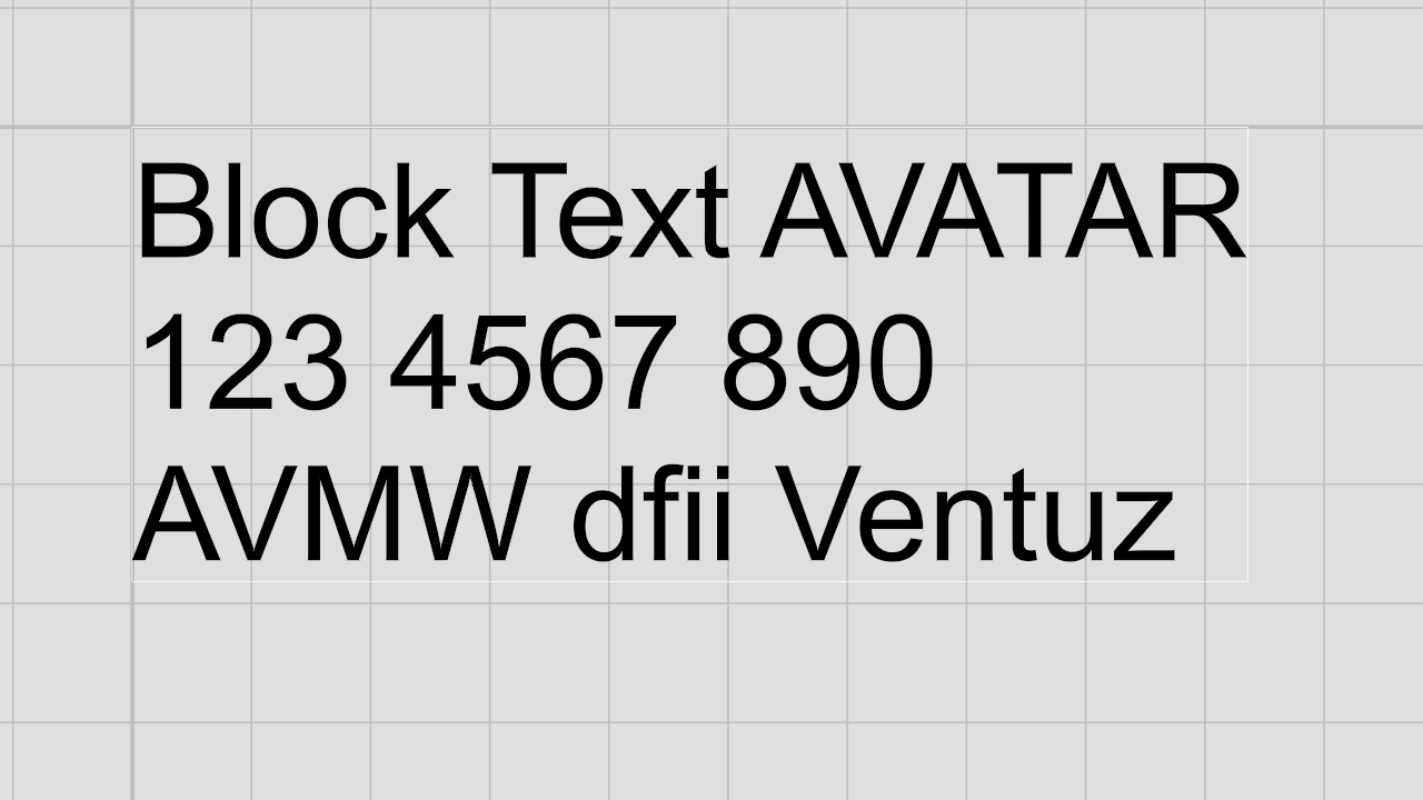

Before Ventuz 5 font loading and text layout was based on a mix of Windows GDI & WPF functionality. This sometimes prevented some fonts from being loaded and lay out correctly. Another big issue was the support of complex script languages like Arabic and Hindi: text in these languages was not always displayed correctly. To solve these problems Ventuz 5 now utilizes DirectWrite. The change of the font layout engine causes some more or less small changes in the text layout and character positioning.

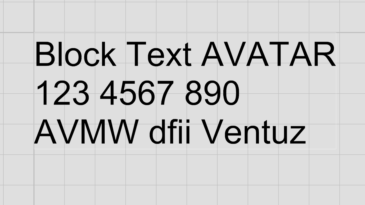

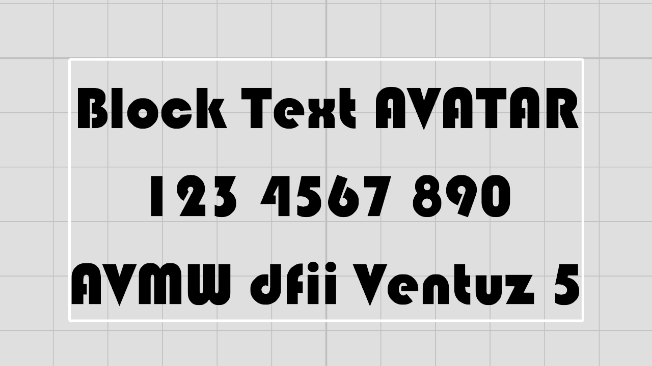

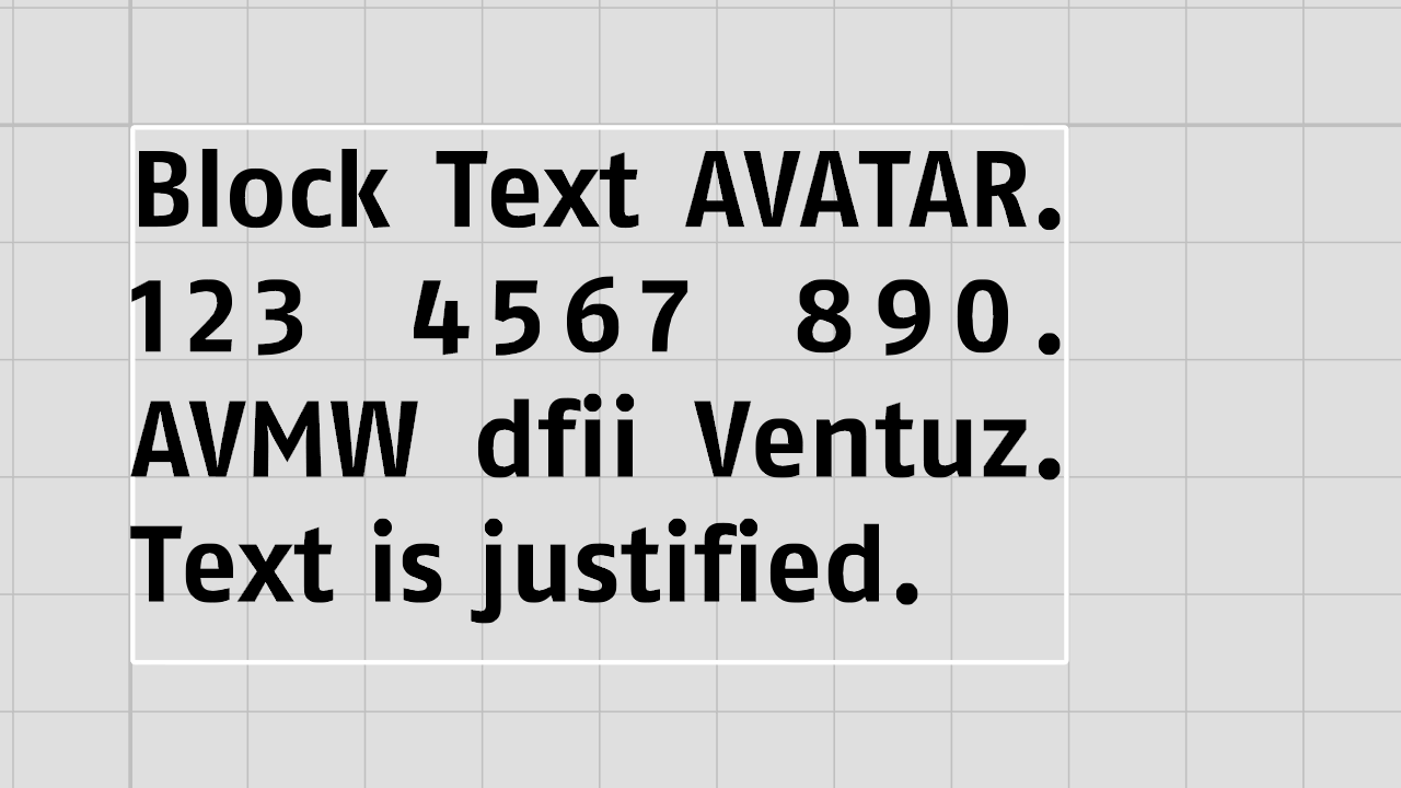

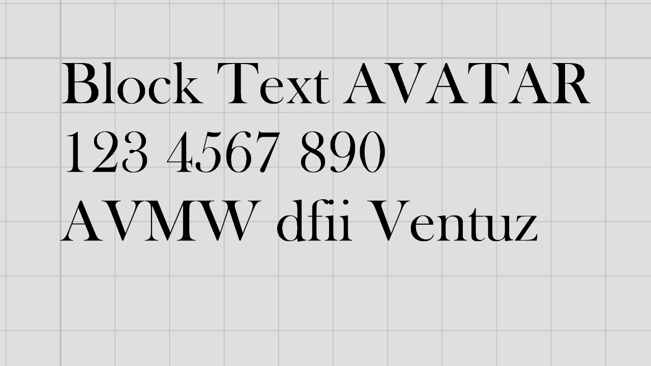

Here are the differences in the new text layout. On the left it the text output of Ventuz 4, on the right Ventuz 5. It's important to note that all these differences do not apply to all fonts. Most of the fonts will be identical or close to the same as in Ventuz 4!

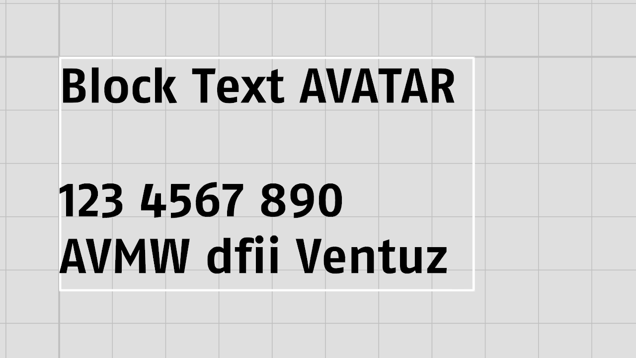

Line Spacing: for some fonts the line distance and base-line may differ between Ventuz 4 and Ventuz 5

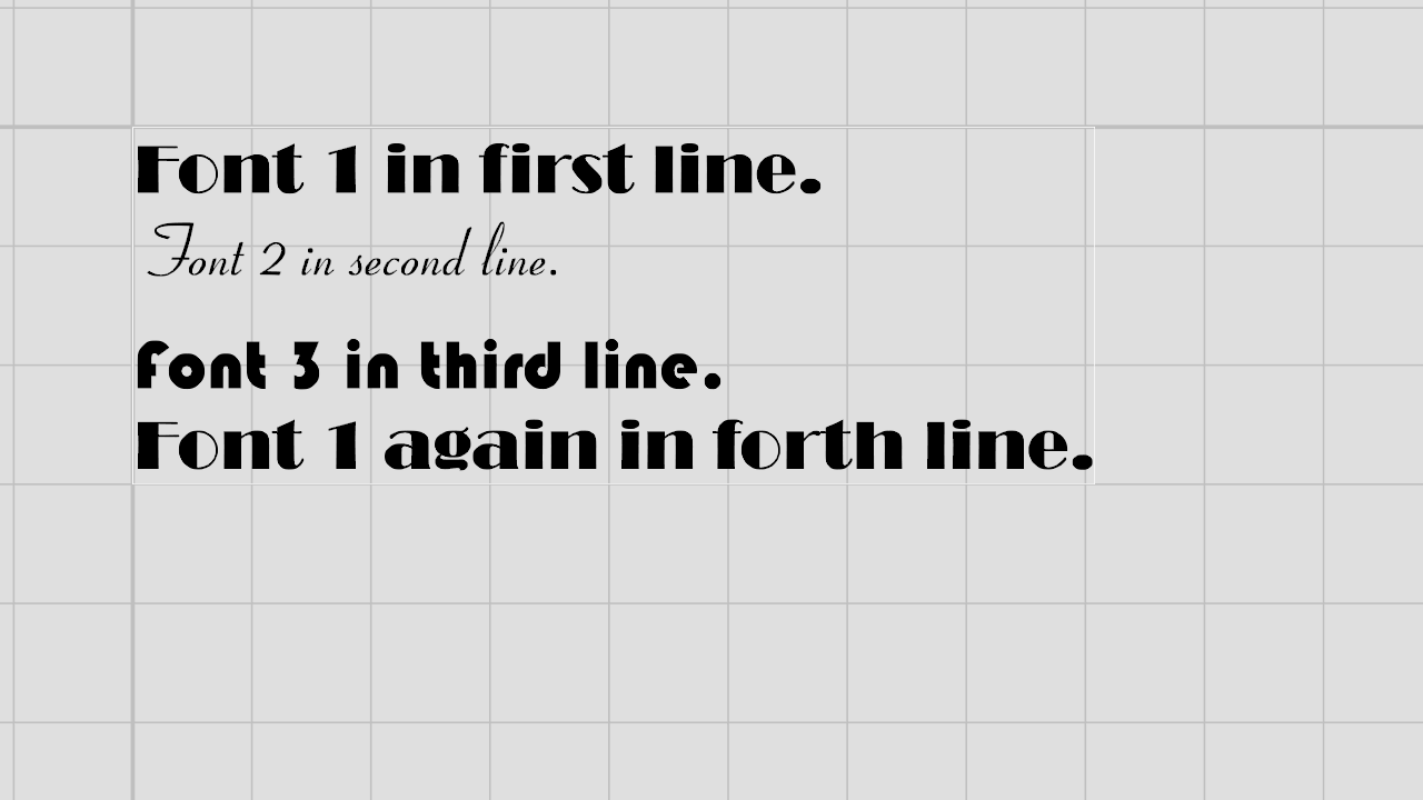

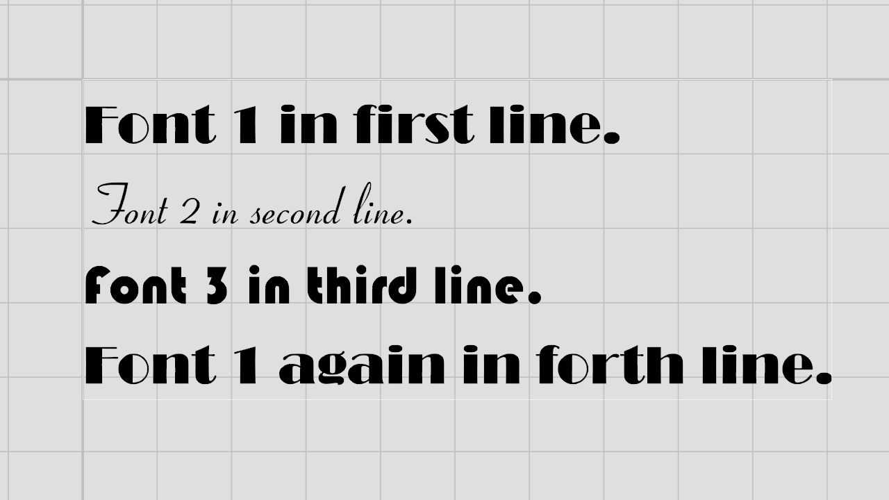

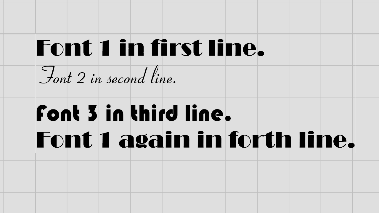

Line Spacing in multi-font text: with the Enriched Block Text node one can mix different fonts in one text. In Ventuz 4 the line distance was only based on the parameters of the first font. In Ventuz 5 every used font is taken into account for line distance calculations.
Scaling: when scaling text in the Enriched Block Text node the line distance was not scaled, this is changed for Ventuz 5.

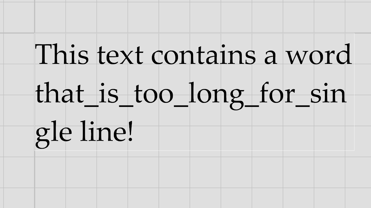

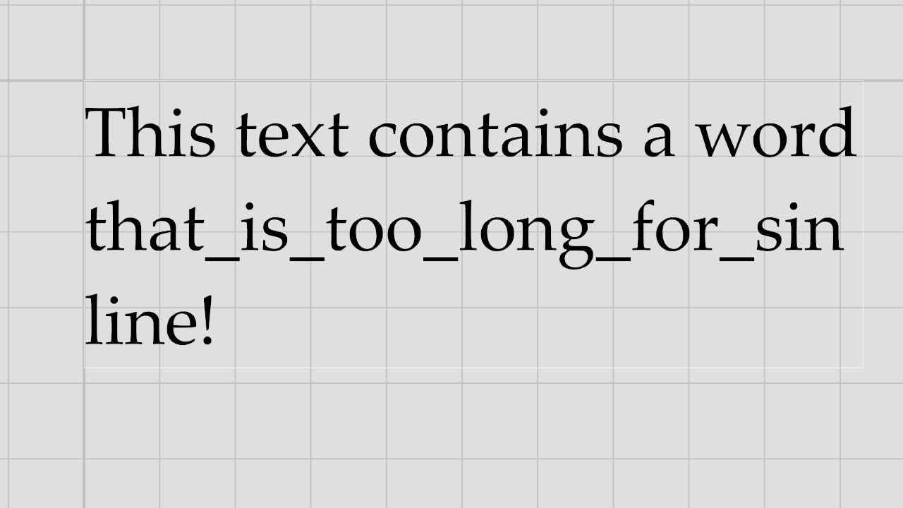

Line Trimming: in Ventuz 4 words which where too long for a single line where trimmed, in Ventuz 5 the exceeding characters are wrapped to the next line.
Trailing Space Character: in Ventuz 5 trailing space characters are trimmed whereas they where handled as normal characters in Ventuz 4.

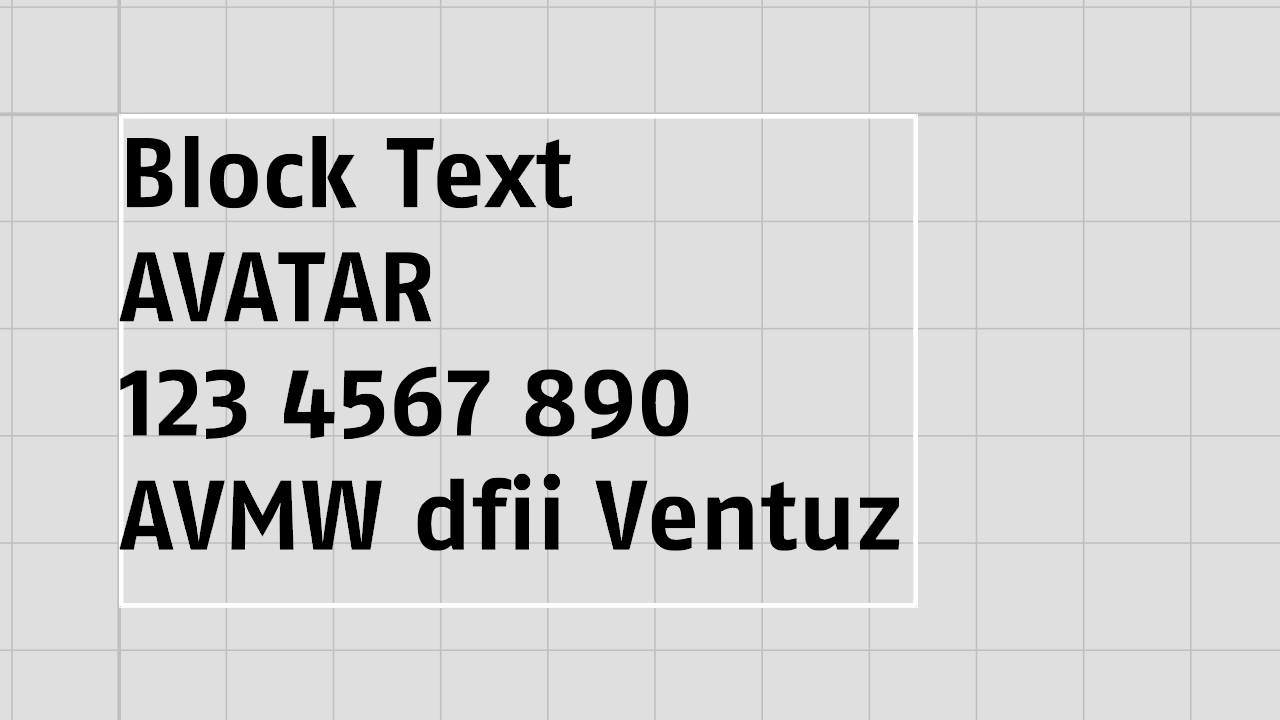

Wrapping: due to slightly different character positioning wrapping might be different as text might exceed boundings earlier or later.
Monospace: monospace layout for non-monospace fonts needs a special layout routine and the average character width taken as reference may differ to Ventuz 4. This may result in a different character spacing in Ventuz 5.

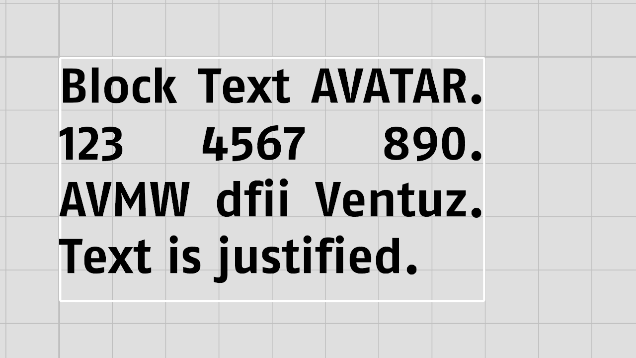

Justification: Ventuz 5, respectively DirectWrite performs an inter-character space modification to justify text, Ventuz 4 just increased the inter-word space.
Center Alignment: Ventuz 5 has a slightly different calculation of center-aligned text.
Kerning: For some fonts (e.g. Arial) character pair kerning cannot be disabled anymore.

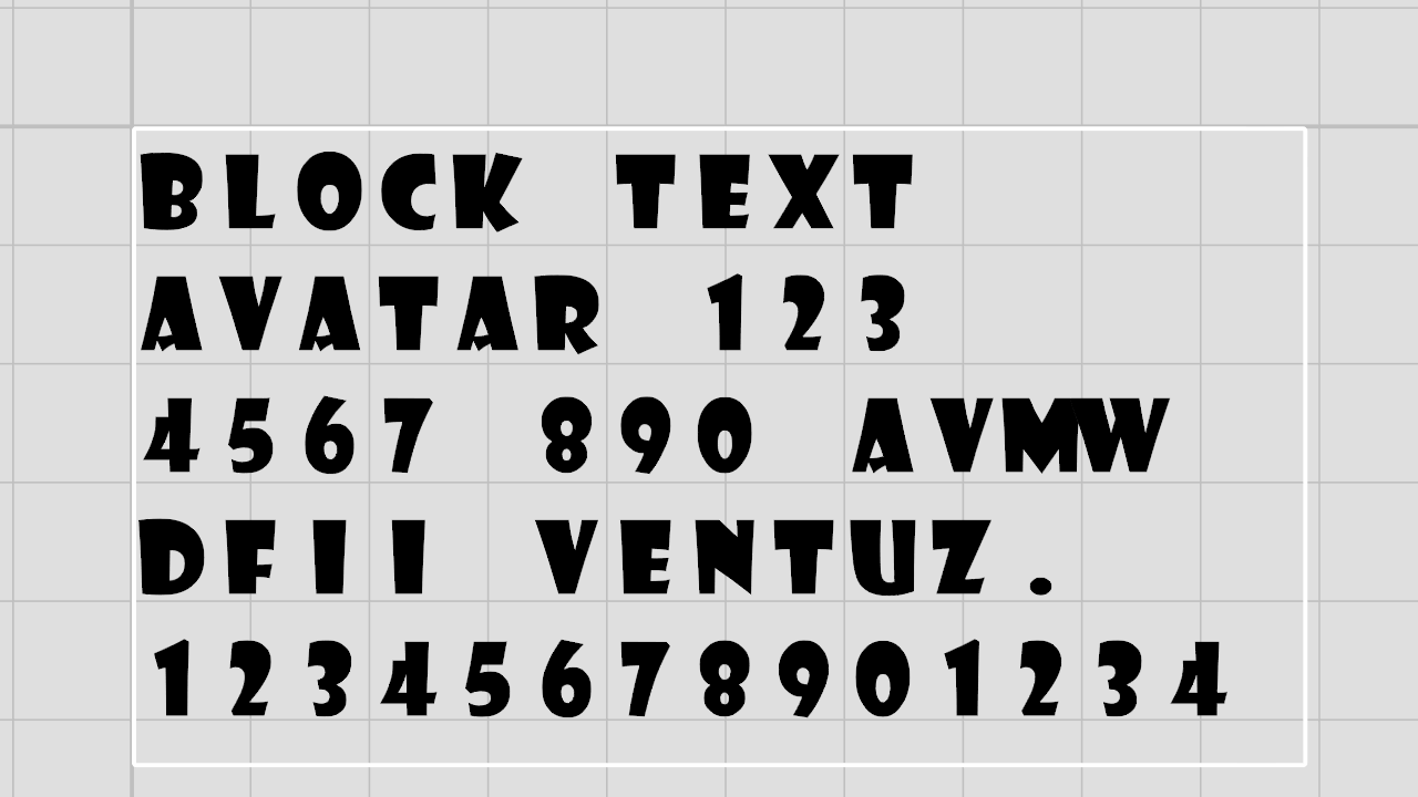

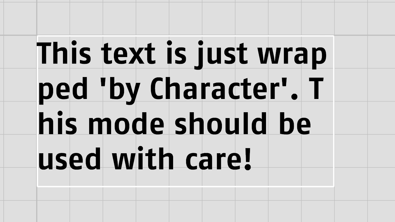

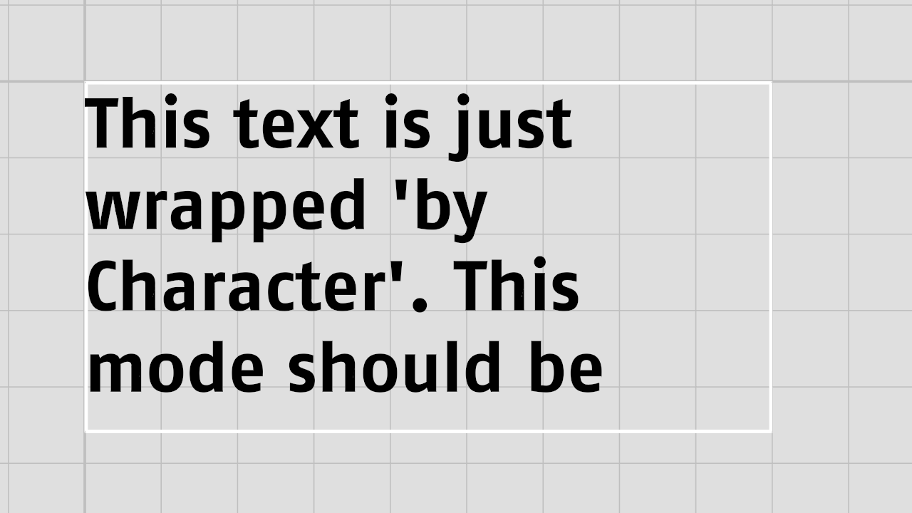

Character Wrapping mode:

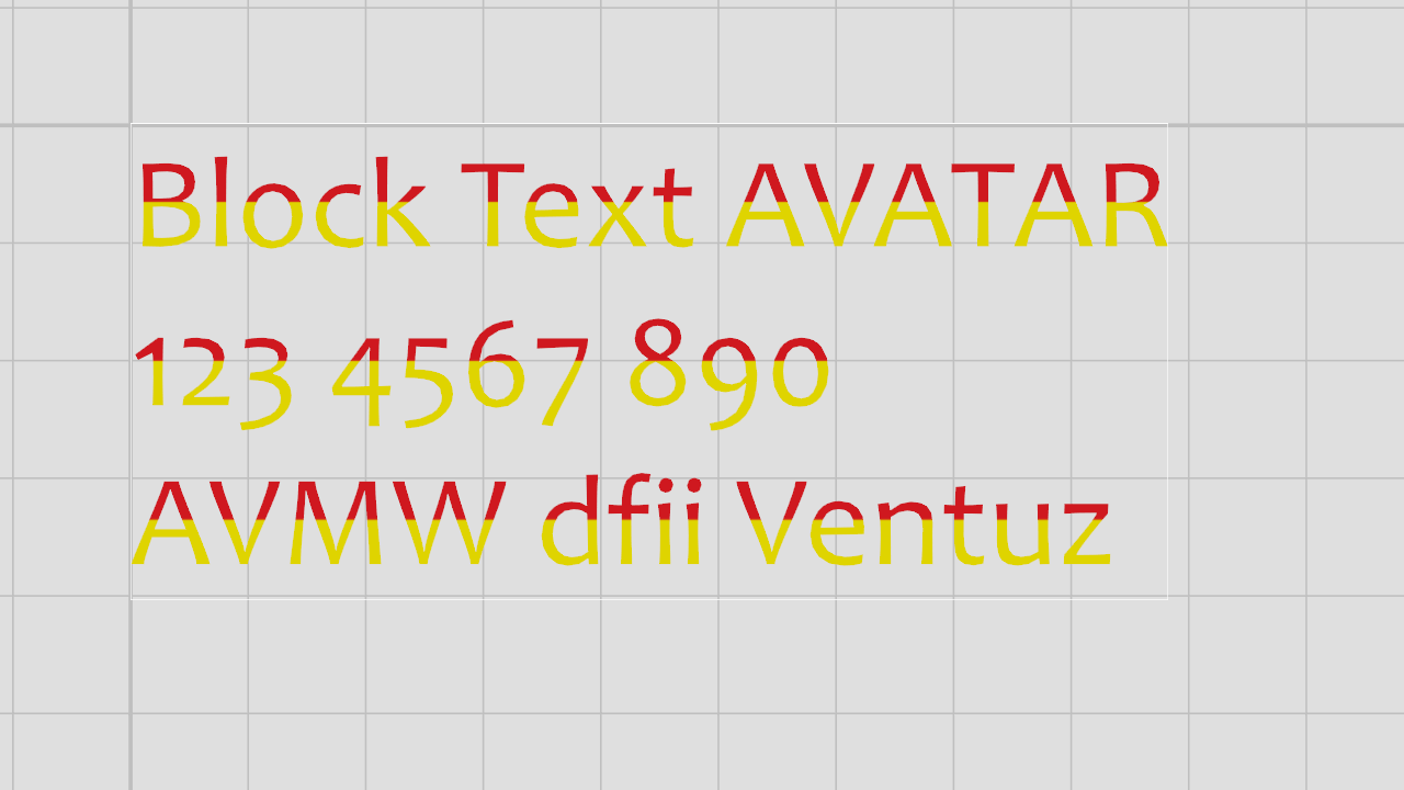

Texture Mapping: Due to slightly different font metric parameter used by DirectWrite the texture mapping on the character may look slightly different.
