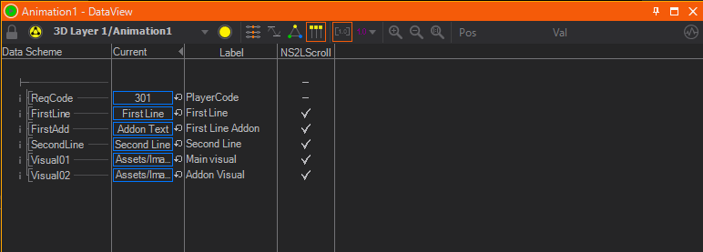

The data model can be created and accessed via the Data View of the animation editor window. As we saw above, this is also where Subtemplates are added and controlled.
To add a data item, simply drag and drop the property to be controlled as animation data into the animation data panel. It will be added in a similar fashion to a scene data or project data element, except that each data element can be associated or disassociated with any of the templates of that animation node. The data panel lists all of the data items for the templates in an animation node and a column layout allowing for every item to be checked or unchecked for each template. By checking the item, the data will be associated with that template. Thus it is possible to have quite complex data models where some data items are shared between templates and others are not.
Each element should be given a unique name, and by clicking on it, you can also edit, in the properties panel, settings such as default value, allowable minimum and maximum values, a label for operator identification, or a description. Remember that as soon as you set up a data channel, any local value you had set will be overridden by the animation data, so it is worth setting up a default value first.

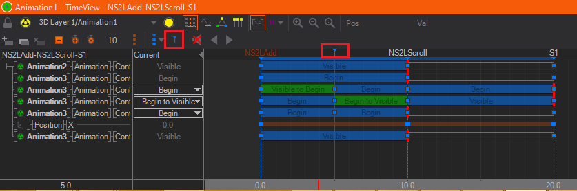

An important key to transitions is the exact point when this data, associated with a template, is passed to the animation node. So, for example, if a self-to-self transition is called, but the data changes, perhaps an animation is desired where the data is changed at a specific moment, but the actual template changes very little. The exact transfer point for the data can be defined in the timeline by positioning a data marker. To place this marker, enter the animation editor window and position the timeline at the point where the data should be transferred, then press M. It will add a small marker at the top of the animation timeline. This marker can be moved, as its properties edited by dragging or selecting it. Multiple markers are allowable, in which case data will be updated on the first marker that is passed and subsequent markers ignored unless the data has changed.

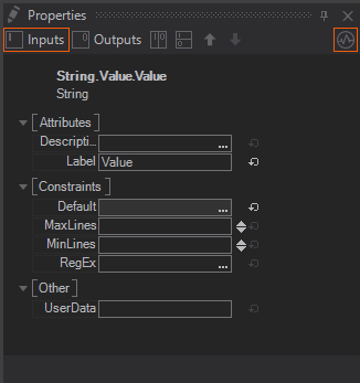

Data Items Meta Data
All Data Items are described by meta data that can be edited in the Property Editor after  clicking it. For example the Ventuz Director uses them to display Template and Project Data properly for the operator of the program. In Remoting you can use the Data Model's Meta Data to accomplish similar results. Below you can see how Ventuz handles these meta data.
General Properties
Besides the Ventuz specific meta data you can define your own data using the UserData property. This is not used by Ventuz anywhere and you can safely use it for information specific to your own application.
Each type of the Data Channels has a Label property that defines the user friendly display name of the channel. As opposed to the data channel names, labels can consist of special characters, e.g. spaces. In addition they are not used to identify a channel, so the data model can have duplicate labels. Similar to the label, the Description is used to present further information to the user - e.g. in the Ventuz Director this is displayed while hovering over the data item.
Format is somewhat specific to the Ventuz Director and its template based workflow - when creating a Page from a template you can decide to automatically create the page's display name and/or description from the current values of the template data. The format property defines what to use from each data item for the automatic naming. The table below shows the possible options - the dropdown of the property also displays some presets that you can choose from.
