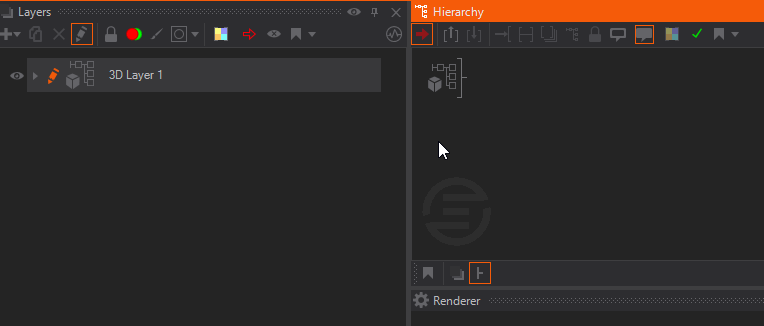

If you would like to have a simple NDI fullscreen layer in your Ventuz scene you would Drag&Drop the NDI Receiver Layer into the Layers editor.

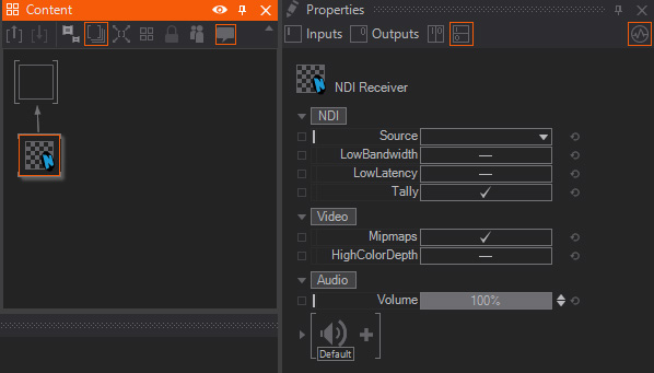

The NDI Properties can be found by clicking on the 2D Layer - NDI Receiver Layer. You can select a NDI Source from there if one is available, by click the Source drop down menu and select an appropriate item from the list. As for all NDI related sources, you can activate the LowBandwith property to save bandwith on the network.
Drag&Drop the NDI Receiver node into the hierarchy editor. This will create a Material node with an NDI Texture Source as BaseColor. To modify the properties for the NDI Receiver node, select the NDI Receiver from within the content editor. If you click the NDI Receiver node you can change all of the values inside of the property editor; for example, select a Source or adjust the Volume as the audio will be embedded into the NDI Stream.
Use the click the Source drop down menu and select an appropriate item from the list.

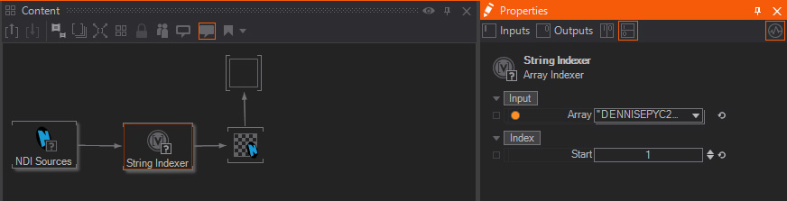

You can make use of the provided Array from the NDI Source List node by binding the output of the NDI Source List to an Array Indexer node with a String input. As soon as your network has several NDI Streams available you can switch trough the streams by changing the Index Value of the Array Indexer.
The output of the String Indexer would be bound to the NDI Receiver Source selection.

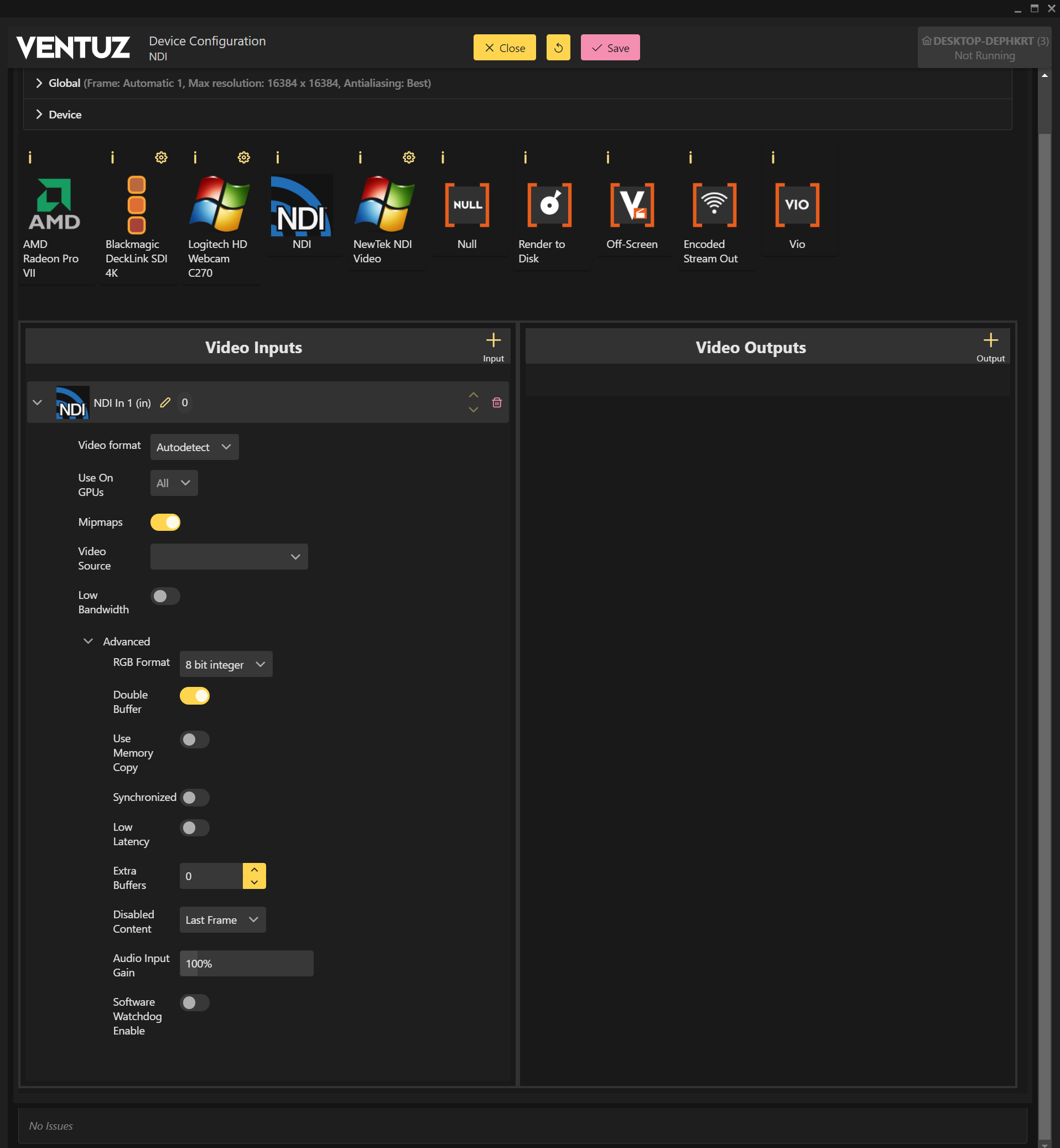

Open the Configuration Editor.

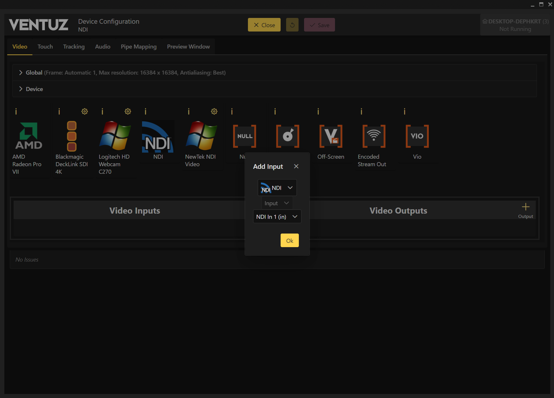

To setup an NDI Input, Drag&Drop the NDI icon from the Devices top bar into the Inputs section.
A dialog box will pop up where you can define which Port should be used as an input.
click the small triangle in front of the NDI Input Source to unfold the NDI Properties. Additional options can be found by click on the small triangle beside Advanced Settings. This will show you all of available properties for the selected NDI Input:
For more detailed information about the Advanced Video Options please refer to the usermanual.

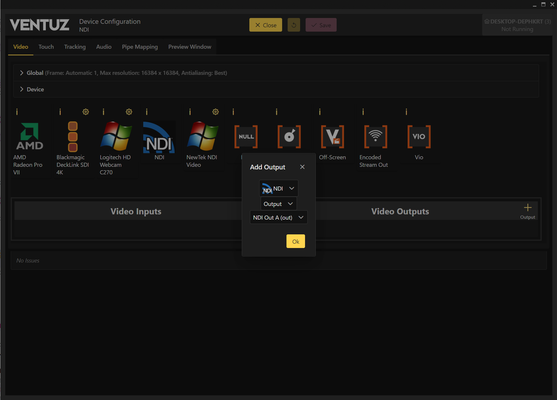

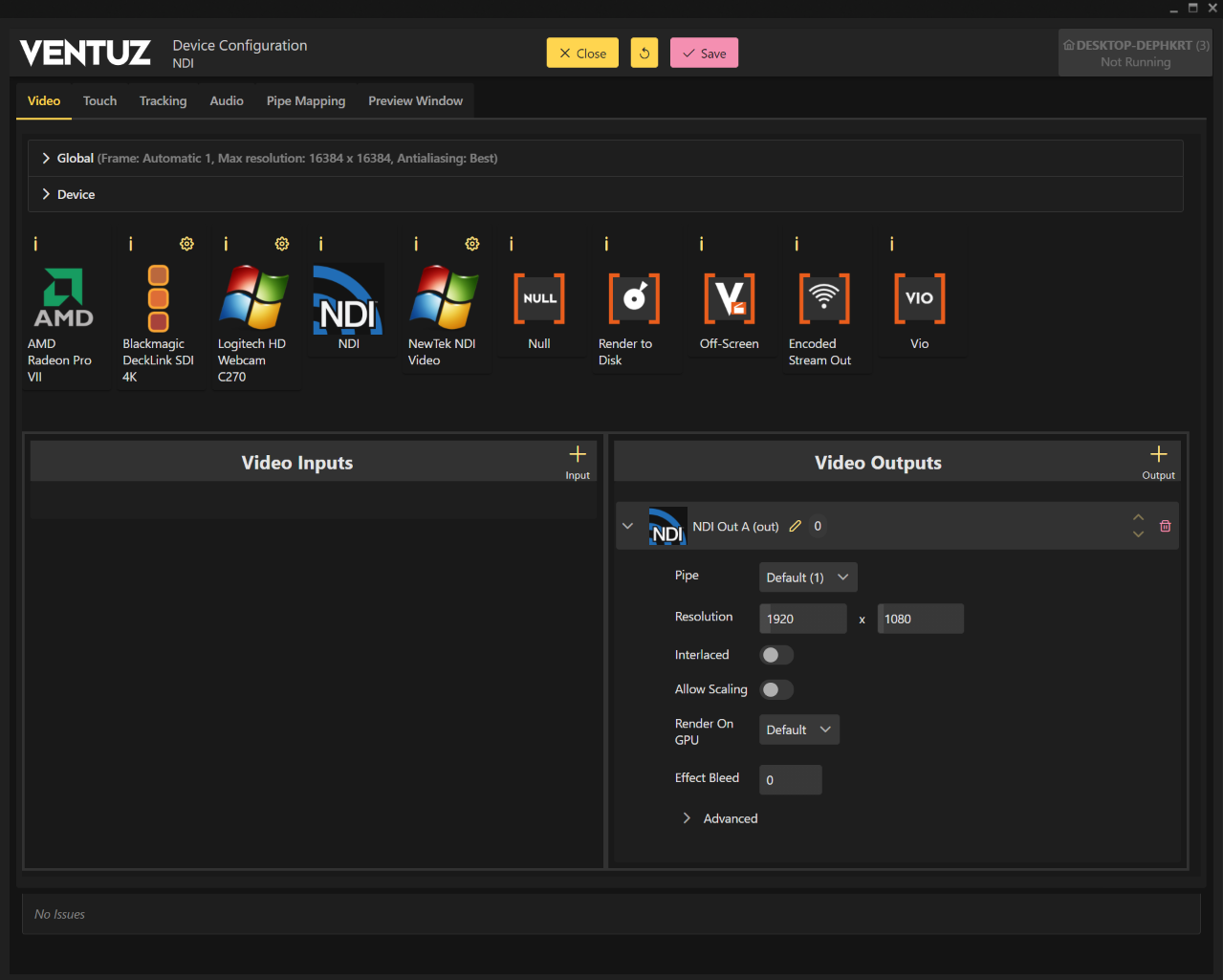

To setup a NDI Output, Drag&Drop the NDI icon from the Devices top bar into the Outputs section.
A dialog box will pop up where you can set the output mode to output or external keying. You can also define the Port from Out A to Out D.
Depending on your licensed output options you can also configure multiple outputs.
The Format Options shows you all of the output Formats supported by NDI out.
For the rest of the output properties, please refer to the Video Options or Advanced Options.

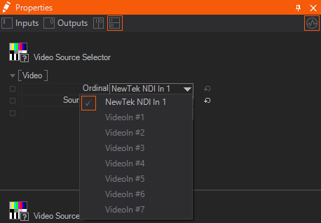

You can use the Video Source Selector node to select and/or switch between the different NDI inputs. Click on the ordinal and select your NewTek NDI In here.

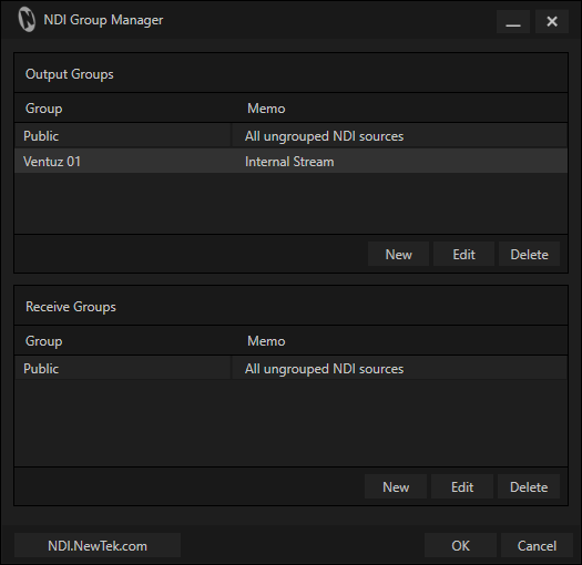

![]() | The NDI Group Manager organizes NDI sources into groups |
You can determine if those sources are public or private. It is also possible to define the visibility of your streams based on a device or system.

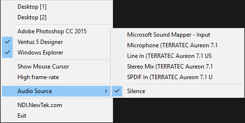

![]() | This is the tool to create an NDI Stream |
You can install this tool, for example, on a Laptop. Once installed you can set your presentation window as a source and stream it into your network.
click on the NDI Scan Converter icon and select your Audio and/or Video source as well as to use the High frame-rate.

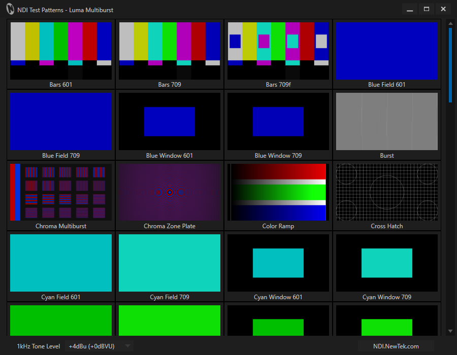

![]() | This tool sends a reference Video and/or Audio |
The tool tests your stream and network. It is useful to test and adjust the quality settings for your Scan Converter. You can chose from a wide variety of Testpatterns.
