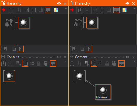

The Render Mode Nodes are Aliases of the Material Node. They change they way the following objects will be rendered. The Material Node has other options that are documented on the respective pages (see table below for more information).

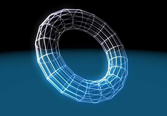

The Render Lines mode will render customizable lines along the edges of the polygons.
This mode has a set of Culling modes available to remove certain edges from the rendering:
  • Show All: Renders all visible edges.
  • Show Rim: Only renders the edges that appear to be the outermost ones from the current perspective.
  • Show Front: Only renders the edges that are facing towards the camera.
  • Show Back: Only renders the edges that are facing away from the camera.
  • Show Front+Rim, Back+Rim, Front+Back: Combinations of the according modes.
  • Remove Flat Tesselation: Removes all edges between two faces with the same normals.
Width changes the thickness of the lines while WidthMode changes how the width is affected by perspective. Unperspective keeps the lines at a constant width on the screen. Perspective Unscaled applies the perspective distortion to the lines but does not use the scaling from the Axis Nodes in front. Perspective Scaled does both - regarding the perspective and all axes. Planar Optimization can be used to prevent the distortion from the projection - that is appearing in high aspect ratio or high field of view setups. This is useful for planar objects rendered as lines but should be disabled for 3-dimensional objects in order to keep its spatial impression.
If in Unperspective node the rendered lines will drop shadows as if they were in Perspective Scaled mode, because shadows will not work with Unperspective lines.
LengthRel and LengthAbs change the length of the lines. Relative length is the percentage to the distance between the endpoints of the edge. Absolute will add an additional length independent from this distance. LengthFromWidth changes the length proportionally to the lines' width.
CapLength will add a cap of the given length with UVs to the end of each line.

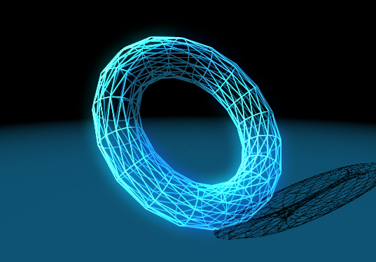

The Render Wireframe mode renders the edges of the polygon using a fill mode defined by DirectX11. This results in a very fast line rendering with very little options. You can only turn Culling for front- and backfaces on and change the Antialiasing of the lines.

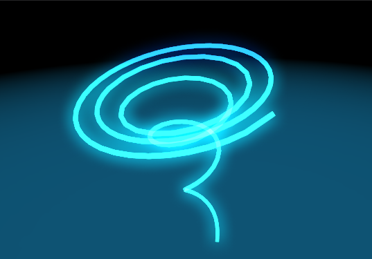

The Render Path mode is a specific mode that makes sense with a list of vertices only - instead of a set of polygons. See the Path Renderer for more details on how to render paths. Using the Path mode instead of the Lines mode will result in a much smoother result, as the renderer can assume that not more than two edges are ending at one vertex - thus applying Caps to the edges' ends is not necessary anymore. You can turn on wireframe rendering in the Renderer's options to see the exact difference between both modes.
Width changes the thickness of the path while WidthMode changes how the width is affected by perspective. Unperspective keeps the lines at a constant width on the screen. Perspective Unscaled applies the perspective distortion to the lines but does not use the scaling from the Axis Nodes in front. Perspective Scaled does both - regarding the perspective and all axes. Planar Optimization can be used to prevent the distortion from the projection - that is appearing in high aspect ratio or high field of view setups. This is useful for planar objects rendered as lines but should be disabled for 3-dimensional objects in order to keep its spatial impression.
If in Unperspective node the rendered paths will drop shadows as if they were in Perspective Scaled mode, because shadows will not work with Unperspective paths.
The UVs that should be used by the Material Stages can be changed with the UV0 and UV1 dropdowns: Original uses the UV set of the geometry, Relative applies UVs from the beginning of the path to the end and along its width.
