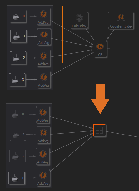

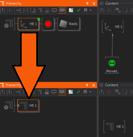

An alternative way is to select a node and then use Node/Merge To Container from the main menu bar. This will replace the selected subtree with a container and place the removed nodes inside the container.
Next to merging a selection to a Hierarchy Container it is also possible to merge content nodes to Content Container.

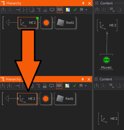

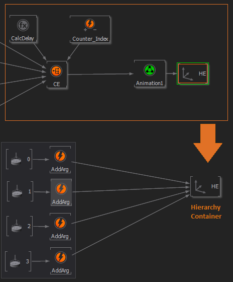

    1. A single Hierarchy Node is selected with children.
      If all selected nodes (including value suppliers) are only connected to this partial tree - the merge is performed and a new Hierarchy Container is created
  1. A single HE node is selected without children click +CTRL.
    Only the single HE node is merged with all its suppliers - a new Hierarchy Container is inserted at the previous location. The icon of the previously selected HE node is exposed. Outputs and multi-links are maintained.

    1. Only CE nodes are selected.
      All nodes are merged into a new Content Container. Bindings that pointed outside the selection are re-created by new exposings.

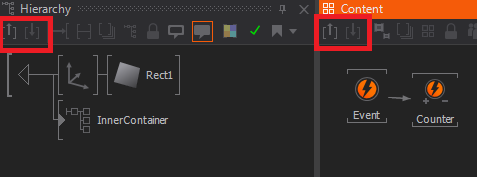

All container nodes can be easily recognized by their gray triangle on the left inside of the node icon. By double clicking  on that triangle or pressing ENTER, the editor leaves the current hierarchy level and switches to the inside of the container. When inside a container, the starting point of the hierarchy is not the familiar scene root T-junction, but the container root, a white triangle. Double clicking  on that icon or pressing BACK takes the Hierarchy Editor out of the current container. You can also use the Container Level Up Button or press CTRL + U and Level Down Button or CTRL + D to navigate through the container levels. Pressing  inside the Hierarchy Editor will display a popup window with the Hierarchy Container structure of the complete scene. This overview can also be used for navigation; just click on the desired container. A very comfortable way to enter and leave containers is to use the click . Just hover with your mouse over the Arrows and click .

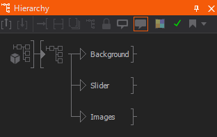

Outputs
By default, a Hierarchy Container is created with one Output Node already inside of it. An Output represents a connection back up to the parent hierarchy level and allows nodes or subtrees to be placed behind the Container.
Inside the Container, the Output nodes represent all nodes behind the container on the parent level. This can be used to encapsulate some functionality inside a Container while leaving a degree of freedom to the user of the Container. As an example, consider someone constructing an animated picture frame inside a container. All the geometries, textures and so on that directly contribute to the frame are inside the Container, but the content that should be rendered inside the frame are kept out of it. This improves reusability and avoids forcing the user to step into the container every time the framed content is to be changed.

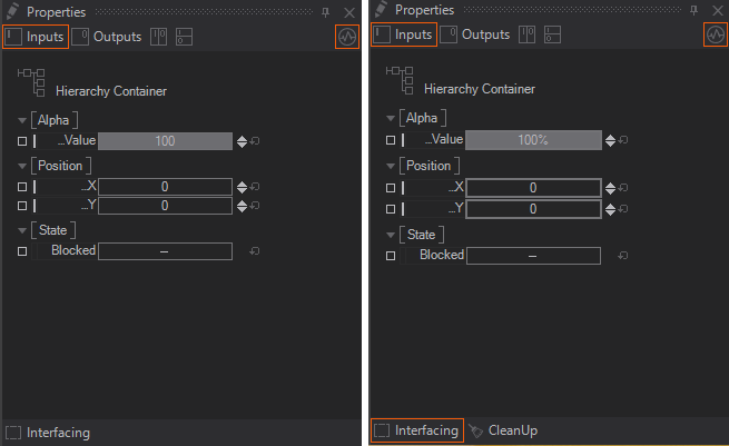

To define an interface, a Container with exposed properties is required. When selecting the Container, an "Interface" button appears at the bottom of the Property Editor. Press it and the container is upgraded to an Interface Container, which is visualized by two lines that close the gap in the brackets that surround the node icon.
When changing a Container to an Interface Container, all exposed properties become interface properties. The difference between them is that interface properties remain defined on the interface even when the property is no longer exposed. All properties exposed after that automatically become interface properties as well.

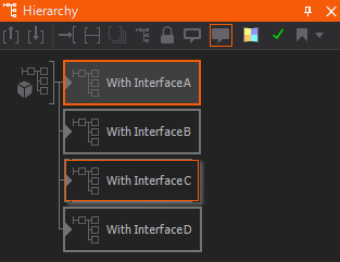

When using drag & drop with an Interface Container, all containers in the scene with an interface defined are highlighted with a dark gray border. When dragging  the selected container over such an interface container, the target's border changes to red. Releasing  in this state will not remove the original node but replace the targets content with that of the source node. The same behavior is achieved by using Edit/Copy and Edit/Paste Container Content from the main menu.
In addition, Ventuz will try to reconnect as many interface properties as possible via its Interface Matching Algorithm. Exposed and Interface Properties match each other if they fulfill the following requirements:
  1. Property Type must be identical: Input Value, Output Value, Method, Event
    1. If the type is Input or Output Value, the SubType must be identical
    2. (float, integer, string, matrix, …)
  2. Property Names must be identical.
  3. The names are compared case sensitive while the category is ignored.
Remember that property names starting with the same text as their category are displayed in the Property Editor without that leading portion: eg. "PositionX" in category "Position" is displayed as “…X”
This matching also works when dragging Interface Containers from the Repository. To improve the quality of automatic reconnection, ensure that all properties have unique names.
