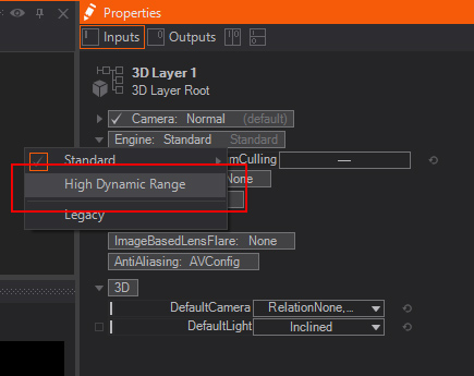

Please switch the 3D Layer's engine to HDR mode.
To enable and use the HDR Engine in Ventuz you just need to do a few clicks.
Select the 3D Layer Root node (the very first node in the Hierarchy Editor in every 3D Layer), then inside the Properties Editor you will find a dropdown menu for the Engine. Click click  on Engine:Standard to bring up the selection menu and select click  High Dynamic Range.
Whenever you switch from Standard to HDR the overall colors will have a slight variation due to the nature of the HDR Mode
As soon as you enabled the HDR Engine you can see more properties like: Exposure, Dither, FrustumCulling and another dropdown menu for the ToneMapping selection as well as another set of properties depending on the selected ToneMapping mode.

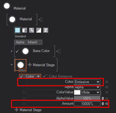

For both scenarios - Lens Flares and Bloom - we need at least one object which is very bright and shifted into the upper dynamic range.
To do so create an axis and a sphere with an applied material node. The material node should have at least a Color material stage and the Color target: Emissive and the amount set to 10000:
Aside from the sphere being just bright, we have adjusted the amount to be 10000%. This looks weird in the first place, but will internally have the sphere a lot brighter than the white that is displayable on your screen. This is a good way to seperate white objects from bright objects, so we can select with IBL-Effects what should be "lit or create a lens-flare".

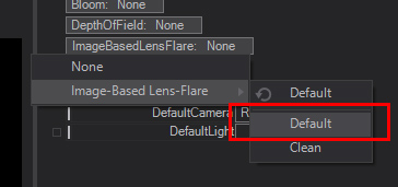

Select the 3D Layer Root node and select the default ImageBasedLensFlare.

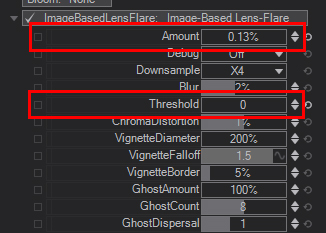

At first look you will notice the lens flares are way too intense. This can be adjusted by decreasing the Amount for the Lens Flares - there are some other values that help with a good looking lens flare effect. Decrease both the Amount: 0.13 and Threshold: 0:
The lens flare can work with this very low amount since we have set the Sphere to have an emmisive value of 10000%. This is not only white but really bright. We set the Threshold to 0 and the Amount to 0.13. By setting the Threshold to 0 we filter the whole image, we do not clip at any brightness and use the whole range to be used by the IPP-Effect. This way we can make use of the full dynamic range of our rendering and select the very bright objects. Because of that we have to lower the Amount for the Lens Flare - and still, the used 0.13% are enough to have the sphere create a flare - You can check whats affecting the lens flare by selecting the Debug: Mask option. This will show you the result of the Mask by the actual threshold.

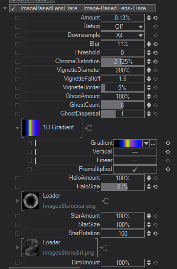

We can still adjust several settings to create a good looking Lens Flare Effect with the following values:
Amount: 0.13%
Blur: 11%
ChromaDistortion: -2.125
Instead of the built in "Loader" for the Gradient we use a custom 1D Gradient with the following string:
Lens Flare Gradient
RGBA;c0:(0, 0, 0);c0.1372549:(0, 0, 0);c0.3372549:(0, 0.1803922, 1);c0.454902:(1, 0.7333333, 0);c0.5019608:(0.4980392, 1, 0);c0.5647059:(0.6745098, 0.3215686, 0.5960785);c0.8509804:(0, 0.08235294, 1);c1:(0.33, 0, 0.66)
If you move the camera around in the free flight mode, you will see how nice the lens flare will behave.
