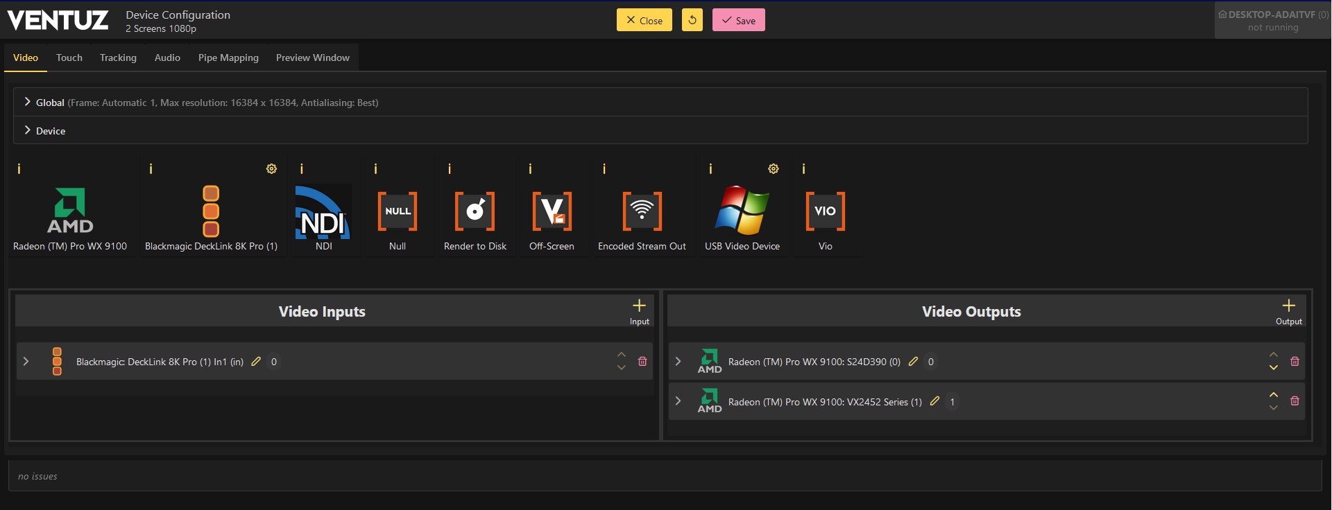

Video
In the Video section all settings are made for video input and output devices. Settings marked with (Live Option) can be edited during running runtime in the linked Live Options.
Global
The Global settings are set for all devices across the machine.
Setting Description

Video Input
Inputs can be dragged into the Inputs window or added by pressing on the Plus sign. There is only one input mode, but some output modes include input streams as well. With adding these streams as input or output the according stream is added as well. The stream settings are mirrored on both sides.
These inputs can be used in Ventuz with the Live Video Node with the according ordinal number of the stream.
Setting Description
Video FormatThe input format can be configured independently from the video format of the outputs. For best results, the frame rate should be the same as the output and all signals should be genlocked together. Most video boards support Autodetect mode. If the video mode of an autodetect input switch, the video engine will synchronize on the new signal. If the video board is not in autodetect mode, it will report signal lost until the stream switches back to the configured video format.
Note: There are specific boards, e.g. Deltacast SDI boards, which do not support mixed framerates. See: SDI hardware information
A list of available formats can be found here, but not all boards support all formats.
Use on GPUsWith Ventuz 7 and Multi GPU support, it is possible to select the availability of input streams on a certain GPU with the Use On GPUs setting. Which might be necessary for performance reasons. Per default, all input streams are usable on all GPUs.
MipmapsInput streams can automatically create mipmaps. Mipmaps are only useful if the incoming video is displayed either in 3D or smaller than 50% of its native resolution.
For more video input settings, check the Advanced Video Options
Some devices may change their stream configuration, depending on the connected physical cabling. In such a case Ventuz will report a missed stream on start-up
Video Output
Outputs can be dragged into the Outputs window or added by pressing on the Plus sign. Depending on the device, the output mode is a simple output rendering or a different Stream Modes. Depending on the device, select the port to use. For GPU outs the name of the connected display is shown or the port number for SDI devices.

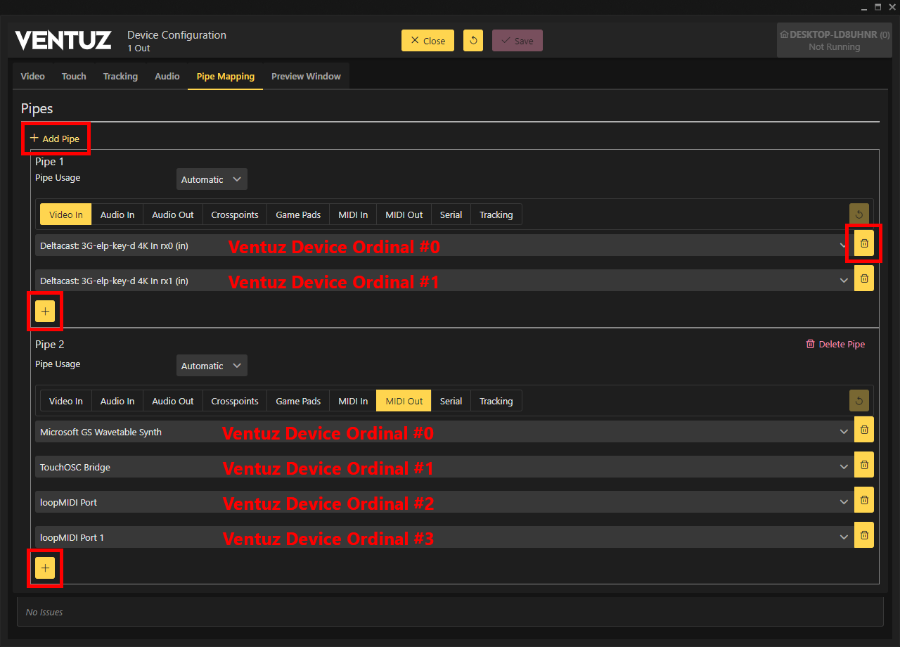

The ID behind the stream name is especially important when setting up the Output Mapping in the Render Setup, since they match with the Output Number in the Mapping tab. With the Pencil Icon it is possible to edit the output to a different existing connector of the device. For example on a GPU out with multiple physical outputs, the used output is changeable without re-creating the whole stream with its settings.
SettingDescription

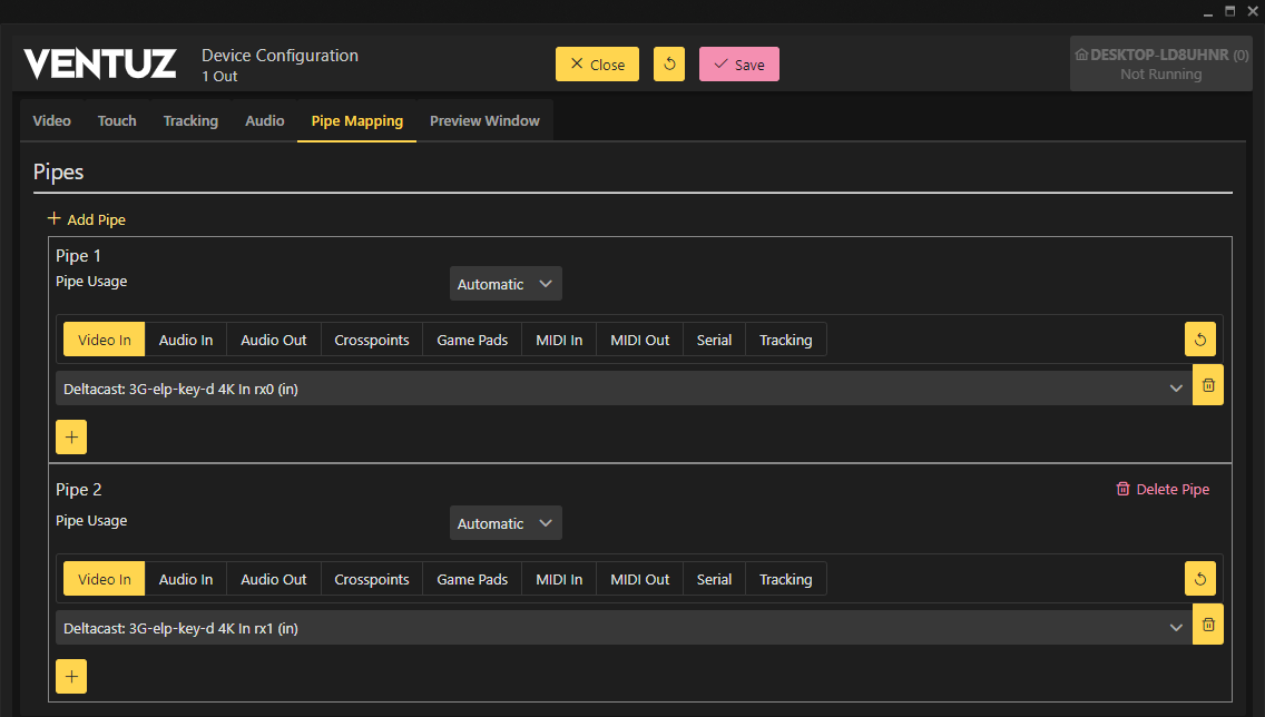

Pipe Select the Pipe which is used for this output. With the Pipe Mapping it is possible to create multiple independent pipes. With this setting you can bind an output to a pipe. With Default the editor maps automatically on the next pipe. With no configured pipes, all Outputs are mapped to the one default pipe.

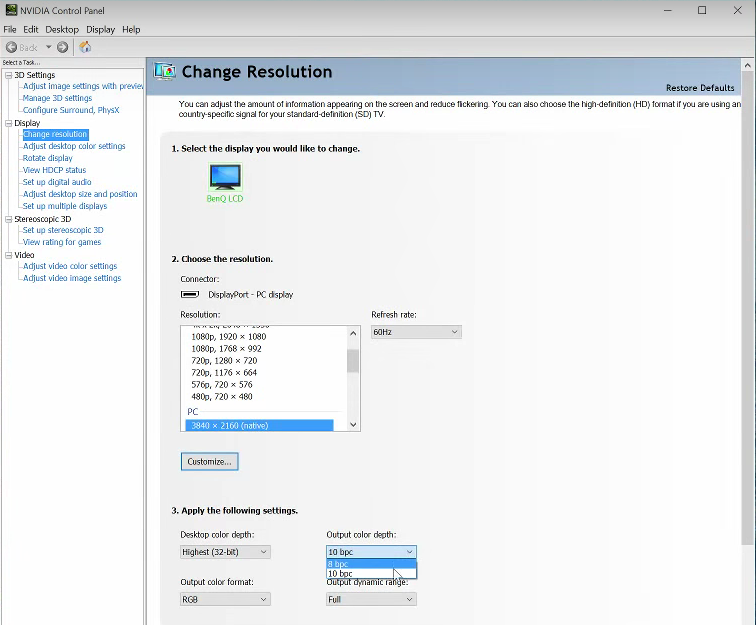

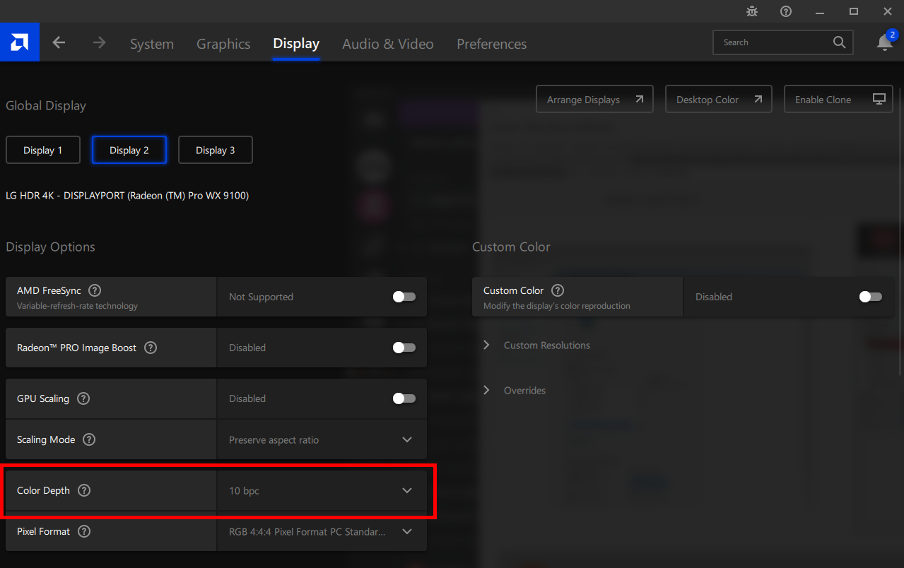

Enable 10bit (DirectX-Mode)
Ventuz, by default, renders at 8bit per RGBA channel but based on the connected Display and GPU you can also output in 10bit color depth in DirectX Mode. This is automatically distinguished based on the Desktop configuration and therefore there is no need to change the Ventuz configuration. Therefore to enable 10 bit output simply configure it inside your Graphics Driver Settings.
Nvidia Control Panel
AMD Software Pro
Changing the color depth to 10bit is not for free and can cause performance issues.

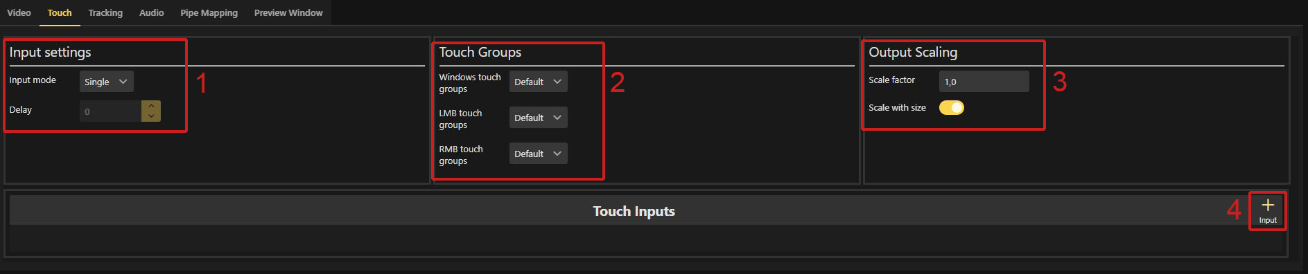

This section allows to configure Touch Inputs. It is possible to set input modes for clustering, decide which Touch Groups should be enabled or how the output scaling is handled.
With Ventuz 7 Windows Touch inputs are not defined by the set Touch Rectangle inside the Render setup anymore and it will be therefore always mapped onto the whole canvas. Please use the Touch Groups to define certain Windows Touch Areas.
The Windows Touch API was introduced by Microsoft with Windows Windows 7 to present a uniform way of devices interacting with the Windows operating system. It is usually only used for simple setups: one touch LCD display that is connected to a single machine. To support multi touch interaction with Windows applications that have no explicit multi touch support, a Windows Touch display generates both touch as well as artificial mouse information.
The TUIO network protocol is often used by dedicated Multi Touch or other input devices. It is the de-facto standard for transmitting touch information between devices/machines. Touch LCD displays, however, often only implement the Windows Touch protocol.
1: Input Settings The Ventuz Input Subsystem is capable of distributing input information from one machine to a cluster of machines. For example, a mouse attached to the host computer can be relayed to a number of rendering client machines. For more information, see Input Handling inside Ventuz. Please note that a valid Cluster License must exist to enable the Cluster Networking for interactivity.
Input modes:
Single: The machine will only react to input information from devices attached to itself. The information will neither be broadcast to the network nor will the machine react to any information that may be broadcast by a Master machine in the same network.
Master: The machine will broadcast the information received from hardware devices attached to it into the network. It will not react to the information directly but listen to the sent network packages in the same way as a Client machine.
Client: The Ventuz scene will not receive any input from hardware devices attached to the local machine. However, it will receive and react to input broadcast by the Master machine.
Delay When using multiple machines, each may have a slightly different latency when it comes to receiving information from the input Master. A machine caches received information until the machine's clock matches the timestamp in the input information package plus the processing delay. So if it takes up to 3 frames to send information from the host to one machine but only 1 frame to get it to another, a sufficiently high processing delay forces all machines to process the information at the same time.
2: Touch Groups Specifies the Touch Groups used for touch events generated by Windows Touch devices, deselecting everything will turn off Windows Touch. With setting up Touch Groups it is possible to map touch events to a specified Touch Group. In all Ventuz touch related Nodes the group can be selected and therefore this node is not reacting on touch events from other groups.
LMB / RMB touch groups With these properties the used touch groups for the right and left mouse button are set. The input mouse will generate artificial touch events to be able to interact with Touch Nodes. If set to None the mouse input is not interacting with Touch Nodes.
3: Output Scaling
Scale with Window Size Both the Inertia and Tick attraction threshold are based on the nodes mapping area, not pixel resolution. Therefore increasing the window size will increase the size of the mapping area coordinate system in screen space and a specific movement will result in a smaller velocity than before. By activating this option, Ventuz will compensate for such changes automatically.
Scaling Factor Use this value to scale the Inertia and Tick Attraction Threshold of all Translation/Rotation/Transformation Nodes. This is most useful when the target presentation system has a much larger display (in physical size, not resolution) than the system the scene was authored on but the node behaviors should feel the same.
4: Touch Inputs Add and configure TUIO touch inputs.
IP Address Multicast IP address used for TUIO messages. If left empty UDP Unicast is used and the TUIO sender must send the data to the local IP address of this Ventuz machine.
PortUDP/IP port for TUIO messages. The default port used for the TUIO protocol is 3333.
TouchGroupsSpecifies the TouchGroups used for touch events received via TUIO protocol.

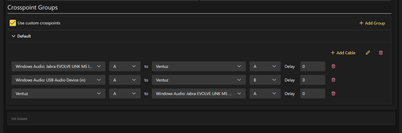

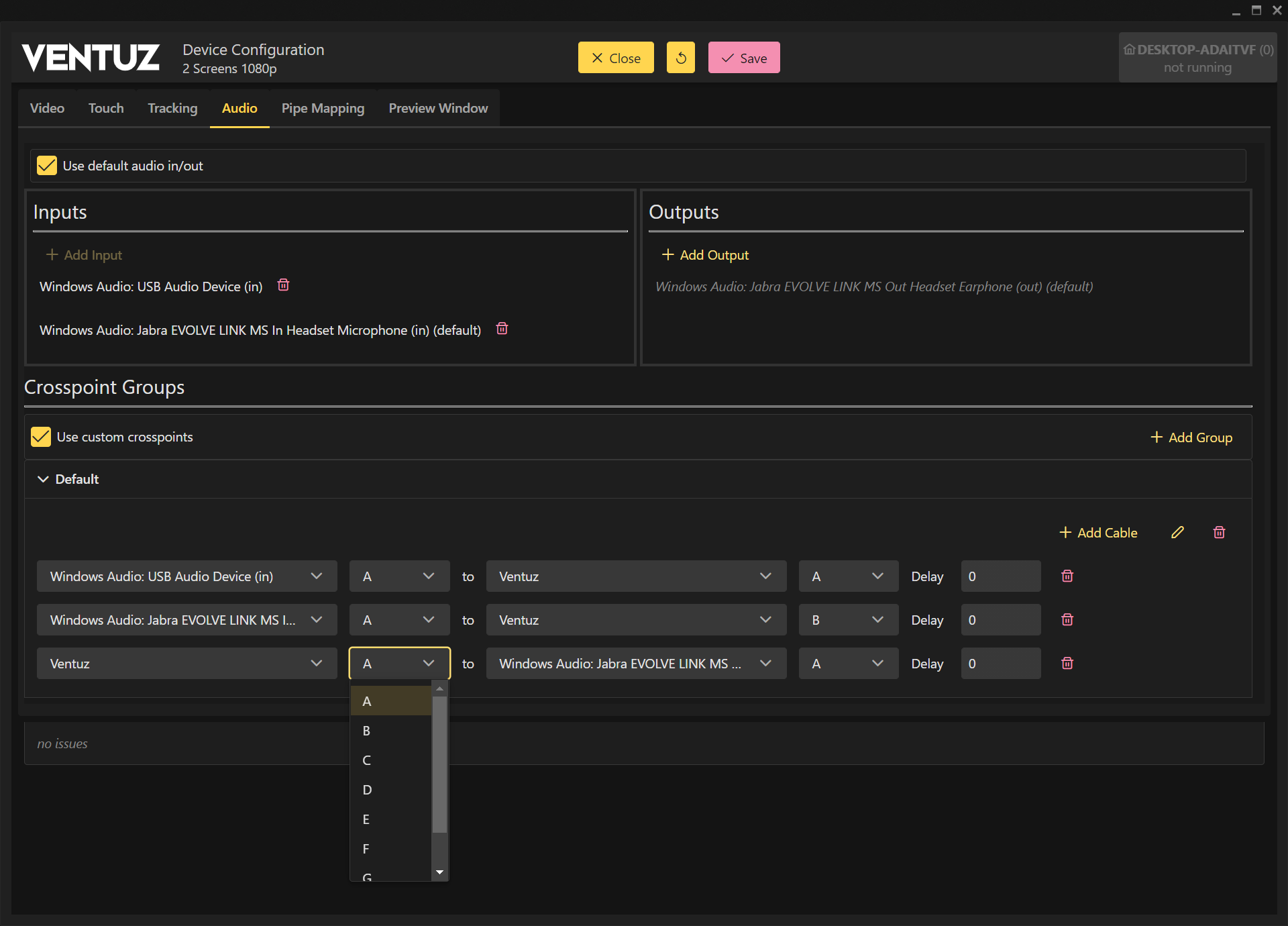

Audio
The Audio section displays all pure audio devices available in the system along with their supported streams (input and/or output). It is possible to route the incoming and outgoing Audio freely. Ventuz is able to work as matrix mixer in complex scenario. All Audio is routed via Cross Points or also described similar as Cables.
To add an Input device or an Output device simply click +Add. Per default, the standart Windows audio devices are used. By adding a device this will be overwritten.
The input and output channels always work as a stereo pair. A typical SDI device has 16 channels, and therefore 8 pairs. A sound-card configured for stereo has one stereo pair, one configured for 5.1 surround has 3 stereo pairs. Stereo pairs are named A, B, C and so forth. Where A maps to the channels 1 and 2 (also referred as 1/2), B to 3/4, etc.
If portable devices such as USB headsets or USB speakers are used Ventuz will reports errors if the device is turned off or has been disconnected prior start-up of Ventuz. Some devices may change their stream configuration depending on the connected physical cabling. In such a case Ventuz will also report a missed stream on start-up.
To enable Ventuz to interact with the audio a virtual Ventuz device exists. It provides 8 Record and 8 Playback stereo pairs with the Ordinal A to H. If Ventuz needs to receive audio from a stream (e.g. for the Audio Analysis a cable from that stream has to be connected to a Record pair of Ventuz. If Ventuz outputs audio a Playback pair must be connected to the desired output stream or output streams. Any audio related node in Ventuz selects the Record or Playback pair to delegate the audio via the channel Ordinal. The wiring defines how the audio is routed.
By default the Use custom crosspoints check box is unchecked. In that case Ventuz automatically subsequently connects the first stereo pair of all configured audio and video stream to the Ventuz Record Pairs. And all available audio outputs on all audio and video streams to the Ventuz Playback Pairs. All automatic cables are grouped is a single cable-group called Default. If the Use custom crosspoints is checked that cables have to created manually.
The Web Browser always outputs on the default Windows Audio device. Sound played by the Web Browser is not passed through the Ventuz Video Engine and is unable to be routed to SDI or other supported devices.
Note that ​ASIO devices are always listed with 8 stereo pairs regardless of the actual physical number of pairs. When trying to access a non-existent pair Ventuz will log an error message. This is necessary since many ASIO drivers need exclusive access to read device information.
Any input stereo pair can be mixed to any output stereo pair. In practice usually only a few such cross points are needed. Each line in the configuration represents one cross points. Each cross points consists of an input device with stereo pair and an output device with stereo pair.

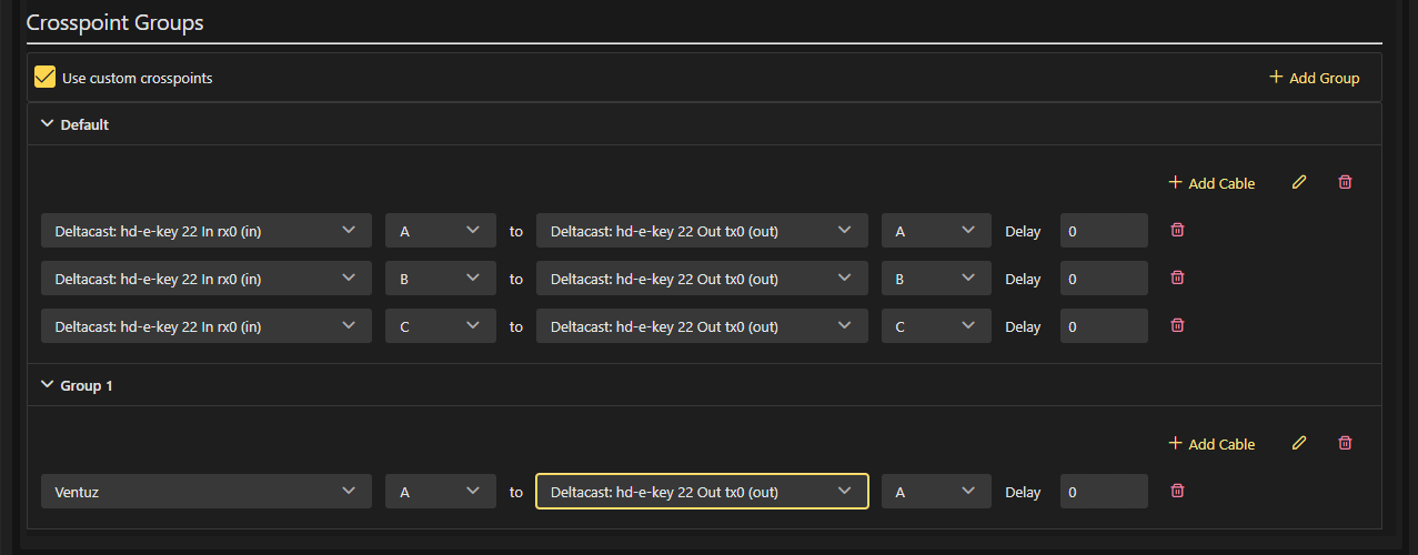

Cross Points (or cables) are combined named groups. Inside Ventuz, the volume and stereo panning for each group can be automated by using the Volume Control Node. If many stereo pairs have to be automated in parallel, grouping them and giving the group a descriptive name can avoid confusion.
Please make sure that only one Volume Control Node controls a group at a time. Concurrent controlling would cause unexpected behavior. The rules here are last-in-last-out; the last access to the group in the current frame will set the parameters. If concurrent access happened within one render cycle a silent warning message will be logged.
Each cross point has its own Delay value. Although the default value is 0 it doesn't mean that there's no delay on the audio. The Ventuz Video Engine takes care about the minimum audio delay required to be in-sync with the video output. The user can adjust the delay value in milliseconds, but as long the actual minimum delay is not exceeded no additional delay will apply. The minimum delay depends on the entire structure of configured streams and is currently not displayed to the user.
Crosspoints Example: Adding Ventuz to SDI
Let's assume we don't have a hardware keyer (internal or external) that supports audio mixing. In this case, we must use the software keyer. This example shows how to pass through a 5.1 audio signal (not Dolby) from SDI in to SDI out and add stereo sound effects from Ventuz.
The AV config for such an situation looks like this:
We have two groups: the first group (LoopThrough) loops the SDI audio input to the SDI audio output. The second one (SoundEffects) adds Ventuz audio in stereo to the SDI output. The volume of each group can be controlled with the Volume Control Node. For instance, one could duck the SDI loop-through before playing sound from Ventuz.
A common mistake is trying to loop SDI output through Ventuz. This will not work. Imagine working with normal audio equipment. Ventuz audio output is like a synthesizer. To add a synthesizer to the mix, one does not loop the signal through the synthesizer, the synthesizer is just connected to the mixer.
The SDI input is like a microphone input, and the Ventuz output is like the output of a synthesizer. This is confusing. Instead of thinking in terms of inputs and outputs, think in terms of audio sources (left side of the cross-points window) and audio destinations (right side), from the perspective of a matrix mixer. So the Ventuz output is an input (source) to the mixer.
Pipe Mapping
In the Pipe Mapping section the amount of Render Pipes can be configured and the mapping of the input and output devices for each Pipe adjusted. For more information about Render Pipes, see: Introduction to the Video Engine
With Ventuz 7 the configuration of Render Pipes is not bound anymore to the output streams. Before, every configured output stream (e.g NDI or GPU span) created an own Render Pipe. With Ventuz 7 onwards, it is possible to create output streams with much more freedom and independent from the amount of Pipes. Rendering the same Pipe multiple times with different outputs is no problem. Depending on your Ventuz license, the amount of avaible pipes is not limited. Therefore it is necessary to configure the amount of Pipes independently. And later assign them to the output in the Video Output stream configuration.
Click +Add Pipe to add a Pipe. The property Pipe Usage determines the mode for the runtime in this pipe. It is set to Automatic per default. For most scenarios this is fine. When using with the Director, the Pipes of the runtime will be set according to the Director Topology automatically to the correct mode, if set to Automatic. In a case you manually want to overwrite this property, you can set it here. Also when using with the Remoting Api it is useful to set the Pipe mode manually.
The changes of adding or deleting Render Pipes are only effective with restarting the runtime. The mapping of the ordinals can be changed on the fly.
With the Device Mapping tabs for each Pipe it is possible to map the internal Device Ordinals to specific in- and outputs for each Pipe individually. The physical order of devices enumeration is set by the Device Config (e.g. Video Input streams) or by Windows. These orders need to be mapped to a logical order used by Ventuz nodes. A Ventuz node that accesses a stream or device uses a so called Device Ordinal - a zero-based index that is passed through the Mapping for being resolved to the physical index of available devices. By default a one-to-one mapping is configured, so a logical device ordinal 0 maps to the physical device index 0, 1 to 1, 2 to 2, ... . The mapping list is endless: every index is mapped to another one.
Each Device Mapping tab lists the available devices in selection boxes. They are listed in the default one-to-one order as described, where the first selection box or row refers to Ordinal 0 and the next to Ordinal 1 and so on. To change the mapping of a device to Ordinal 0, simply change the device in the first selection box. Multiple logical Ventuz Ordinals can be mapped to the same This configuration is independent for each created Pipe.
With the Plus Icon you can add another row of mapping to the next higher ordinal. Therefore it is possible to map to more Ordinals than input device available. With the Bin Icon a row can be deleted.
Logical Device Ordinals can be mapped to the following device and stream types:
Type Description Ventuz Nodes
Video Input Video Input streams Live Video
Audio In Ventuz Record stereo pairs Audio Analysis
Audio Out Ventuz Playback stereo pairs Sound and Audio, Movie
Gamepads Gamepads or Joysticks Joystick
Crosspoints Audio Cross Point groups Volume Control
MIDI Input MIDI input devices MIDI Input
MIDI Output MIDI output devices MIDI Input
Serial COM Serial COM interfaces Serial Text
Tracking Tracking Device Tracking Device
The endless mapping defines that even if for example no entry is visible at the 21st rows the 21st logical device ordinal will be mapped to the 21st physical device!
Example
To configure the two Pipes so that each of them has its own live video input as its first device (Ordinal 0) use the following mapping. Please note that the second row (Ordinal 1) contains a NONE entry for both pipes, because the endless mapping would map Ordinal 1 to device 1 if no explicit entry exists for ordinal 1. In this case both pipes would resolve to device 1 (Deltacast HD key input In rx1) on Ordinal 1.
