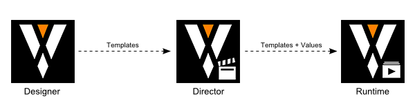

A Template-Based Workflow
So what are templates? A typical workflow starts with a designer creating a Ventuz project. He defines the look-and-feel of a project such as which colors to use in a bar chart or the style of an over the shoulder graphic. However, the actual content/values are usually not known at this point in time. So instead of storing the values shown in a chart inside the scene, he rather creates a template for the chart. A template defines what animations to play to bring it on screen, what the graphical elements the chart consists of and what animations to play to get it off again. Most importantly, a template also defines what values need to be filled-in at show time. In our example, those might be the latest update of counts during an election. The actual result does not matter for the designer, in fact he will most likely prepare the Ventuz Project weeks or months before the actual event occurs.
On the day of the election, the operator running the show grabs a copy of the Ventuz project and heads off to the show. He opens up Director and is basically ready to go. Whenever a bar chart is needed, he just selects it inside Director from the list of all templates he has been supplied with. He cues it, fills in the actual values and when the director of the show needs the bar chart, the operator just presses "take". It's that simple!

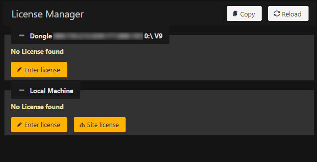

To use Director, a license is required. Therefore starting Director without a license will automatically launch the Ventuz License Manager. There are various Ventuz Editions that support cluster rendering, SDI output and more. If a license has already been purchased, see Ventuz Getting Started on how to activate it. Since this guide is written for new users, we'll instead focus on acquiring a Community License.
The screenshot above shows two entries: The first represents a Ventuz dongle that has been detected which contains no appropriate licenses. Purchased licenses are usually installed on a dongle so an operator can take the license with him when switching machines. For Community licenses, a license is stored on the machine itself instead of on a dongle. Visit ​Our Website to obtain a Community License Key. Once obtained, it can be activated in the Ventuz License Manager.
An active internet connection is required to activate and use a Community Edition Ventuz Installation!
While a Community Edition has some ​Functional Limits you can also try out the full potential of the Director using a PLE (Prototyping and Learning Edition) that will disrupt the operation of the Director repeatedly but offers the full functionality of the software. Both editions can be acquired in our ​Our Shop.

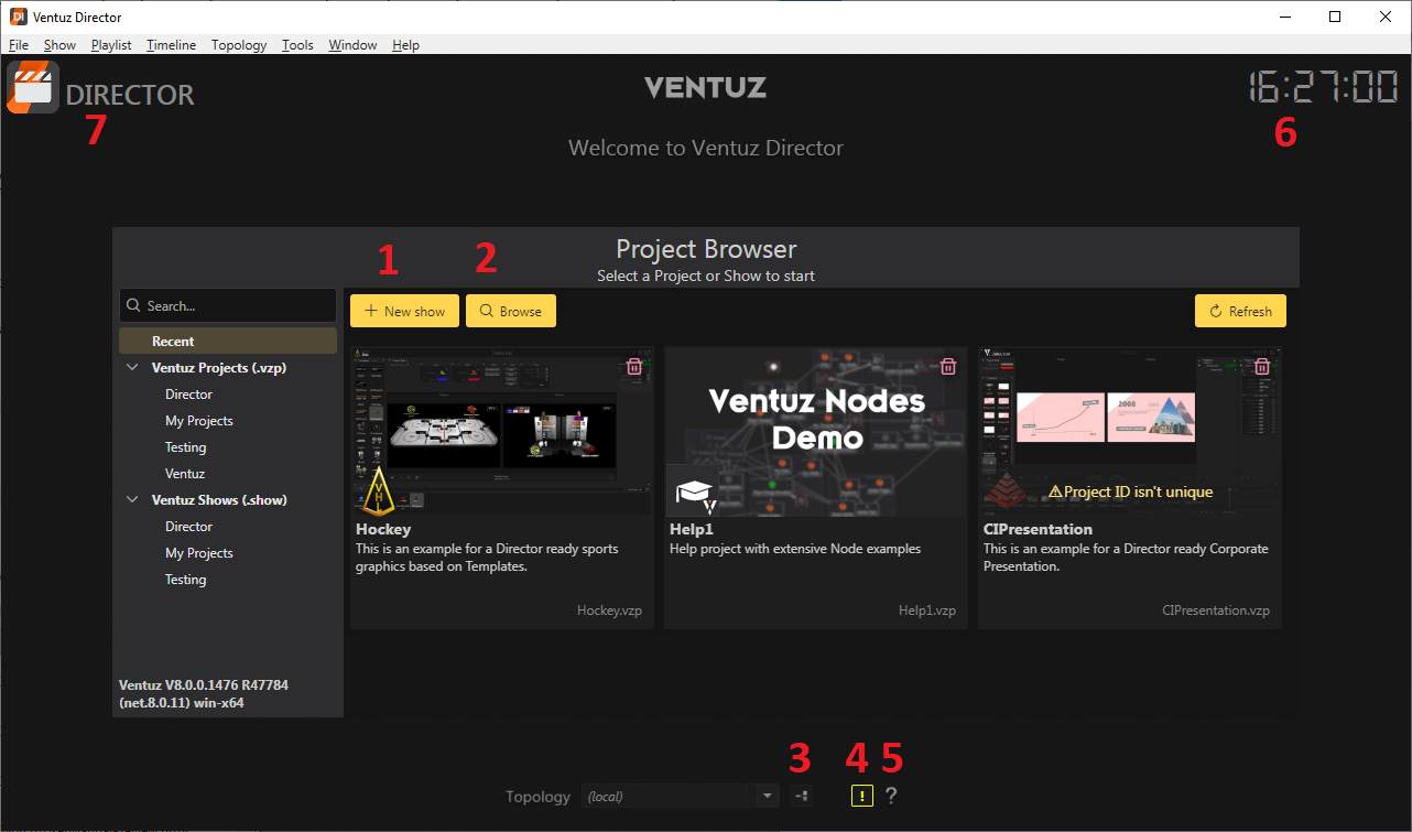

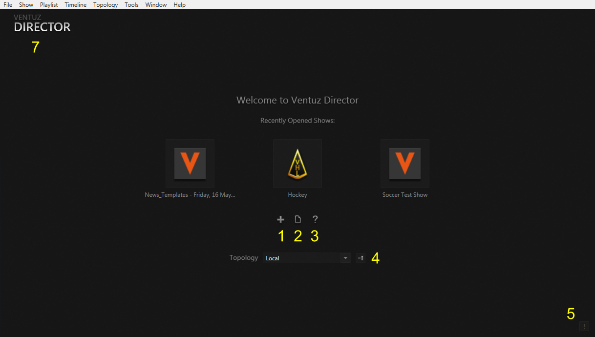

When opening up Director by selecting the Ventuz Director entry in the Windows Start menu, the first thing a user sees is an empty workspace.
The center row of three icons represent the last three shows that have been opened which may or may not contain entries depending on - of course - if there have been opened shows before at all. The workspace also contains:
  1. Create new show
  2. Browse for show
  3. Open user manual
  4. Selected Topology
  5. Log message icon
  6. System time
  7. Project icon and name
In the lower right corner is the Messages icon. Whenever an error or warning is logged, this icon will flash red or orange respectively.  Click it to open up the message window that contains the full application log.  Click it again to hide the message window.

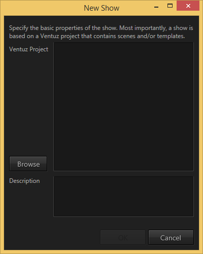

We start by creating a new Show. Go to the File/New... in the main menu bar at the top of the application or press Ctrl + N on your keyboard. A show represents a single event or occasion. A weekly news show for example would consist of one Ventuz project and a show for each week. Each show has different content, but all use the same basic setup and the same set of templates.
To create the show, simply select the project it is based on from the list of previously used projects or search for it using the Browse button. If the project has not been set up for usage in Director yet, an additional dialog will appear requesting which of the scenes available in the project should be used. This information is written back to the project file and will not have to be entered on subsequent shows.

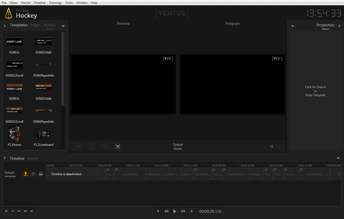

Director uses a highly configurable docking window user interface. New windows as well as additional layouts can be added/removed via the Window main menu. In this menu, you can also change the visibility of windows.
All layouts are stored in the user-settings of the local machine and can also be bundled into the Ventuz Project file. So when opening a show for a project someone else has created, the arrangement of windows may look different from the default layout shown here and some windows may have been hidden or may have been removed from the layout.
The default layout contains two render output windows, one for on-air content and one for preview, in the middle of the workspace. Arranged around them are multiple docking windows which will be discussed as needed.

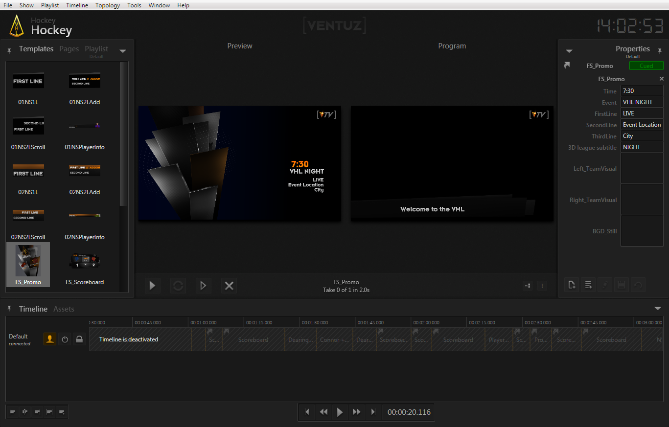

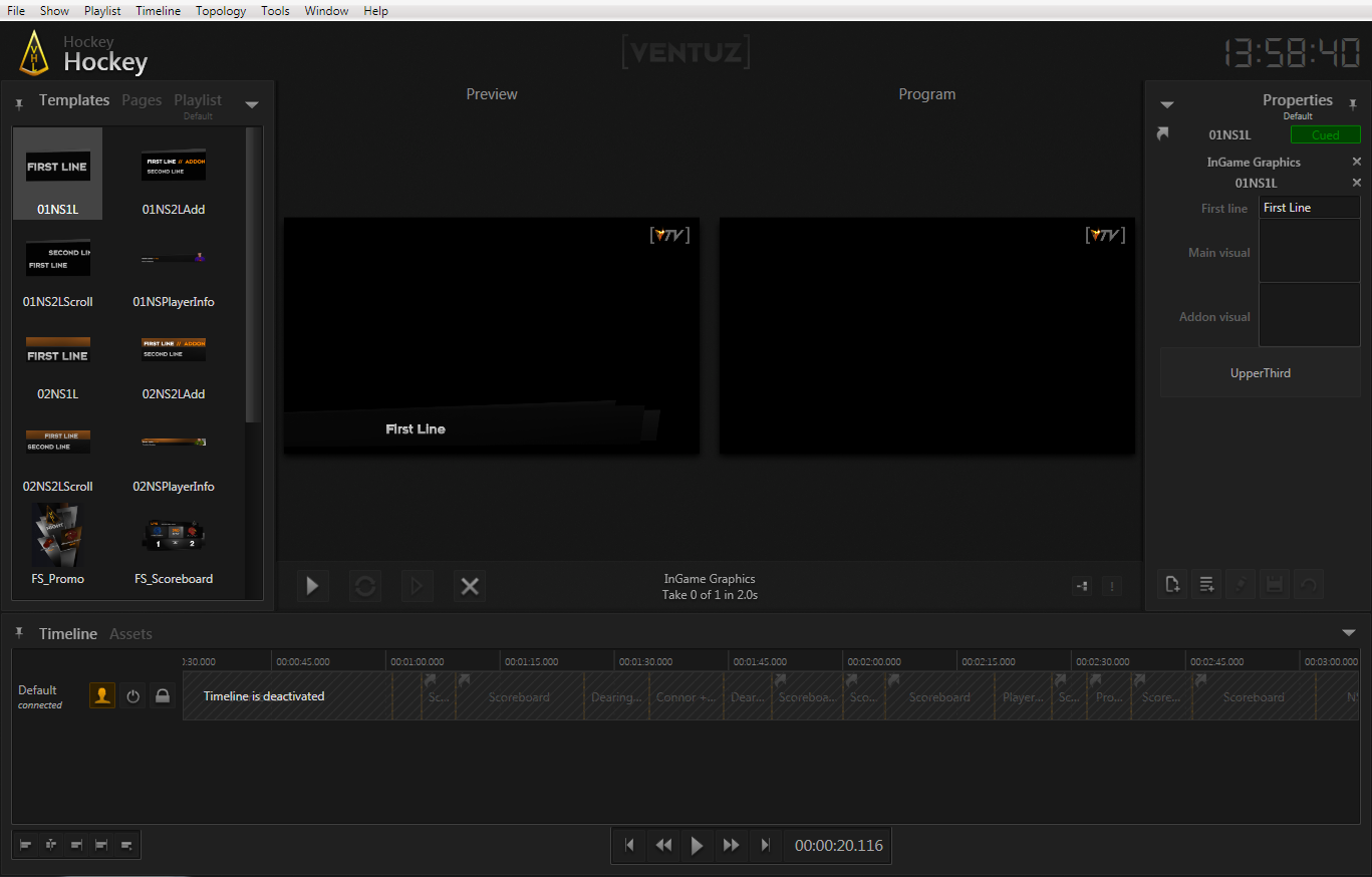

To get content on air, one first picks a template and puts it into the cue. Move the mouse to the docking window on the left labeled Templates and double- the 01NS1L thumbnail in the top left corner. Three things will happen:
  1. Director tells the Presentation Runtime to load the required scene. The first time you activate a template, this might take a few seconds depending on the size of the scene file. In the Show Control, the bar below the render outputs, the status text changes to "Loading 01NS1L".
  2. Once the scene is loaded, the Preview window in the middle of the workspace will show some dark gray bars and the text "First Line". This is how the template will look when we put it on air.
  3. The Properties docking window (right) generates controls to edit the values for that template. The 01NS1L template for example has a property called "First Line". Change the text inside the text box to "Welcome to the VHL". The preview window will update instantaneously to reflect your changes!
The fastest way to access templates is by pressing + on your keyboard's number pad. This opens the Shot Box where you can enter the first few characters of a template's name and select it from the filtered search result.

The preview is rendered internally by the Runtime but notice that it does not appear in the on-air (= Program) window. To put the template on screen, click on the Take Button on the left of the Show Control (just beneath the lower left corner of the program output window), or press F1. Again, multiple things happen:
  1. Ventuz starts playing the in-animation for the 01NS1L template and the template appears on screen.
  2. The Properties window gets cleared. The cue is ready to be used again.
  3. Cue another template, edit its values and take it. The Ventuz Template Engine inside Presenter will automatically choose the right animations to transition between the two templates.
  4. Press the Take Button without putting anything into the cue and the template goes off screen.

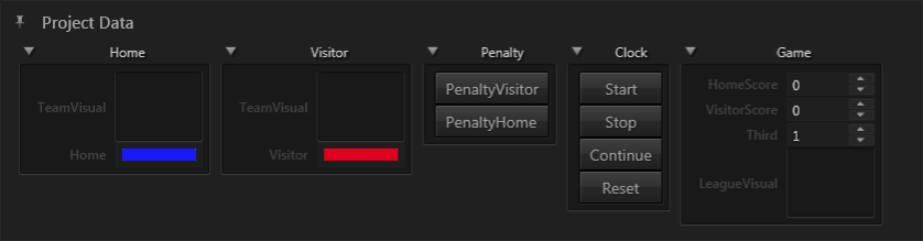

A show often has properties that are not associated with one template in particular but the show as a whole. One example would be the current score in a football match, another the name of a guest speaker in a moderated panel. Instead of adding such properties to each panel, the author of the Ventuz scenes can declare them in a dedicated space, the Project Data, and thus associate them with the project in general instead of any particular scene or template.
Open the Project Data docking window via the Window menu in the main menu bar. By default, the Project Data window opens in the right docking area as an additional tab along side the Properties window. To give it more room, -press and hold on the "Project Data" label of the docking window. Then drag it to the drop area symbol that appeared on the top of the application window (small white/blue box with a triangle in it). As soon as you hover over that icon, a preview of how the window will dock appears. Release and the Project Data window is now docked to the top of the workspace.
To see the effects of this panel, cue the FS Scoreboard template. By changing the "HomeScore" property, the score shown on the scoreboard changes. when now cueing the Scoreboard template, the same score is shown here as well.
