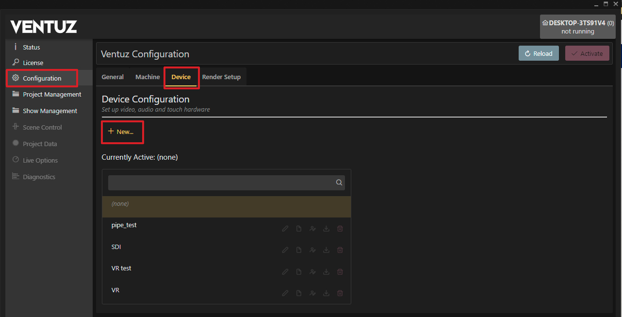

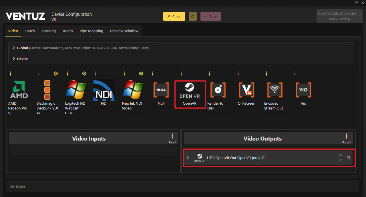

To be able to use Ventuz with any of the HMD, the HMD software must be installed and configured in their application before configuring them in Ventuz. All of the HMDs need Steam VR installed as Ventuz uses the OpenVR SDK to work.
After the necessary steps have been followed above:

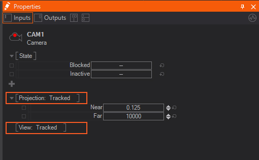

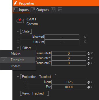

By default, Ventuz uses the HMD's tracking information. The default Camera in Ventuz will react to the HMD's movement and orientation automatically.
The Camera Node can be used to adjust settings such as Near and Far planes, to relocate the user in 3D Space or to set different offsets as required.
To use a Camera Node for VR:
From here, the Camera properties can be adjusted for the VR-Camera. The camera position is directly in the center of the scene inside of the rotating "V". The Offset of the Camera must be set for the HMD to correctly view the scene.
If an Axis Node is used in front of your 3D Scene, Specular Reflections, Cubemaps, and so on, would look incorrect.

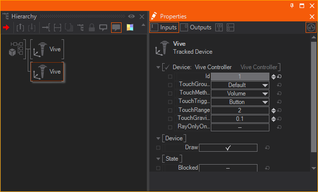

If your second controller isnt working then you probably forgot to set the ID. The left Controller is usually ID 0 and the right ID 1
By changing the Touch properties, the Touch Behavior of the controller can be changed, including the Method of the Interaction, Trigger Button, length of the Touch Ray, or the Gravity that is affecting the Parabolic Touch Ray.

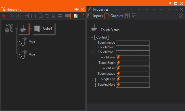

To interact with objects, an Object Based Interaction Node placed in front of the desired objects in your Hierarchy such as a Touch Button or Touch Transformation Node.

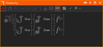

Place the Draw Vive Controller Node behind the Tracked Vive Controller Node
A Draw Touch Ray Node draws a Ray from the controller(s).
Use the same Id as the desired controller.
A Material can be placed in front of this node to customize its appearance.
