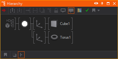

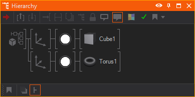

The following basic examples show two different possibilities to build scene trees in the Hierarchy Editor which result in exactly the same rendered output, but are different in terms of performance.
The first hierarchy applies a separate Color node to each geometry. Duplication of nodes performing the same task will come with a cost to performance. A more efficient way to build such a scene is shown below.

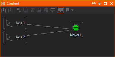

The same principle applies to Content nodes which provide values or resources to Hierarchy nodes. If an Axis node receives values from a Mover and the Axis is copied normally, the Mover will be copied as well. But if the parameters of the second Mover remain the same, it is dispensable because the second Axis could receive its values from the first mover:
In such cases do not use the regular copy [CTRL+C, CTRL+V] but the so called reference copy, as described in section Moving and Copying, to decrease the time it takes to build the hierarchy. This will save memory and speed up validation time.

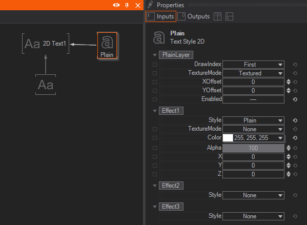

If you have to render lot of rather small sized text there is a trick to drastically increase the text rendering performance: specify a Text Style 2D where the PlainLayer is disabled and the first Effect layer is set to Plain like in the image below:
This will change the text rendering technique to a mode where not every single character generates an own render command but the whole text is processed by a single render command.

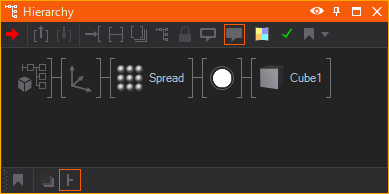

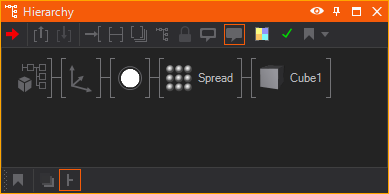

There are two very important points that have to be considered with the use of the Spread nodes. Disregard may cause critical performance penalties. The first point concerns the tree in the Hierarchy Editor. The Spread node duplicates every subtree that is linked to it. To avoid unnecessary duplication of nodes, the subtree should be reduced as far as possible. The following screen-shots show a bad and a correct use of the Spread node.
In the first version not only the Cube is duplicated but also the Color node. This is unnecessary because the Spread node does not affect the Color node. All duplicated copies remain the same. This way every copy of the Cube node creates one more unnecessary node which only consumes memory and reduces the scene performance. The correct use of the Spread is shown below. Only the Cube is duplicated because the Color is applied to any copy of the Cube anyway.
The second important point for the use of the Spread is the adjustment of the Max and Count properties. The property Max determines the overall number of possible copies. This property is not linkable. Therefore the value can only be set manually by the user. The reason for this is, that it is not possible to calculate the internal data structures of the Spread node for high number of copies in real-time. The property Count defines the number of visible copies. This property can only have a value that is smaller or equal the Max value. Unlike Max the property Count can be linked and animated. To achieve the best performance, the value for Max should be as low as possible. If Count is needed in the range between 10 and 20, than Max should be set to 20.
