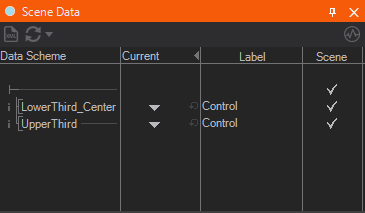

The second point is achieved by simply adding the animation's control property to the scene's Scene Data. If using the scene's Main Animation, you will need to change its control type to Template via the icon in the top left of the animation window. This will add the Main Animation's control property to the Scene Data and will therefore function the same as if you had used a Keyframe Animation Node. When importing a scene into Ventuz Director the scene's Data Model will be scanned for all animations and then entries will be created in the Template Browser for each present state found.

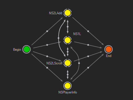

In the example shown above, there would be four templates visible inside Director: NS1L, NS2LAdd, NS2LScroll and NSPlayerInfo.

Note that each transition can be valid in either one of its two directions or both directions at the same time. In the example above, there is a transition from NS2LAdd to NS1L that works in both directions. If one is currently active and then replaced by the other, that special transition is used instead of going to End and then returning to the Begin state again. On the other hand, the template engine cannot go from NS2LAdd to NS2LScroll via Begin as the transition from NS2LAdd to Begin is not valid in that direction. The direction of a transition can be changed by selecting a transition and pressing R.
Pressing the R-key will have no effect and no arrow heads will be drawn on transitions unless the animation is part of the Scene Data.
If there are multiple possible routes, the Template Engine always chooses the shortest route possible based on the number of transitions that have to be traveled along. The actual duration of a transition is not part of this criteria.

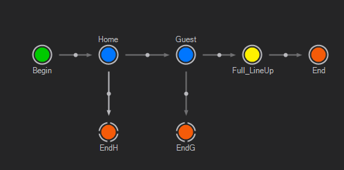

As mentioned in the Routing section, Templates can be designed to have multiple takes. To achieve this, add States of the type Normal (N) on the route to the Present State. Each of these represents one take. Assuming a line-up for a team sports match should be designed. At the first take the home team should be shown, at the second take the guest team and at the third take both teams at once. The State Logic for this example could look like the image below:
Adding additional End States to the State Logic gives the possibility to add animation paths to take the Template off air with a defined animation from any State.

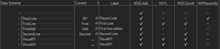

To add data that can be edited as part of a template, switch to the Data View inside the Animation Editor. Similar to Animation Channels, any property can be made accessible to a template by simply dragging it from the Property Editor to the Data View to create a new Data Channel. A yellow dot appears next to the property in the property editor to visualize this is now bound to the Animation Data of some Keyframe Animation node.
Since there is one set of data channels for all states in an animation, this data needs to be manually associated with the specific states for which they belong. For example, if one state shows only one line of text and another has an additional line of text for a sub-title, the sub-title data should not appear as a data entry field inside Director when the first template is cued. This is done by toggling the check marks in a states column inside the Data View. In the image above, as an example, the ReqCode data channel is only valid for the NSPlayerInfo state/template.

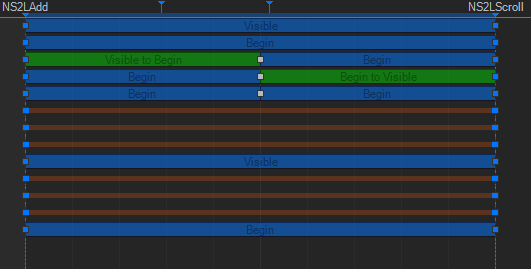

Transition points are useful for choosing when in the animation to update the data when two templates share the same data channel.
Imagine the first template currently being active, and the operator cues the second template and then changes the value in the common data field. What happens when the operator does a take? At which time does the data channel switch from the old to its new value? The default behavior is that the new value is immediately applied which might or might not be what the designer intended to happen. Usually a designer will want text to gracefully transition in instead of the text suddenly changing. There may be a need to hold the old value before switching to the updated one. That period of time can be defined by one or more transition points along a transition curve by pressing M in the Time View.
When a transition is performed, the Template Engine checks if there are any transition points:
  • If there is no transition point, the values of all data channels are immediately updated.
  • If there are transitions points in the animation, the values are updated once the first transition point has been passed.
Why would you need there to be more than one transition point along a transition? This is useful when the transition might be valid in both directions (see the section on Rounting) and the point of update might not be the same in both directions. Especially if the update requires resources (e.g. images) to be loaded, it should be triggered as soon as possible to allow the machine as much time as possible to load the assets before the animation makes the new values visible to the user. For example, the new image can start being loaded while the current image is still fading out.
