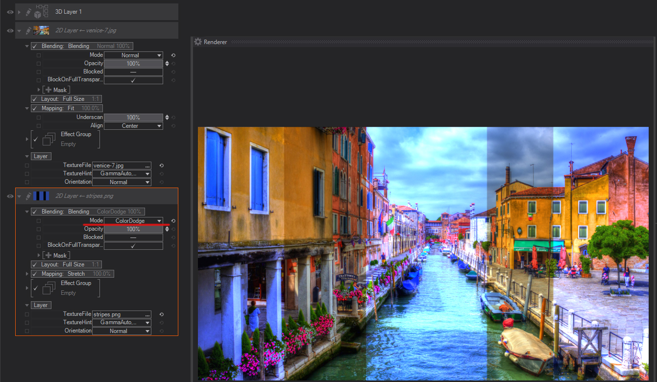

All layers in Ventuz feature certain properties to control how layers are sized, composited, used masks, applied effects and so on, regardless if they are 2D, 3D or other types of layers. You can find an in-depth description of all these options on this page, for references about the different types of layers in Ventuz and their specific properties, check 2D Layers, 3D Layers and Other layers.
Blending operations, including modes, opacity and masking, can be switched ON or OFF for each individual layer by left-clicking close to the Blending caption. If the check mark appears, the blending operation, including opacity, mode and mask, is calculated for the current layer. If the check mark does not appear in front of the Blending options, the blending operations are not calculated.
As with all Layer Properties, in order to expand the Blending Options, click on the little arrow. A dropdown list of the supported blending modes will appear:

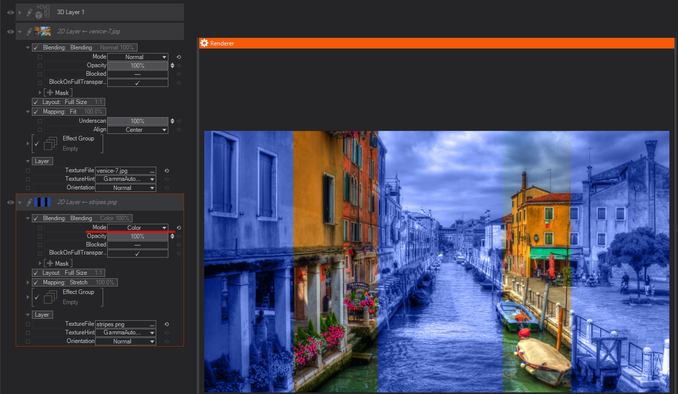

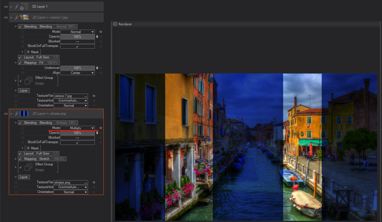

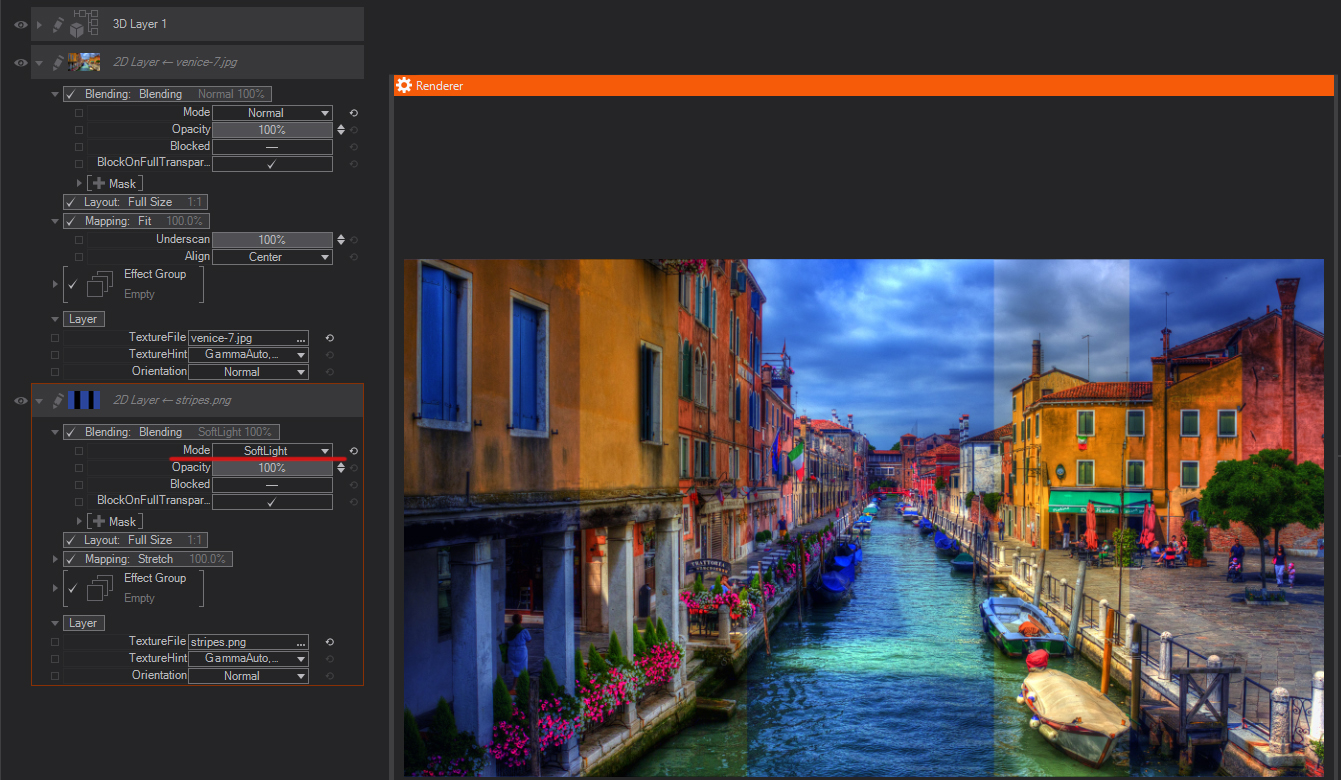

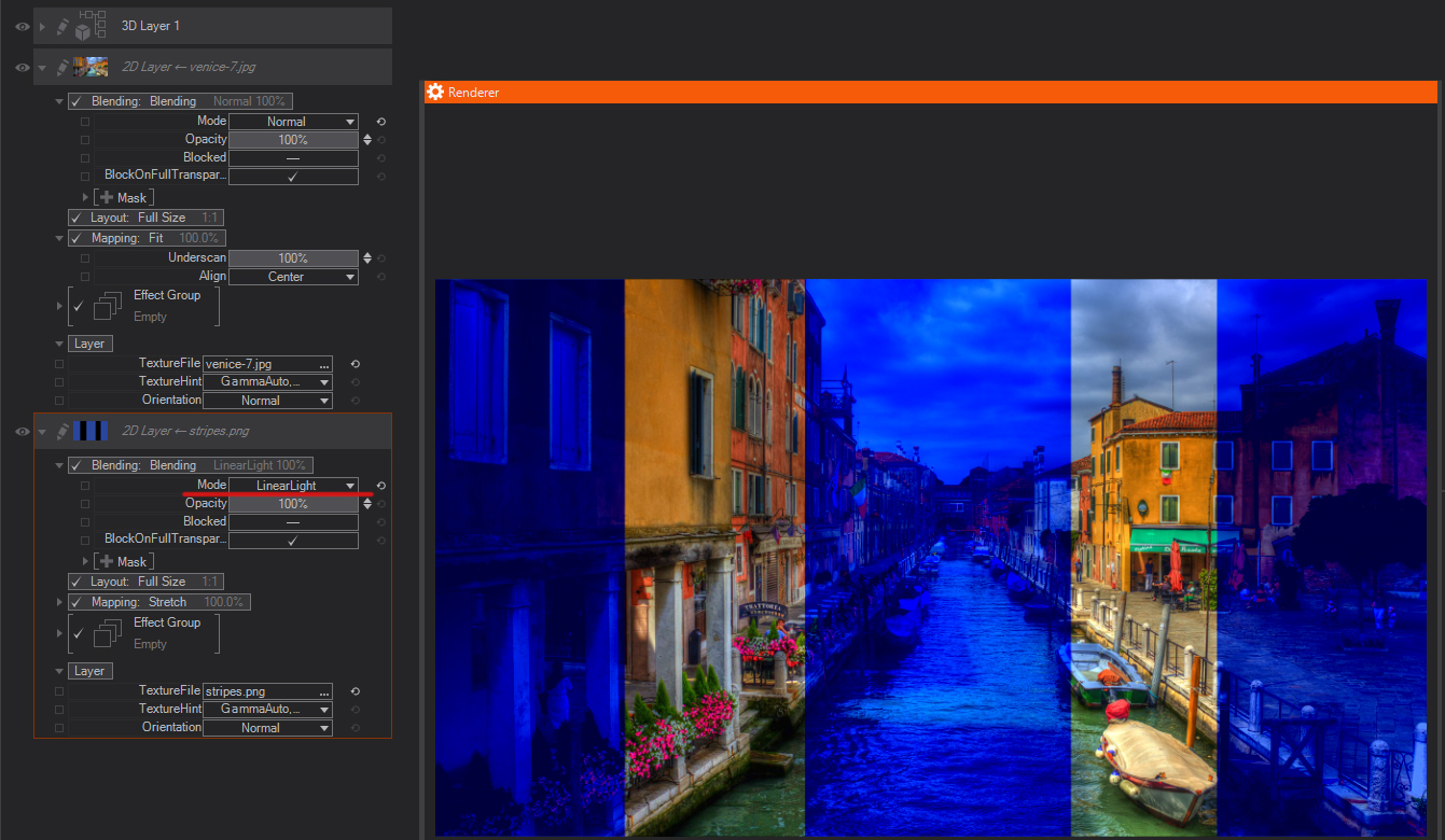

With the Blending Modes you control how the pixel values of the current layer are combined with those of the layers rendered before, i.e. the layers which are above the current layer. The bottom one is always in front of the rest.
Normal: The default Blending mode. When selected, only Layer Opacity settings are taken into account to composite the layer.

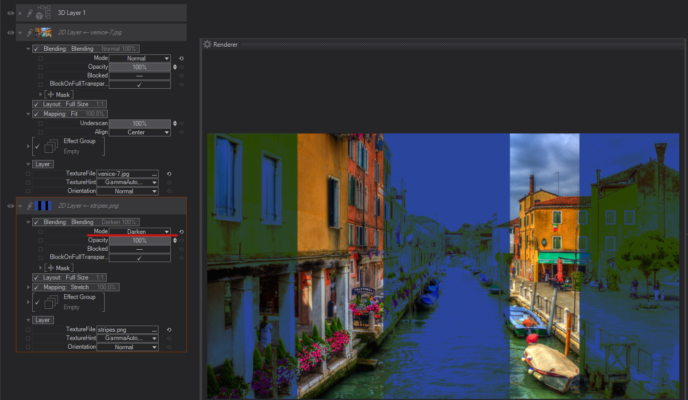

Darken: Compares the color information in both the current and the layer below and selects the darker pixels. Pixels lighter than the blend color are replaced, and pixels darker than the blend color do not change.
Multiply: Checks the color information and multiplies its values in both the upper foreground and the background layer. The resulting color is always a darker color. Multiplying any color with black produces black. Multiplying any color with white leaves the color unchanged. When you’re blending with a color other than black or white, successive blends produce progressively darker colors. The effect is similar to drawing on the image with multiple marking pens.
Color Burn: Looks at the color information in each channel and darkens the base color to reflect the blend color by increasing the contrast between the two. Blending with white produces no change.
Linear Burn: Looks at the color information in each channel and darkens the base color to reflect the blend color by decreasing the brightness. Blending with white produces no change.
Darker Color: Compares the total of all channel values for the blend and base color and displays the lower value color. Darker Color does not produce a third color, which can result from the Darken blend because it chooses the lowest channel values from both the base and the blend color to create the resulting color.
Lighten: Looks at the color information in each channel and selects the base or blend color —whichever is lighter— as the resulting color. Pixels darker than the blend color are replaced, and pixels lighter than the blend color do not change.

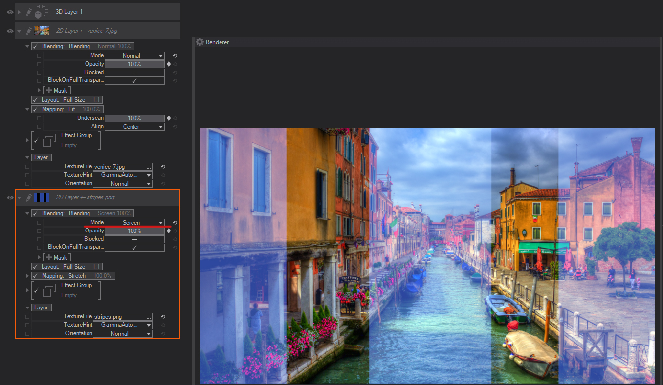

Screen: Looks at each channel’s color information and multiplies the inverse of the blend and base colors. The resulting color is always a lighter color. Screening with black leaves the color unchanged. Screening with white produces white. The effect is similar to projecting multiple photographic slides on top of each other.
Color Dodge: Looks at the color information in each channel and brightens the base color to reflect the blend color by decreasing contrast between the two. Blending with black produces no change.
Linear Dodge (Add): Looks at the color information in each channel and brightens the base color to reflect the blend color by decreasing contrast between the two. Blending with black produces no change.
Lighter Color: Compares the total of all channel values for the blend and base color and displays the higher value color. Lighter Color does not produce a third color, which can result from the Lighten blend because it chooses the highest channel values from both the base and blend color to create the resulting color.
Overlay: Multiplies or screens the colors, depending on the base color. Patterns or color overlays the existing pixels while preserving the highlights and shadows of the base color. The base color is not replaced but mixed with the blending color to reflect the lightness or darkness of the original color.
Soft Light: Darkens or lightens the colors, depending on the blending color. The effect is similar to shining a diffused spotlight on the image. If the blend color (light source) is lighter than 50% gray, the image is lightened as if it were dodged. If the blend color is darker than 50% gray, the image is darkened as if it were burned in. Blending with pure black or white produces a distinctly darker or lighter area, but does not result in pure black or white.
Hard Light: Multiplies or screens the colors, depending on the blending color. The effect is similar to shining a harsh spotlight on the image. If the blend color (light source) is lighter than 50% gray, the image is lightened, as if it were screened. This is useful for adding highlights to an image. If the blend color is darker than 50% gray, the image is darkened, as if it were multiplied. This is useful for adding shadows to an image. Blending with pure black or white results in pure black or white.
Vivid Light: Burns or dodges the colors by increasing or decreasing the contrast, depending on the blend color. If the blend color (light source) is lighter than 50% gray, the image is lightened by decreasing the contrast. If the blend color is darker than 50% gray, the image is darkened by increasing the contrast.

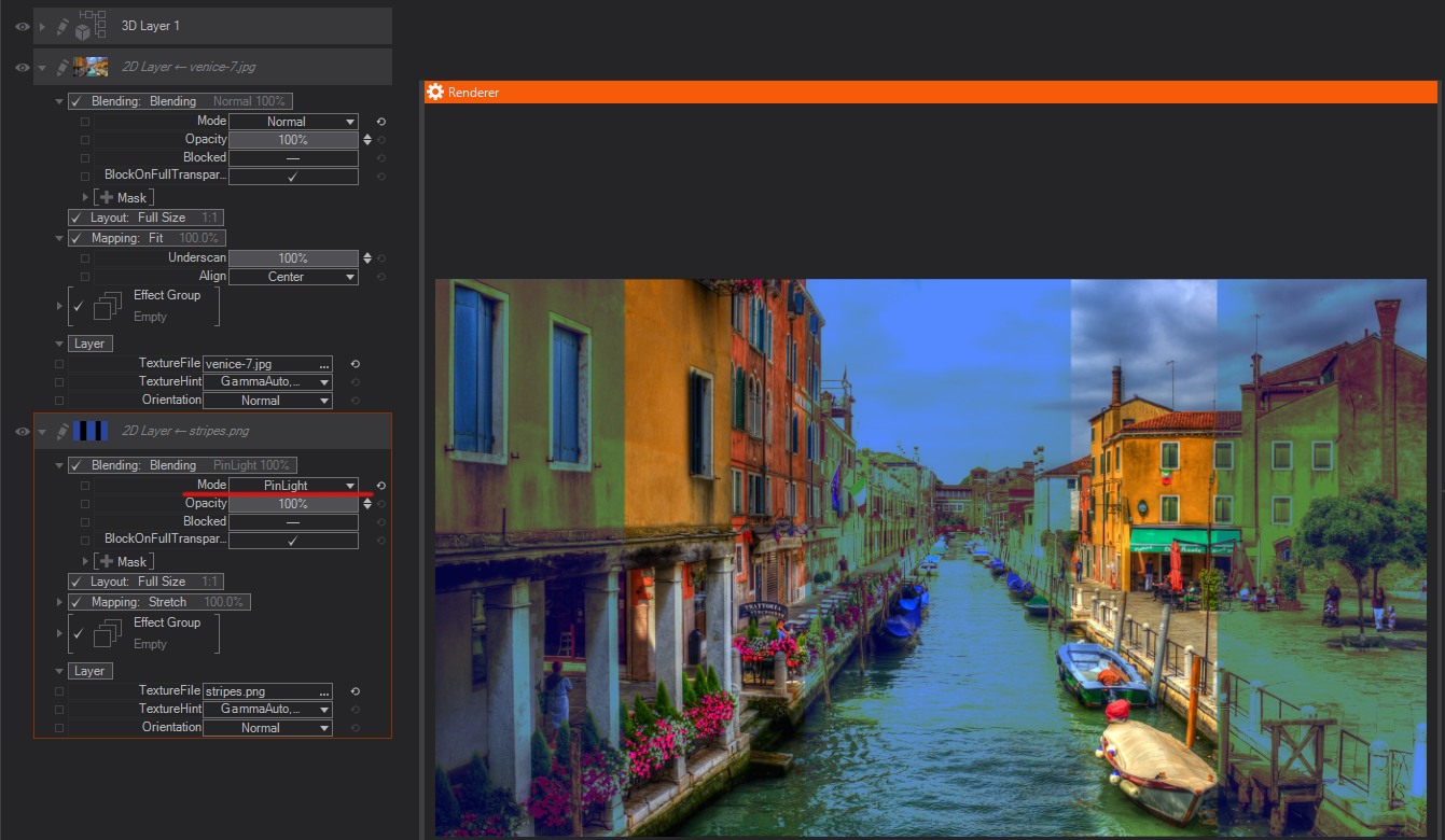

Pin Light: Replaces the colors, depending on the blend color. If the blend color (light source) is lighter than 50% gray, pixels darker than the blend color are replaced, and pixels lighter than the blend color do not change. If the blend color is darker than 50% gray, pixels lighter than the blend color are replaced, and pixels darker than the blend color do not change. This is useful for adding special effects to an image.

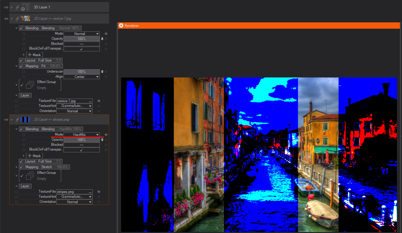

Hard Mix: Adds the red, green and blue channel values of the blend color to the RGB values of the base color. If the resulting sum for a channel is 255 or greater, it receives a value of 255; if less than 255, a value of 0. Therefore, all blended pixels have red, green, and blue channel values of either 0 or 255. This changes all pixels to primary additive colors (red, green, or blue), white, or black.

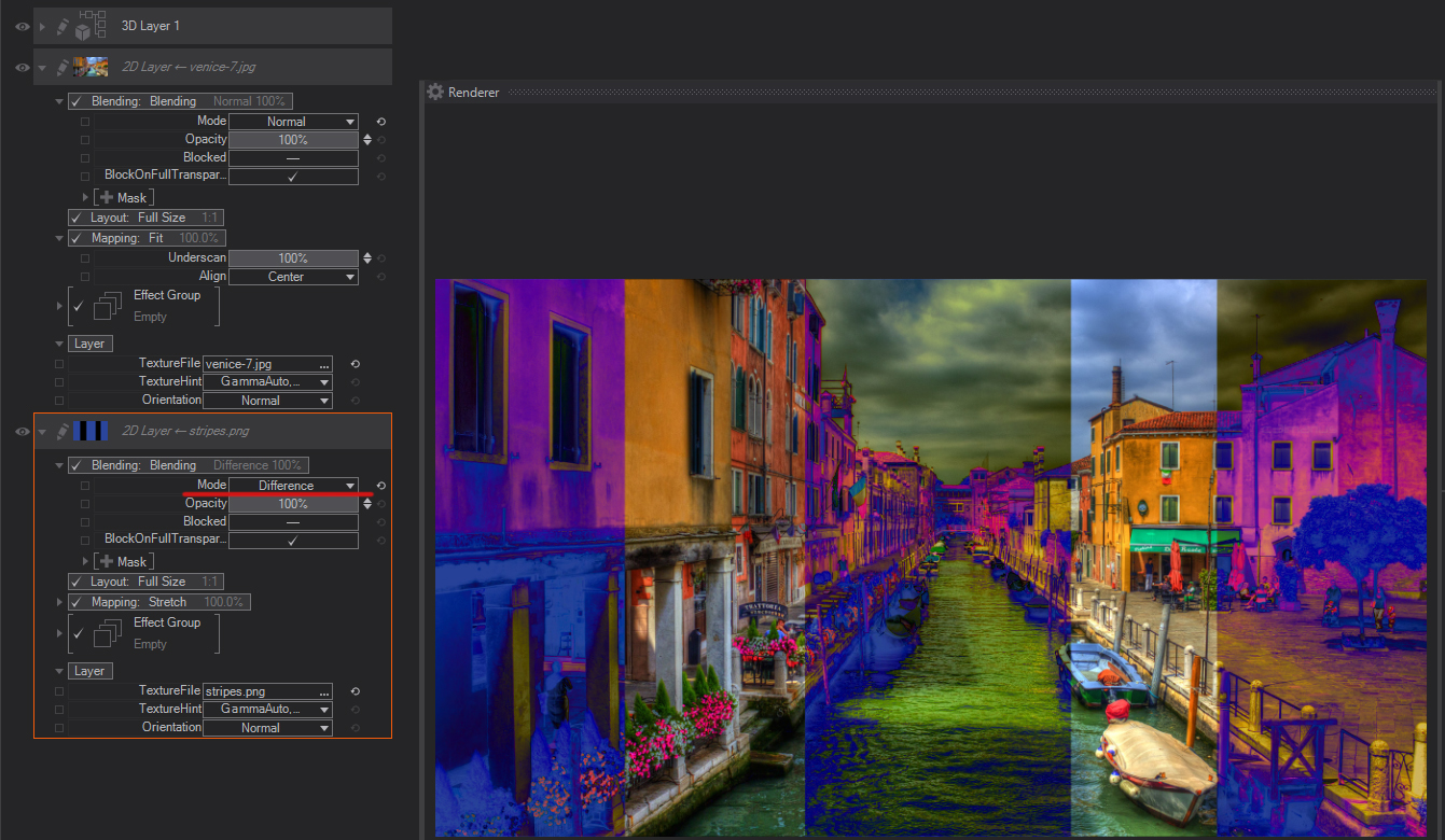

Difference: Looks at the color information in each channel and subtracts either the blend color from the base color or the base color from the blend color, depending on which has the greater brightness value. Blending with white inverts the base color values; blending with black produces no change.

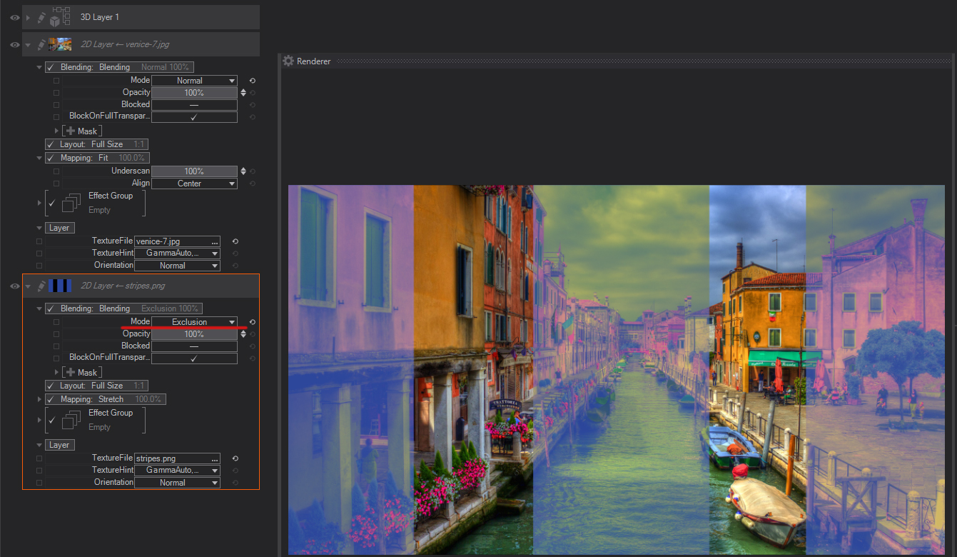

Exclusion: Creates an effect similar to but lower in contrast than the Difference mode. Blending with white inverts the base color values. Blending with black produces no change.
Subtract: Looks at the color information in each channel and subtracts the blend color from the base color. In 8- and 16-bit images, any resulting negative values are clipped to zero.
Divide: Looks at the color information in each channel and divides the blend color from the base color.
Hue: Keeps the Hue of the layer, and blends the luminance and saturation of the underlying layers (you basically get the image from the lower layer with the colors of the top layer).
Saturation: Keeps the saturation of the layer, and blends the luminosity and hue from the underlying layers—where colors from the active layer are saturated, they will appear using the luminosity and hue from the underlying layers.
Color: Keeps the color of the layer, and blends the hue and saturation (the color) of the active layer with the luminance of the lower layers.
Luminosity: Keeps the luminance of the layer, and blends it with hue and saturation of the layers below.
Linear Light: Uses a combination of the Linear Dodge blend mode on the lighter pixels, and the Linear Burn blend mode on the darker pixels.
Pass Through: Is the default Blend Mode for Layer Groups. It allows any adjustments to layers inside the group to affect layers below it. Ventuz takes all the layers inside the Group and performs the blending operations in the usual order - if you change this mode you are basically changing the order in which the layers are processed - all layers inside the group are blended first and the resulting composite is blended with the layers below with the selected blending mode for the group.
Blend mode Pass Trough applies only to Layer Groups!

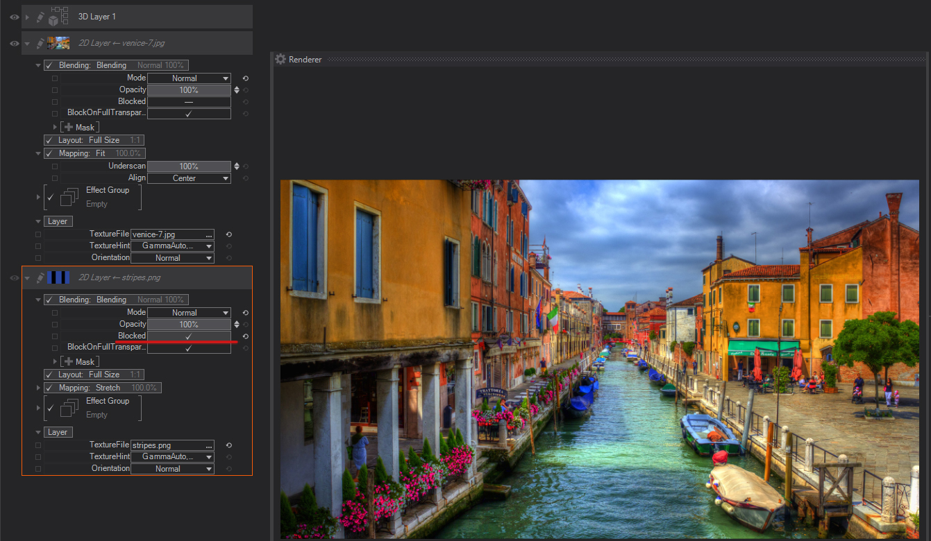

This checkbox controls if the Layer Blending mode operation is performed or not, the main difference with switching OFF Blending operations is that the property can be bound in the Content Editor, and therefore can be used to optimize performance in complex scenes.
This checkbox is used to optimize layer performance when animating Layer Opacity, if opacity is set to 0%, and is, therefore, invisible, Ventuz will minimize any calculations pertaining to this layer to improve performance. If you Uncheck BlockedOnFullTransparency to still have touch interactions possible. For instance, you could have a Transparent 2D Layer which shrunk in size and can still send touch information.

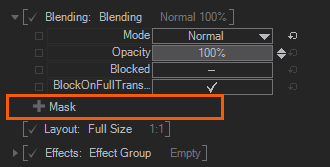

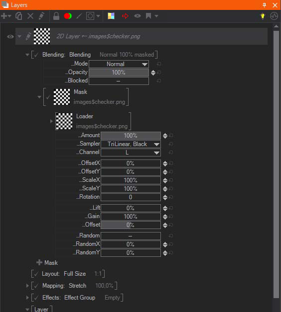

Layer Masks allow isolating certain parts of the layer to be used for the final composite. In general, Masks use the color or alpha information to decide which image pixels will be transparent, translucent or opaque.
Ventuz features three type of masks by default: Mask, Vignette and Border. You can add as many MaskStages as you want.
You add a LayerMask if you click Click on the [+] Mask like shown on the Screenshot, and select Mask or any type of Mask Vignette / Mask Border from the dropdown menu.
Mask Property uses a texture source as the mask. When adding a mask, a new thumbnail will show the Mask appearance. Click on the Mask or click the triangle in the front to bring up the properties for the selected Layer Mask.

For any of the above loaders, you can adjust the Amount which controls the Mask Opacity, the Sampler where you can select the filtering to be Trilinear and Adress the Border behavior. Click the Sampler and the Dropdown Menu offers you following Options for the Border Behavior:
Black: The pixels outside the area covered by the mask are turned black, meaning that there is no tiling.
White: The pixels outside the area covered by the mask are turned white, meaning that the area outside the original mask image is totally opaque.
Clamp: The pixels outside the area covered by the mask will repeat endlessly the same values as the pixels in the original image borders.
Wrap: The pixels outside the area covered by the mask are repeated or tiled as they were in the original mask image.
Mirror: The pixels outside the area covered by the mask are repeated or tiled as they were in the original mask image, but inverted like a mirror effect.
With the Channel Drop Down Menu you can select which channel should be taken for masking. The Luma (L) is the default and uses the external image Luminance as a mask, it converts the image internally into a Grayscale Image. You can select an explicit channel like R,G,B or take the Alpha as the Making source. With the Invert the source image or selected channel gets inverted.
You can Offset X/Y, Scale X/Y and change the Rotation of the mask. New pixel values are interpolated using the options selected in the Sampler dropdown menu.
The Lift, Gain and Offset can be used to do a color grading for the Mask. The values are conformed with the Standards used in the cinematography. Lift can lift up the lower colors, while it clamps also the lower color area. E.g. if you lift a dark image, lower colors gets cut off, instead of starting at 0-255, it will start with 30-255. Gain boosts the colors in the whole range, while bright pixels may also clip at 255. Offset moves the colors in respect to each other color values. It behaves like a shifting.
Random will position the Image randomly on screen and the amount of this randomness can be controlled with the Random X/Y. The Image will be positioned to a different position for every Tick, therefore you can not control the speed.

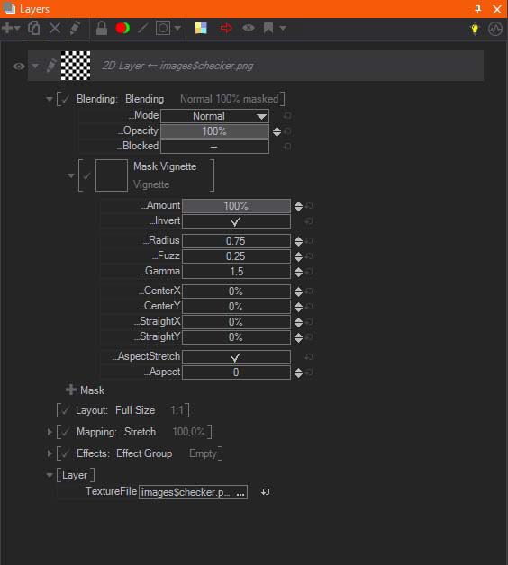

Mask Vignette can be used to darken the corners of the Layer. You can control the Radius and Fuzz to change the appearance of the vignette. Fuzz will change the blending between the dark vignette and the visible area. You can reposition with the Center X/Y values and also use Straight X/Y to change the shape of the vignette. The Straight can be used to shape the circle like vignette to a rounded rectangular shape. With the AspectStretch and Aspect value you squeeze or stretch the vignette.
Horizontal Vignette and Vertical Vignette offer the same controls as the Standard Mask. They are more like presets and have just the properties adjusted, so that either a Horizontal- or Vertical Vignette appears. The adjusted Values, in this case, are Radius, Fuzz and depending on Straight X or Straight Y.

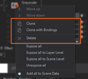

For effect stages you can clone or clone with bindings.To do so Hold Right Click Hold on an effect stage for a second and a menu with these options will show up.
You can collapse or unfold effect properties by simply Right Click click an effect stage.

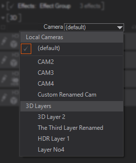

With this drop-down menu you can assign the actual Camera. The options are Local Camera default and all other Cameras available in the actual Selected Layer, if available, other 3D Layers cameras will be listed here - Right under 3D Layers as shown on the screenshot. It is a very powerful feature of Ventuz to use an existing camera from another 3D layer as the actual camera for the selected layer. Whenever you control, change the position or orientation of the assigned camera, the changes will be applied to the 3d layer, where you assigned the camera to.

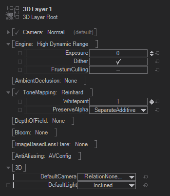

There are several properties available on the 3D Layer Root when using the Standard Render Engine, HDR engine specific properties will be explained at the end of this section.

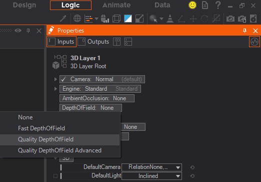

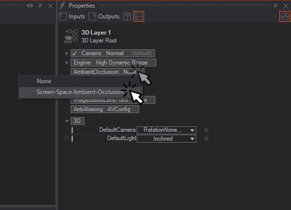

In order to access the different render modes, click on the Layer Root that appears in the Hierarchy Editor of every 3D Layer. This layer root holds all the render properties of each of the available render mode.
Keep in mind to unfold or open the properties by right clicking on the properties or click the small triangle in front of the properties.

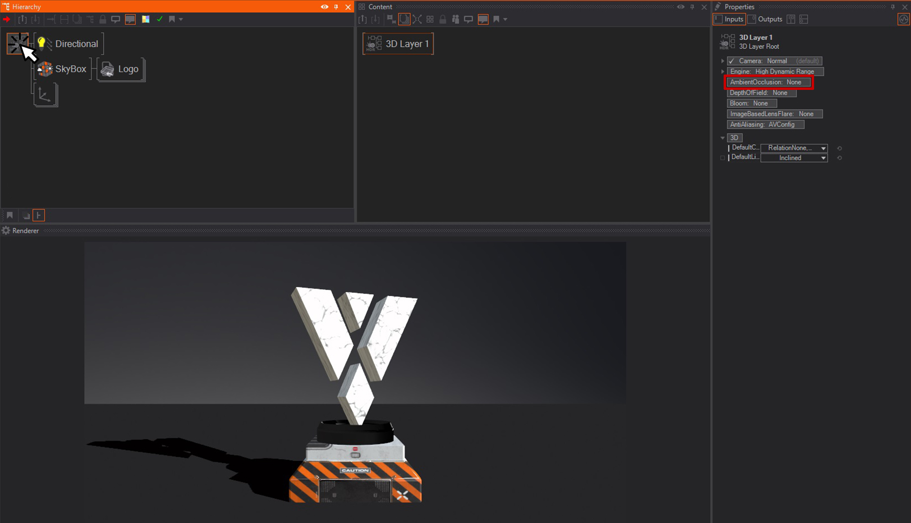

The Ventuz engine features some 3D capabilities with effects that cannot be calculated in post-processing because they need to take the 3D information of the scene into account. The available effects are:

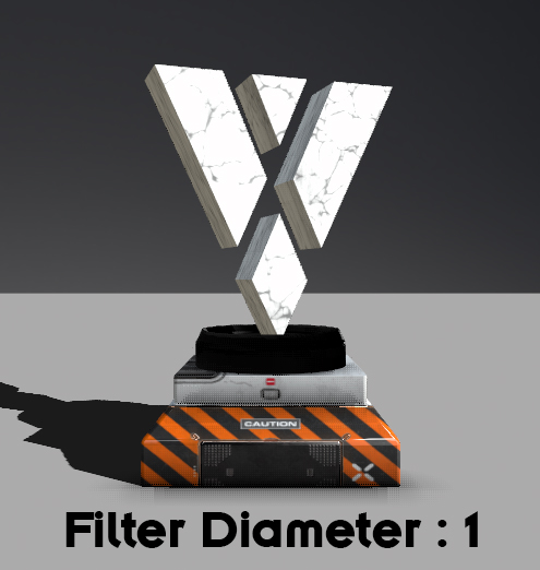

This enables the Screen-Space Ambient-Occlusion, which is a term for various techniques that try to create the effect of ambient occlusion by looking at the depth-buffer and the normals of all objects on screen and pixel by pixel. All screen-space techniques have the disadvantage that they can't react to stuff that is out of the screen, and they can't handle transparencies, because per pixel on the screen there is only information for the top-most polygon. The specific implementation of SSAO chosen for works like this:
For every pixel on the screen (the center), we want to know within a given radius the percentage of pixels before the center. Before means before the plane created by the center position and normal. We can't test every pixel, so we cast a few rays from the center (in 2d), as far as the radius (converted from 3D to 2D screen pixels). For each ray, a couple of equal-distance steps are taken to see if the center is occluded. If a wall is hit, the steps are defined in a binary fashion to narrow down the precise position of the first pixel that occludes the center.

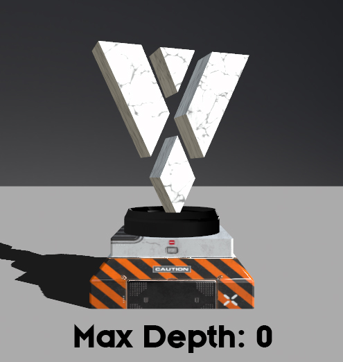

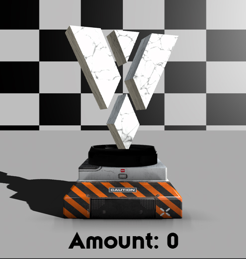

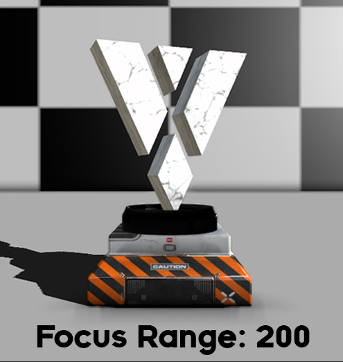

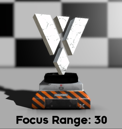

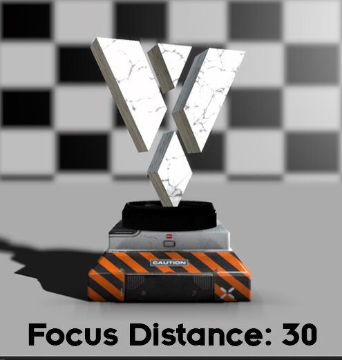

This enables the Depth of Field effect, an effect that is often used in filmmaking and uses the blurriness of the out of focus elements in the scene to drive viewer's attention to certain parts of the image. The options are None, Fast Depth of Field and Quality Depth of Field - the latter is available in two versions, one with simple settings and one with advanced settings similar to the Fast Depth of Field. Simple Depth of Field is a relatively fast method of calculating DoF, but it comes with a drawback: The quality is very much dependent on proper settings. At this point in time, it mostly is used in small amounts to add realism to 3D scenes. The Quality Depth of Field uses up more perfomance but is easier to control, especially the non-advanced version of it.
Common Properties:
This lists all properties that are present on all types of Depth of Field shaders:
Instead of an enumeration you can control the Sampling Quality of the Quality Depth of Field using a floating point number between 0 and 1. The effect of the property stays the same.

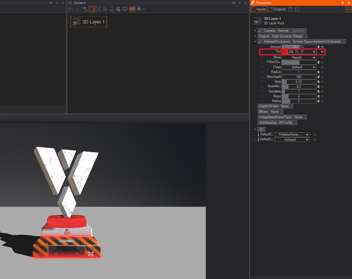

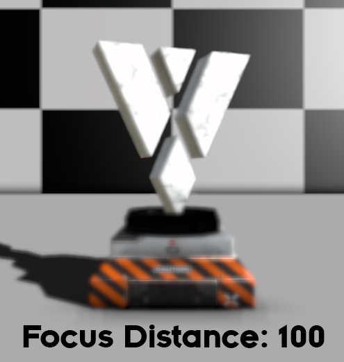

Quality DoF:
This lists all properties on the simple Quality Depth of Field:
Fast and Quality Advanced DoF:
Following is a list of the common properties of Fast Depth of Field and Quality Depth of Field Advanced:

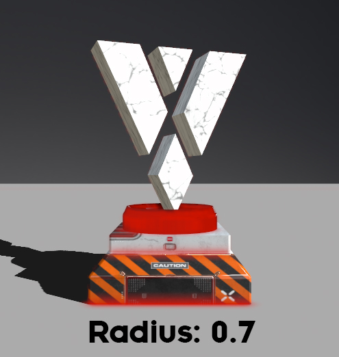

A Bloom effect is similar to a Glare IPP effect but with two differences: it takes into account the 3D information of the objects and it is processed in 16-bits. These are the properties available:

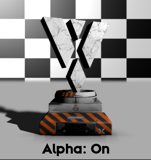

The term generally refers to the process of removing jagged edges of objects. They may appear because of the limited raster of pixels on the render output. There are several techniques to reduce the aliasing, like Multi Sampling or Fast Approximate Anti Aliasing. For more information see the different sampling methods we support in Ventuz that are explained in detail here.

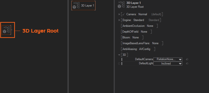

On the 3D Layer Root, you can change the Anti-Aliasing either to use the configured options of the Device Configuration or to use a dedicated sampling method.
The MSAA (Multi Sampling Anti Aliasing) method has an option FixSeams to smooth alpha edges if they seem jagged even with Anti Aliasing turned on in non-HDR layers. More information can be found on the Anti Aliasing reference page. Consider using the FXAA on the respective layer instead of MSAA with fixed seams since this will save performance.

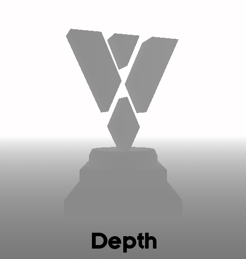

The Depth Keyer can be used to key out certain portions of the rendering of the 3D Layer based on the the depth. This is useful if you need to feed in any kind of image that has no alpha yet you need to composite it in your scene. An example for such images is the texture coming from the Unreal Live Link.
The Depth defines the threshold of this keyer: everything behind this threshold is keyed out, while everything in front is left in the rendering as it is. When Apply to Fill is disabled the keyer applies to the layer's alpha channel only and leaves its color channels as they are. This is useful for Augmented Reality setups with any sorts of external chroma keying. Show offers debug visuals to get an idea of what is happening inside the shader. You can see the resulting Key as well as the scene's depth. Softness, Choke and Edge Softness work in the same way as the according properties on the Color Difference Keyer Layer Effect. When Enable Anti Alias is turned on, the effect will have aliased edges to smooth out the Alpha. With this disabled, the resulting key is either 0 or 1 - an FXAA algorithm is used to fade this smoothly when its enabled. The Fxaa Sub Pixel property changes this algorithm's parameter as described in the Anti Aliasing reference page.

This section describes working with a HDR layer in a SDR workflow, when the HDR flag is not set in the Project Properties.

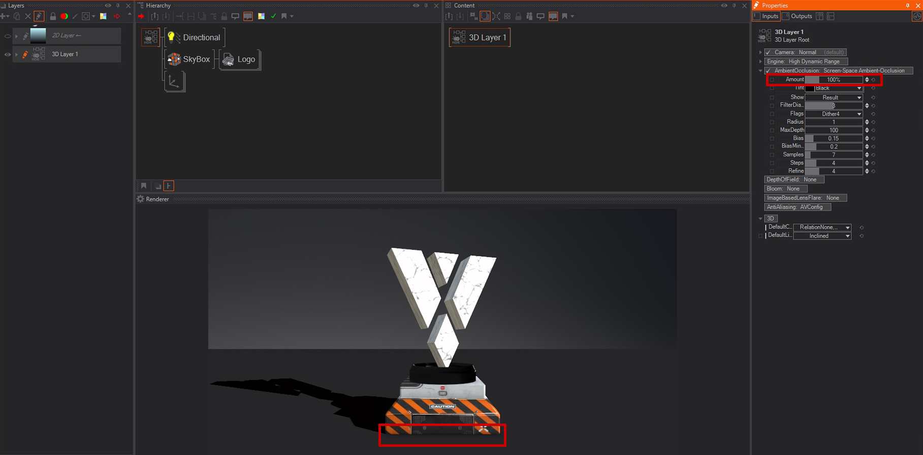

With the Engine drop-down menu you can switch to High Dynamic Range. If you are working with the HDR Engine the 3D Layer Root will show different properties than for the Standard Engine. The Engine will then switch internally into a 16bit floating point precision which makes it possible to make proper use of real HDRi's (High Dynamic Range images).
You will mostly notice an advantage working in HDR when using real HDRi's or especially when working with the IPP-Effects like Bloom and Image based Lensflares. These Effects will then work properly since real bright pixels are available for sampling and applying the named effects.
Unfold or Right Click the Engine property to show HDR specific properties. You can adjust the Exposure level then, which is basically the same like with a real photo camera. High Exposure (plus values) settings will let more light into the camera lens and the scene looks brighter. Low Exposure (minus values) will let less light travel trough the camera lens, the scene will be darkened. Since we are working in 16f it is now possible to reduce the color banding by enabling the Dither. FrustumCulling works the same way as in the Standard Engine mode.
Another Property group called ToneMapping is now available. In the drop-down menu you can switch between Reinhard, Linear and Filmic tonemapping. The default Reinhard tone mapping lets you adjust the Whitepoint which sets the luminance level to use as the upper end of a tone mapping curve. The Whitepoint is mostly adjusted by artists to create a more colorful result. Linear and Filmic have no properties to change since they are based on fixed internal formulas, except for the PreserverAlpha. Linear renders really linear colors from 0 to infinity, while our monitor use colors at gamma around 2.2 from 0 to 1. When using the Filmic tone mapping, it happens that in the real world the Film itself is not capable of capturing the whole intensities, it uses a characteristic curve, it does not capture the intensities linearly. Film tone mapping, therefore, is an artistic tone mapper which emulates the natural film. There is a real advantage when using the Filmic Curve: You have Crisp blacks, a saturated dark end and nice highlights.
For all Tonemapping modes you can adjust the PreserverAlpha with a drop down menu. This defines what happens with the HDR-Layer when it uses alpha to blend over another layer. DiscardAdditive clips everything that is brighter than the alpha would allow it. This mode is used when you have mostly opaque objects. SeperateAdditive is the same as DiscardAdditive but allows additive post effects like the bloom and image based lens flare. Use Passtrough when you have a lot of specular reflections and transparency, it reproduces accurately additive reflections and effects. It might result in wrong alpha blending around object edges. MergeAdditive compromises between alpha and additive and reproduces both but makes color and highlights darker and saturated. This adjusts your materials: do not use it when your layer will be fully opaque since the other modes do not change the colors.
