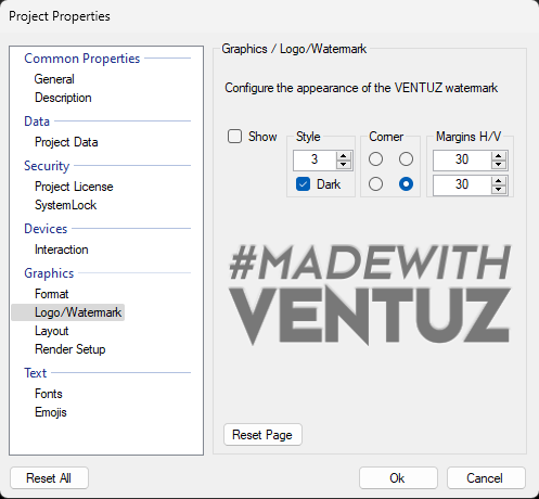

In the Ventuz Community Runtime the engine will render a branding watermark at all times. To let this watermark fit into your project's look more easily you can adjust its style. There are several different watermark images to choose from - each of them are available in transparent white and transparent black. Additionally you can define choose the location of the watermark by adjusting the corner and a margin from the screen's edge.
Note that the size as well as the position of the watermark are all relative to the screen. The Margin is given in Pixels for a target resolution of 4k (3840x2160 Pixels).

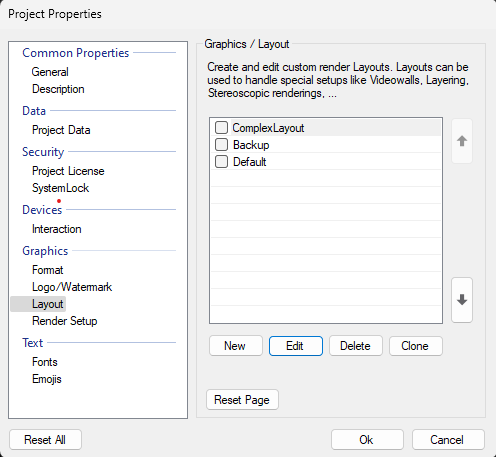

A Layout is a scene loaded by the project in front of the first 'user-scene' on Level 1. Layouts are placed on Level 0 and can be used to create multiple ports the Director can cue and take templates to (see Director Multichannel), achieve more complex setups or process data globally.
A Layout setup is created by clicking the New button. In the General tab, a name for the Layout and the actual Layout scene file can be chosen. The fields Description and Icon can be used to help other users who work on the same project.
The Machine Tags property is a list of comma-separated three-character-codes. They are used to determine which Layout will be used on the current machine. Each machine has a Machine Tag that is defined in its Ventuz Configuration. Once the Runtime is started it will search for that tag in the Layouts - if no tag is given or it is not present in any Layout, the default layout will be used: Every entry in the Layout list has a check-box. The checked Layout is selected as the Runtime Layout which is automatically used if a scene is exported as Presentation (VPR) or the Ventuz Runtime is started in Director mode and no tagged Layout is used.
