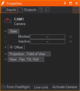

You can use any of the above described cameras to create a camera in in the Hierarchy! Just fly to your desired position, adjust your camera in Free Flight Mode and press Ctrl +  INSERT. A new camera will be create inside the active 3D layer.
If you want to apply the Free Flight camera parameters to an already existing camera simply select the camera and press From Free Flight at the bottom of the Properties Editor.

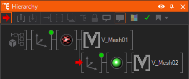

The isolate Mode is basically the Render Point functionality. Doubleclick  doubleclick any object in the Render Window. This will set a Render Point for the selected Object, all other parts of the scene tree are ignored. The navigation and shortcuts are listed below. Doubleclick  doubleclick the selected object again to leave the Isolate Mode
Selecting a node and pressing CTRL + R will set the Render Point to that Node. Additionally you can activate the Render Point in the Hierarchy/- Toolbar or select the Set Render Point from the context menu with a  click on the selected Node. The Render Point defines teh isolated subtree in the Hierarchy. For the following screenshot it means the V_Mesh02 is isolated and centered in your Rendering Window.
As you can see in the screenshot above, other meshes are skipped but Materials, Transformations, Lights are still applied to your isolated mesh or subtree.
In contrast to Ventuz 4 or earlier versions the render engine is not starting to traverse the scene tree at the selected node. The whole tree is traversed but meshes outside the isolated subtree are skipped.
