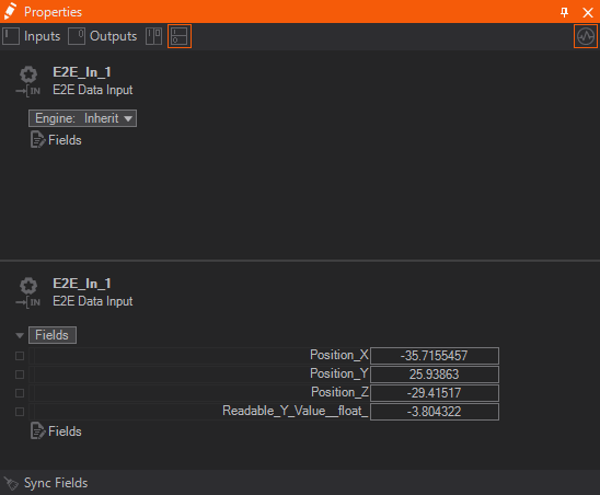

When done you need to adjust its Custom Model that defines the data channel names and types. Click the Fields button in the Properties Editor, select the data type you want to use and then give the custom property a name. Or in the case of ​Notch you would just  click the Sync Fields button in the custom verbs - found in the bottom of the Properties Editor.
The E2E Data In has its custom properties only on the nodes outputs and the E2E Data Out has them only on its inputs. So make sure to enable the correct view in the Properties Editor.

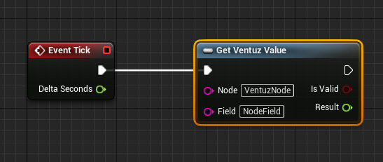

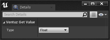

If you want to receive the data in Unreal only directly where you need it (or want to send it directly where you retrieve it) you can use the Get Ventuz Value and Send Ventuz Value nodes. These nodes only transmit a single value to or from the corresponding Ventuz E2E Data node. You can adjust the type of the incoming or outgoing data in the Details Pane of the Unreal Blueprint Editor. Then pass the node the name of the Ventuz node and its data field.

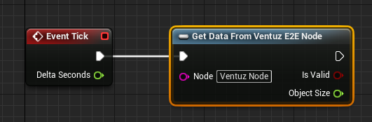

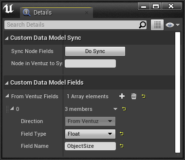

If you better like to receive or send the data of a Ventuz E2E Data node in a centralized location in your blueprint you might want to use the Send Data To Ventuz E2E Node or Get Data From Ventuz E2E Node respectively. These can dynamically create any number of Inputs or Outputs. You can either manually create and edit the read or sent fields with in the Custom Data Model Fields Category or you can type in the Ventuz node name in the Node in Ventuz to Sync From property in the Unreal Blueprint Editor's Details Pane. To synchronize you then only need to hit the Do Sync button. Then you need to pass the node the name of the Ventuz node in the Blueprint Graph.
Note that while you need to pass the Ventuz node's name in the Blueprint Graph in order to make the node work during runtime. Pass the node's name in the Details Pane to make the field synchronization work during design time.

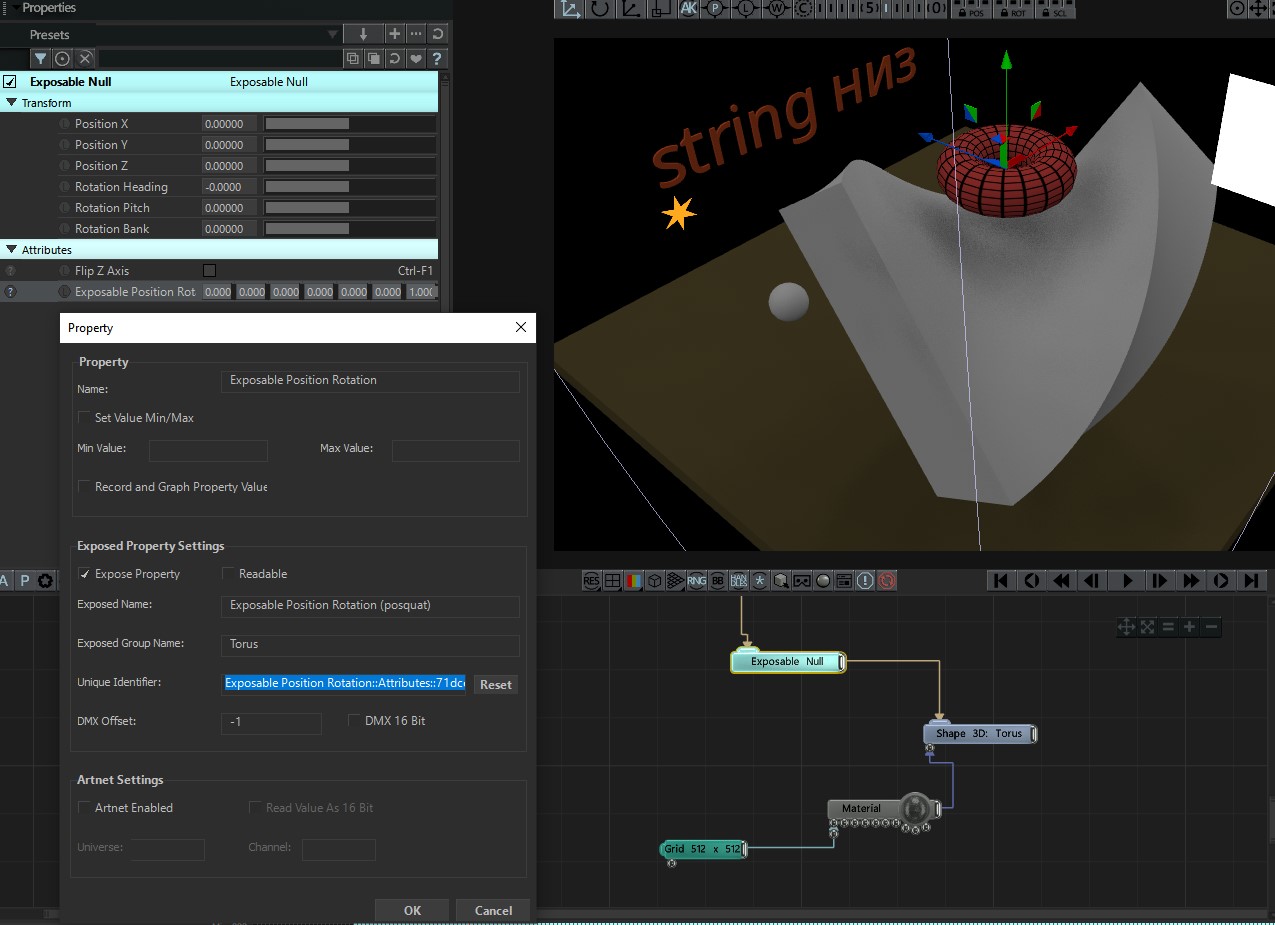

Exposed variables need to be set in ​Notch. For certain tasks, like TRS (translate rotate scale) properties, ​Notch provides a node called Exposable Null. By using this node you can for example, easily expose the XYZ Translation values.
While working with Notch, simply  click the Exposable Null node,  click the ? in front of Attributes - Exposable Position Rotation..... In the next Window, which are the properties for the attributes,  click to check the Expose Property. You can do this for a lot of nodes with Notch. The same you could apply to an Exposable Camera or other variables, including strings for text and so on. The workflow is basically the same - Select the node to access its Properties or Values,  click the ? and expose.
You can make use of the Min/Max values, to define a given range for a value.
