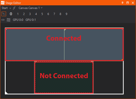

To use multiple Composition Layers, a Render Setup is needed so they will be correctly mapped on the physical outputs. You also have to make sure the Render Setup is activated, you can also check this by opening the Stage Editor. In the Stage Editor, the active configuration is shown. Compositions that are not connected correctly are indicated by the noise pattern on it.

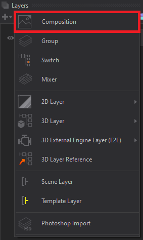

To insert a new Composition Layer use the Add New button inside of the Layer tab, and select "Composition":

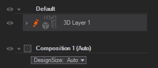

After inserting a Composition Layer you will see the Default Composition and the newly inserted Composition.
Again the noise pattern is indicating a not connected Composition. click on the small square to select the Composition needed.
