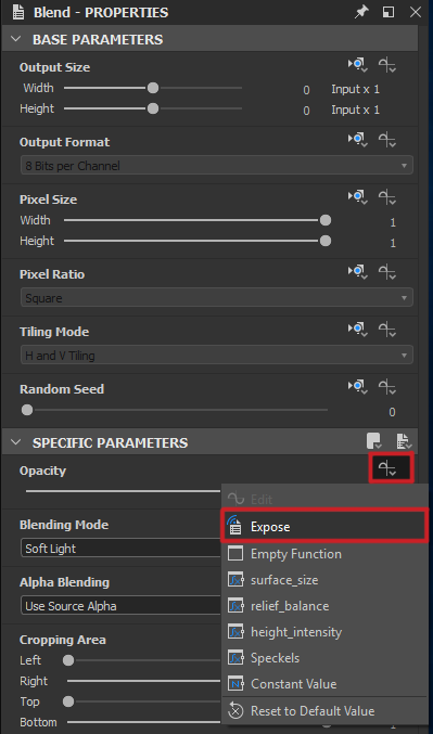

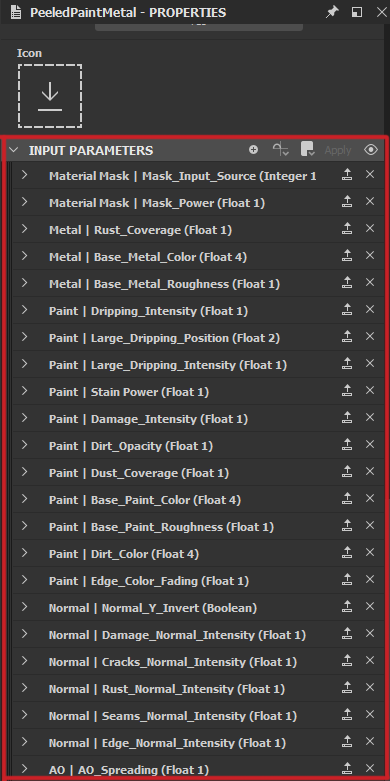

After you are done with creating your Substance Graphs you have to decide which input parameters are important to tweak later e.g.: Blending mode, height intensity, X and Y amount etc. If you want to be able to do so in Ventuz you need to Expose them in Substance Designer. To do so  click the desired function on the parameter tab and hit Expose:
Now you will be able to tweak the exposed parameters once exported. Exposing can be done with nearly every function.
One thing to note here is that after exposing a parameter, it cannot be changed anymore in Substance Designer.

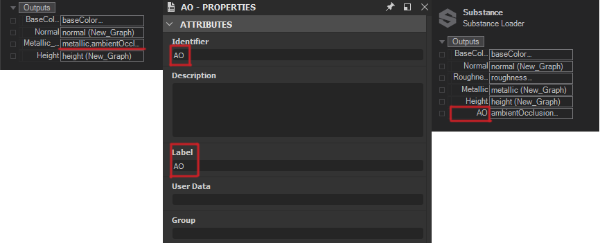

Another thing to note is the semantics of your outputs: The Substance Material node will map the textures to Material Channels based on the Usage property of an output in the Substance Designer. This does not happen in the Substance Loader Node, there all pre-defined Outputs are named like the Outputs you defined in Substance Designer.

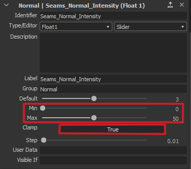

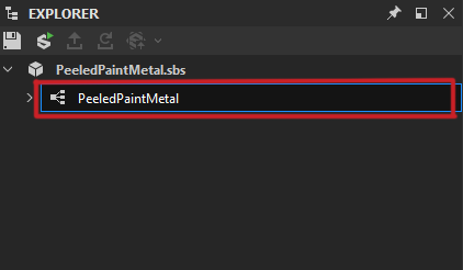

Additionally it´s advised that you set the Min and Max Values and the clamping for those Parameters, because otherwise the Ventuz UI might not be able to adjust the values as expected. To do this  click on the name of your graph on the left side in the explorer. Then just scroll down on the right side in the properties window until you find the input parameters. There you should see the exposed parameters. Now expand the parameter you want to edit, set clamping to true and define the Min and Max values for the slider.
Clamp: if set to True, the user won't be able to enter values beyond what has been defined.

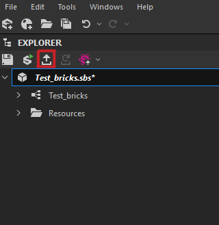

To be able to use it in Ventuz we need a .sbsar file. To create that file you need to  click the Export button inside Substance Designer. This will save your Substance Graph as an .sbsar file. We can then use it inside Ventuz to continue working with it.

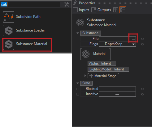

  • Drag it from your Windows Explorer and drop it into the Hierarchy Window to create Substance Material or Content Window to create a Substance Loader.
  • Manually create a Substance Material node or Substance Loader node and load the substance by clicking on the three small dots on the File property in the Properties Editor.

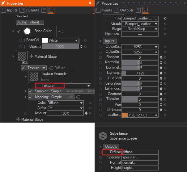

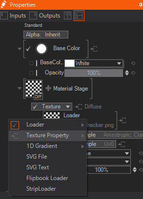

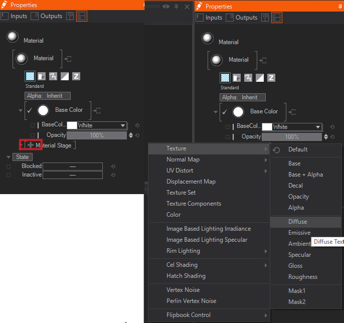

The Substance Loader Node is only usable in the Content Editor window. This node provides you with the feature of using only single textures or channels, for example only the generated Diffuse Map. To do so create a new Material node and load the .sbsar. After that, set a new Material stage, for our example a diffuse channel.
Now  click on Loader and  double click the Texture property's thumbnail.
This will allow you to  drag the Texture property to the Substance Loader node, drop it there and bind it to an according texture in the Output section - e.g. a diffuse texture.

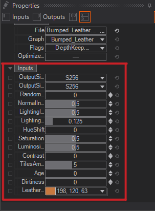

The parameters you exposed during the Preparations are visible in the input of the Substance nodes. Changing these will cause the texture to be newly generated.
With these exposed Parameters you are able to tweak the texture until you get your desired result.
