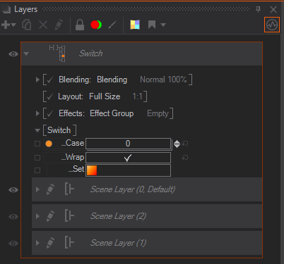

In Ventuz, create a new scene. Add a Layer Switch and add a Scene Layer to each output of the Switch. Set each Scene Port to a different scene you want to show. This will be the Ventuz functionality we want to remote control.
To iterate through the different cases, add a Counter Node, set its End Input Property to the number of the last Switch Output and activate the Loop Property. Bind the Switch's Case Property to the Value output property of the Counter. Try clicking on the plus next to the Counter's Forward Input Property to verify that the switcher is working correctly.

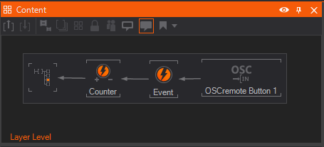

To "connect" the forward method to the OSCemote button, add an OSC Input Node to the scene. Change its port to the port set in OSCemote and set the Address property to /button/A1. Hit Edit Custom Model and add a new int output named buttonstate. Make sure to activate Monitor Values in the Property Editor and see the Message event flash red whenever the button is pressed.
We could now bind the Counter's Forward property to the OSC Input Node's message event but that event is also triggered when the button is released. Instead, add an Event Node and bind it's Shot property to the OSC Input Node's buttonstate output. The Event node will automatically reinterpret the int value such that the event fires whenever the input value changes to non-zero.
