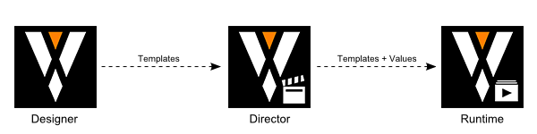

In the previous chapters, we have learned how to cue and take templates as well as the various ways to fill their data fields and use them in the context of a Director Show. Generally, a Director operator will not be the same person as the designer and will rarely ever need to make changes to templates. For larger productions, they may not even be permitted to make changes, since the design has been agreed upon by the art department long before the show goes live. For smaller productions, the design artist and operator may very well be the same person. However, the more likely situation is that a Director operator may be asked to make minor changes (e.g. adding a second line of text, changing a background image, etc.) to a set of templates before the show goes live.
Templates are created using Ventuz Designer. For the remainder of this chapter, it is assumed that the reader has at least some basic knowledge of working inside of Designer. If not, please refer to the Ventuz User Manual.

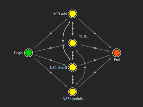

In the example shown above, there would be four templates visible inside Director: NS1L, NS2LAdd, NS2LScroll and NSPlayerInfo.
Routing
When creating templates, one of the first steps is to define which templates relate to each other and which ones are independent. The former should be part of the same animation node, the latter should probably be broken out into different scene files to allow the operator to import only the required templates. If using the Main Animations for your templates, you have to use these in different scene files.
Let's take a look at what really happens in the Ventuz Runtime when the operator cues a template from Director:
  1. Unless it is already in system memory, the required parts of scene file needed for the template are loaded.
  2. The template engine tries to find a route from the current template to the cued template using the transitions defined in the animation state logic.
    1. If both templates are part of different scenes or different animations inside the same scene, the task is split into two: Find a route from current to any End state and then find a route from any Begin state to the cued template.
    2. If both templates are part of the same animation node, a direct route is searched for. If none exists, the task is again split into two routes via Begin/End states.
    3. If no route to a Begin/End state exists, a jump to that state will be performed instead.
  3. Once the operator performs a take, the calculated route will be used to play out the transitions that follow the route.
  4. The template engine stops at any non-begin/end state on the route and will require the operator to perform an additional take, resulting in what is called a multi-take template.
Note that each transition can be valid in either one of its two directions or both directions at the same time. In the example above, there is a transition from NS2LAdd to NS1L that works in both directions. If one is currently active and then replaced by the other, that special transition is used instead of going to End and then returning to the Begin state again. On the other hand, the template engine cannot go from NS2LAdd to NS2LScroll via Begin as the transition from NS2LAdd to Begin is not valid in that direction. The direction of a transition can be changed by selecting a transition and pressing R.
Pressing the R-key will have no effect and no arrow heads will be drawn on transitions unless the animation is part of the Scene Data.
If there are multiple possible routes, the Template Engine always chooses the shortest route possible based on the number of transitions that have to be traveled along. The actual duration of a transition is not part of this criteria.

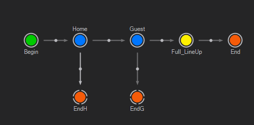

A Multitake Example
As mentioned in the Routing section, Templates can be designed to have multiple takes. To achieve this, add States of the type Normal (N) on the route to the Present State. Each of these represents one take. Assuming a line-up for a team sports match should be designed. At the first take the home team should be shown, at the second take the guest team and at the third take both teams at once. The State Logic for this example could look like the image below:
Adding additional End States to the State Logic gives the possibility to add animation paths to take the Template off air with a defined animation from any State.

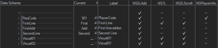

Template Data
To add data that can be edited as part of a template, switch to the Data View inside the Animation Editor. Similar to Animation Channels, any property can be made accessible to a template by simply dragging it from the Property Editor to the Data View to create a new Data Channel. A yellow dot appears next to the property in the property editor to visualize this is now bound to the Animation Data of some Keyframe Animation node.
Since there is one set of data channels for all states in an animation, this data needs to be manually associated with the specific states for which they belong. For example, if one state shows only one line of text and another has an additional line of text for a sub-title, the sub-title data should not appear as a data entry field inside Director when the first template is cued. This is done by toggling the check marks in a states column inside the Data View. In the image above, as an example, the ReqCode data channel is only valid for the NSPlayerInfo state/template.

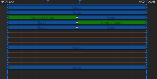

Transition Points
Transition points are useful for choosing when in the animation to update the data when two templates share the same data channel.
Imagine the first template currently being active, and the operator cues the second template and then changes the value in the common data field. What happens when the operator does a take? At which time does the data channel switch from the old to its new value? The default behavior is that the new value is immediately applied which might or might not be what the designer intended to happen. Usually a designer will want text to gracefully transition in instead of the text suddenly changing. There may be a need to hold the old value before switching to the updated one. That period of time can be defined by one or more transition points along a transition curve by pressing M in the Time View.
When a transition is performed, the Template Engine checks if there are any transition points:
  • If there is no transition point, the values of all data channels are immediately updated.
  • If there are transitions points in the animation, the values are updated once the first transition point has been passed.
Why would you need there to be more than one transition point along a transition? This is useful when the transition might be valid in both directions (see the section on Routing) and the point of update might not be the same in both directions. Especially if the update requires resources (e.g. images) to be loaded, it should be triggered as soon as possible to allow the machine as much time as possible to load the assets before the animation makes the new values visible to the user. For example, the new image can start being loaded while the current image is still fading out.

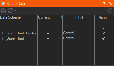

Another way to test transitions is via the Scene Data Editor. Click on the downward pointing triangle in the Current column that is next to any controlled keyframe animation. A list of present and end states will appear and  clicking on any of them will perform one step of the route towards the selected state.
The context menu mentinoed above will only appear if the scene's data model is valid. Ensure there are no error signs visible in the toolbar of the Scene Data Editor if you encounter problems.
