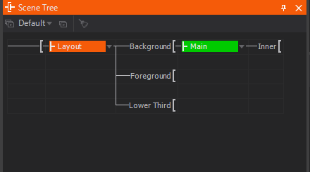

Check the Scene Tree Editor to understand how the scenes are connected.
Every Scene Port has a name (the normal node name) and an Ordinal number starting at zero. This number is used to address Ports within a scene via Remoting. It is also important for Layout Scenes. The ordinal number can be changed via the node context menu in the Hierarchy Editor or the buttons at the bottom of the Property Editor. A scene assigned to a Port can be opened and edited on-the-fly without the need to reload it into its current scene ports. A scene-to-scene communication can be realized via the Interfacing mechanism as will be discussed later.
