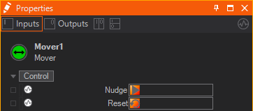

To start watching a value you can either  drag and drop the property in the Watches Editor like if you were creating a binding. Or you can select the property in the Property Editor and hit W. Lastly you can also  click the property to open its context menu and select the Watch Value entry. A watched property will be marked with the decoration.
To stop watching a property you can select it and hit W again or use the context menu entry. Alternatively you can select the property in the Watches Editor and hit DEL.
You can watch any bindable property. Their names in the Watches Editor will concatenate the node's name with the property's name. You can change their name in the editor by double clicking the property. With CTRL + ↑ and CTRL + ↓ you can change the order of the properties. With O you can navigate to the original node.
