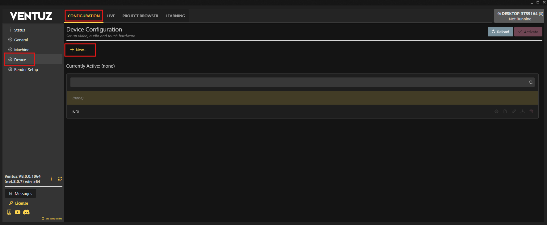

To use Stream Out we need to create a Device Configuration for it. Head to the configuration tab inside the launcher or configuration editor and create a new device configuration.

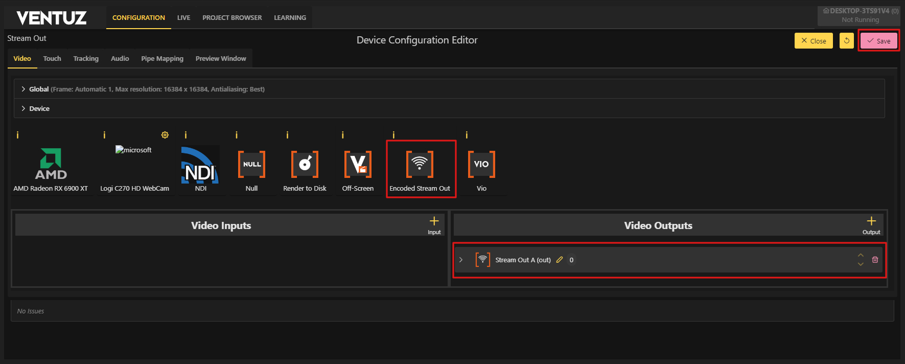

After naming and creating your configuration add a Stream Out to the right output side via drag and drop.
The properties of this output type differ a few ways from other output types.
