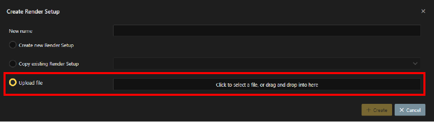

Import and Export Render Setup
It is possible to Import and Export existing Render Setups to and from Projects and to import from previous versions of Ventuz when using the Migration assist tool.

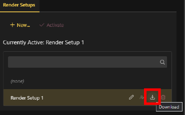

Export
To export a Render Setup, hover over the "Download" button and  click. Save the file in a desired folder on your hard drive.
Import
To Import an existing Render Setup file,  Click on "New...", in the pop-up select "Import Render Setup" and navigate to the location the desired Render Setup file is stored.

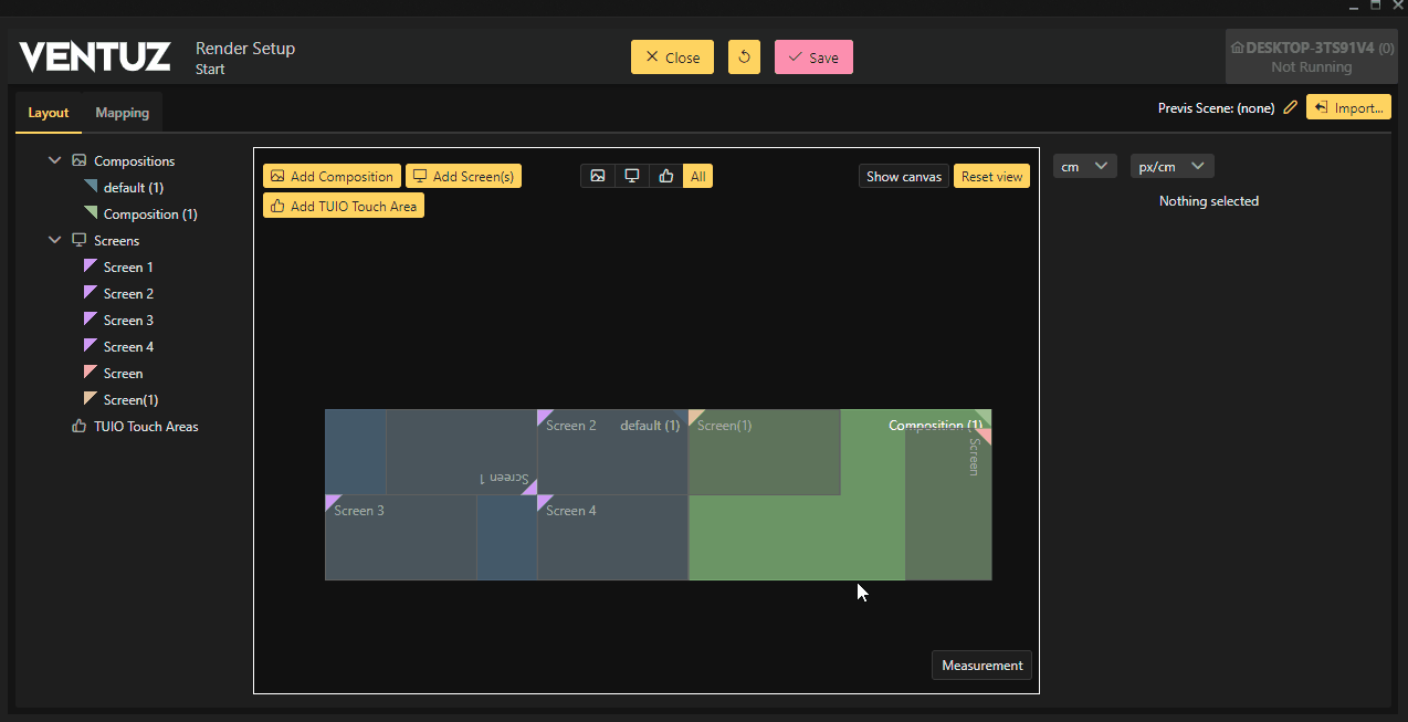

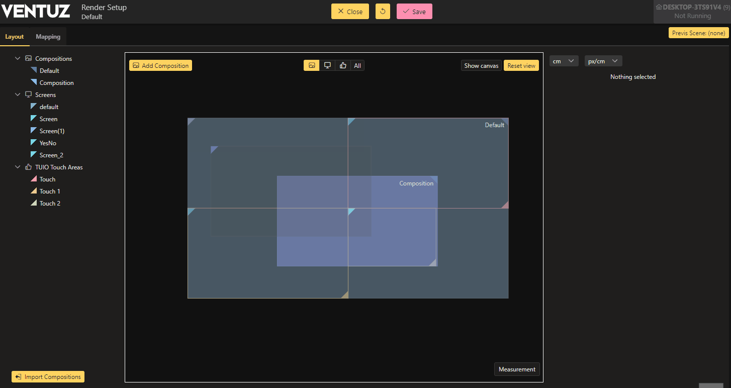

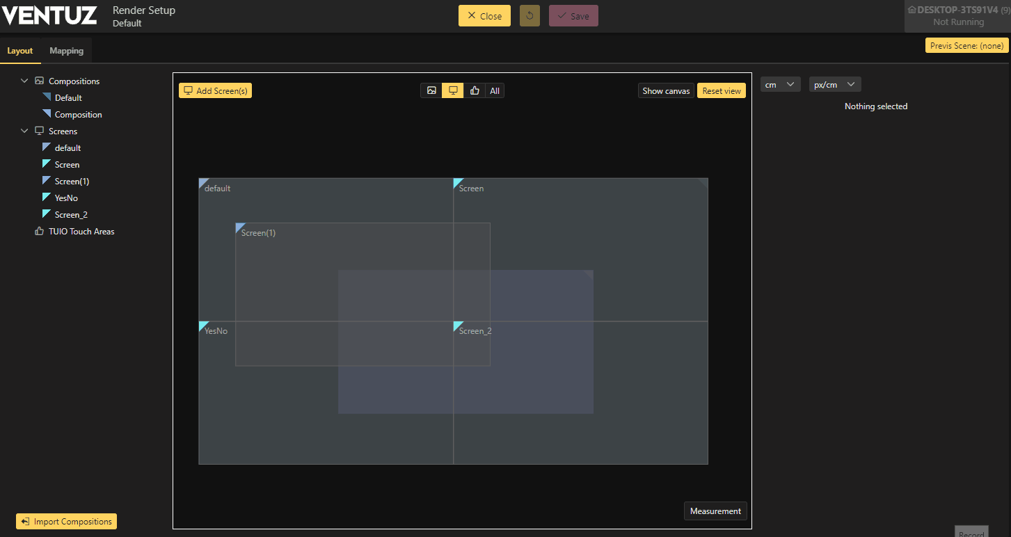

Layout Mode

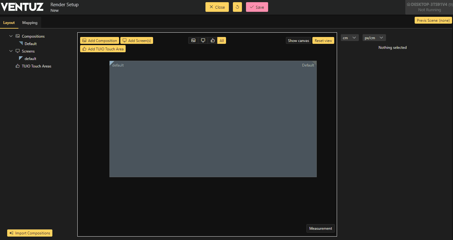

Once the new Render Setup is created, the Render Setup window will automatically open in the Layout Mode. To edit an existing Render Setup  click on the Pencil Icon inside of the existing Render Setup.
Generally speaking this is the mode where you set the stage for you presentation, add screens and use compositions to set the frame for your rendering. To learn more about the handling of our new output system read this page.

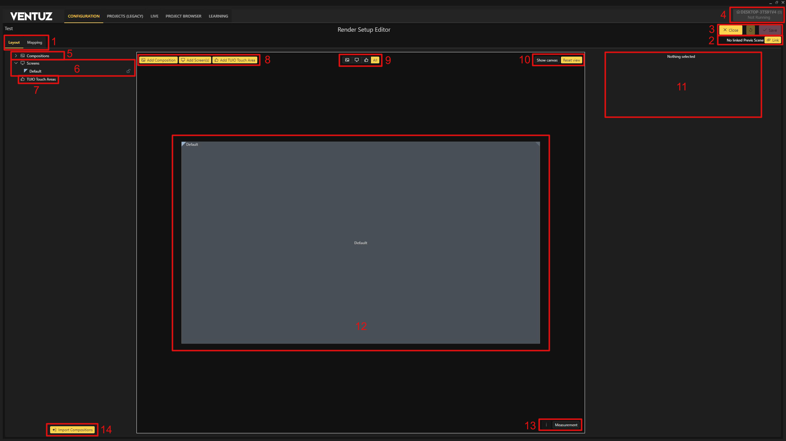

1. Mode Change:
  • Change between the Layout and Mapping mode
2. Previs:
  • Select Previsualization Scenes currently available inside your .vzp Ventuz Project via the Pencil icon and import them, make sure you saved them recently after a upgrade to a higher version or you wont be able to see your scenes.
Previsualization scenes wont have a layout mode since these screens are placed in a 3D world and these positions can't be converted to function in the Layout mode. Instead it uses the Mapping mode only to assign these screens to Outputs
3. Close and Save:
  • Close: Closes the Render Setup Editor
  • Save: Saves the recent changes and applies them. This will also apply it to a running runtime which can interrupt the rendering!
  • Undo: Undo your changes, CTRL+Z also works.
  • Live: Click this Checkbox to see your changes in real time when the associated project is running in Ventuz Runtime.
Using the Live mode will interrupt the rendering on every change!
4. Machine Selection:
  • Currently selected machine. Select the appropriate machine before going into the Editor.
5. Compositions:
  • Select and add Compositions inside the Tree View. Via its possible to add either Instances or new Compositions. A Double click lets you change the name, this is also possible inside the Properties Window (11) The Default Composition name cannot be changed. Deleting is done by and using the drop down menu. Here you can also change the Rendering Order of the compositions. If multiple Compositions are placed on the same output the render order may need to be changed to achieve your desired results. To accomplish this, simply  drag+drop to change it.
6. Screens: Select via and add Screens with the . Adding Screens and Compositions is also possible by right clicking inside the view window depending on the mode you are in. 7. TUIO Touch areas:
  • Add or delete TUIO Touch areas to define which parts of your setup should be interactive. Windows touch is not assignable through this area. Use the Multi capabilities and touch groups for Windows Touch that can be found inside of the [MachineConfigurationAV#Touch Machine Configuration Window].
8. Contextual Controls:
  • Depending on the mode you are in these buttons offers the functions to add objects. Like you can by using the tree view or inside the view window.
9. Mode Selection:
  • The Render setup editor has different "editing" modes. To only edit Compositions use the button on the left. Right beside that is the Screens edit button and besides that you can find the Touch area edit mode. Or use the ALL button to be able to select everything either in a multi selection or one by one.
10. View Options:
  • Reset View
    • Reset the workspace view to 0.0.
  • Show Canvas
    • Shows the Canvas(es)
11. Property Editor:
  • Holds the properties of selected elements. Measurements can be in metric or imperial units.
12. Workspace:
Displays the created elements and allows editing of these elements. See Shortcuts for full list of hotkeys.
  • Use  Drag to move elements around
  • Hold down the middle mouse button to pan the view
  • to open the context menu
  • Using the scroll wheel will zoom the view in and out
  • multiple times on the same spot will click through items so selecting the ones beneath is easier
13. Measurement Tool:
  • Enables the Measurement Tool, use this to measure distances between elements. Displayed in centimeters. on a edge or corner of a element and drag it over to a second point.
14. Import Compositions:
  • Import Composition layer from a scene. This way you dont have to replicate what you already did inside the Designer.

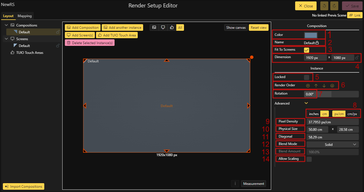

Compositions
1. Color
  • Changes the color of the Composition
2. Name
  • Changes the Name of the Composition. This is locked for Default Compositions
3.Fit to Screen
  • This is a unique feature for the Default Composition, when turned off the composition wont scale with screens moved inside it anymore
4. Dimension
  • Sets the Virtual Dimension for the Composition
5. Lock
  • Locks the selected composition or screen in position and size.
6. Render Order
  • Changes the Rendering Order
7. Rotation
  • Displays the current rotation value of the selected element. This can be changed by dragging the property, directly typing in it or by using the dot in the upper right corner of the view port
8. Units of measurement
  • Choose the unit of measurement from centimeter to inches. And change between pixel per centimeter or centimeter per pixel.
9. Pixel Density
  • Sets the Pixel Density per cm/inch for the Composition
10. Physical Size
  • Sets the Physical size of the Composition
11. Diagonal
  • The Diagonal width of the Composition

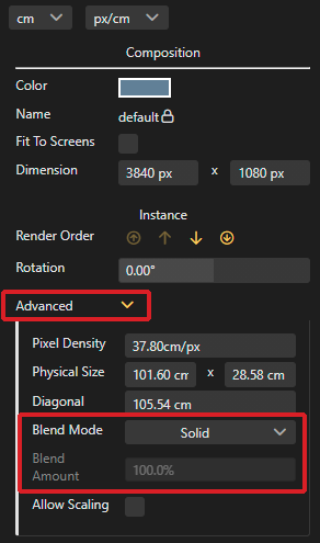

12. Blend Mode
  • Sets the Blending mode for the Compositions. This only applies for stacked compositions
13. Blend Amount
  • The Amount of blending, lower values means less blending of the elements
14. Allow Scaling
  • Enables the Scaling function, only usable for instanced content

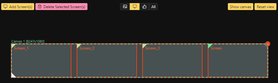

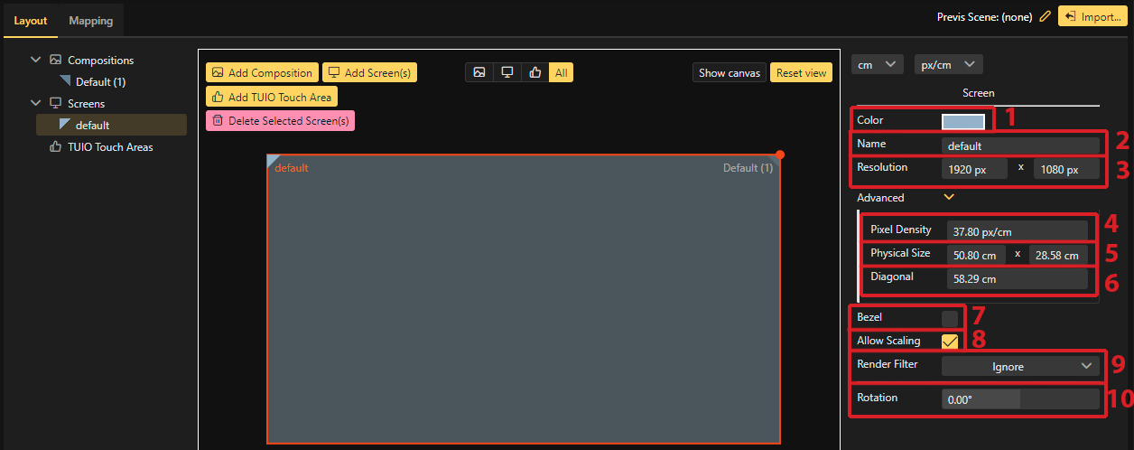

Screens
1. Color
  • Changes the color of the Screen
2. Name
  • Changes the Name of the Screen.
3. Resolution
  • Sets the Virtual Resolution of the Screen
4. Pixel Density
  • Sets the Pixel Density per cm/inch for the Screen
5. Physical Size
  • Sets the Physical size of the Screen
6. Diagonal
  • The Diagonal width of the Screen
7. Bezel
  • Activates the Bezel function for the selected screen/s
8. Allow Scaling
9. Render Filter
  • Use this to filter out specific content by choosing different Render Filter groups, only functioning in conjunction with the Render Filter node
10. Rotation

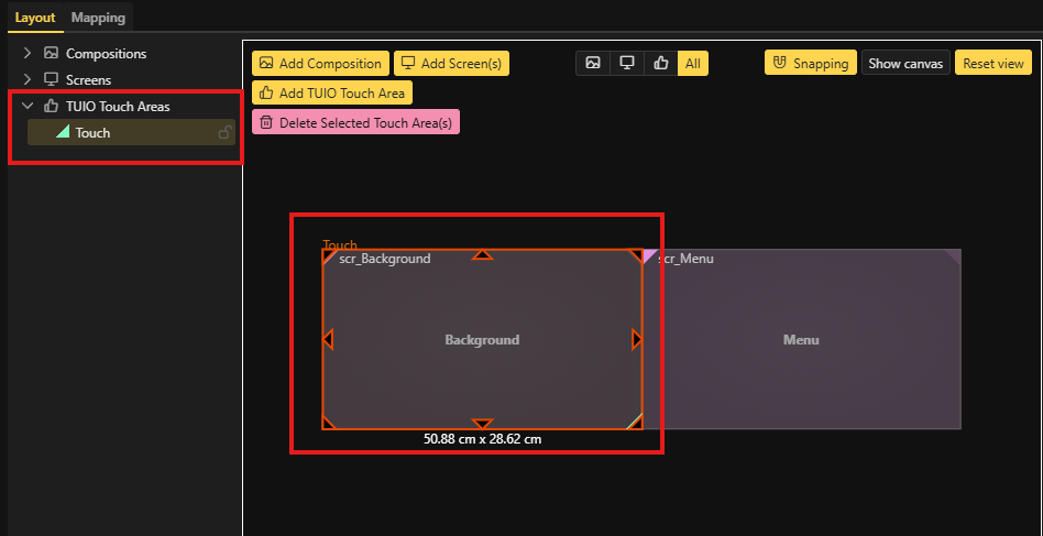

TUIO Touch Areas
1. Color
  • Changes the color of the Touch Area
2. Name
  • Changes the Name of the Touch Area
5. Physical Size
  • Sets the Physical size of the Touch Area

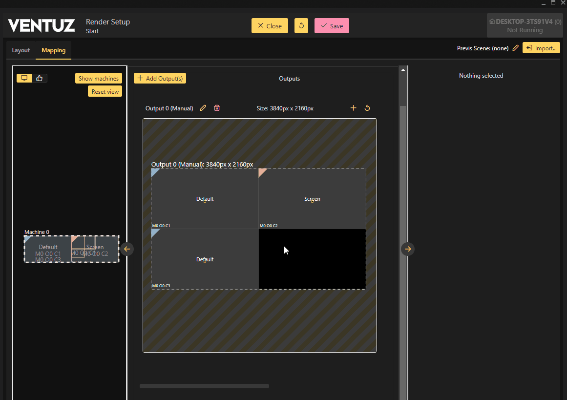

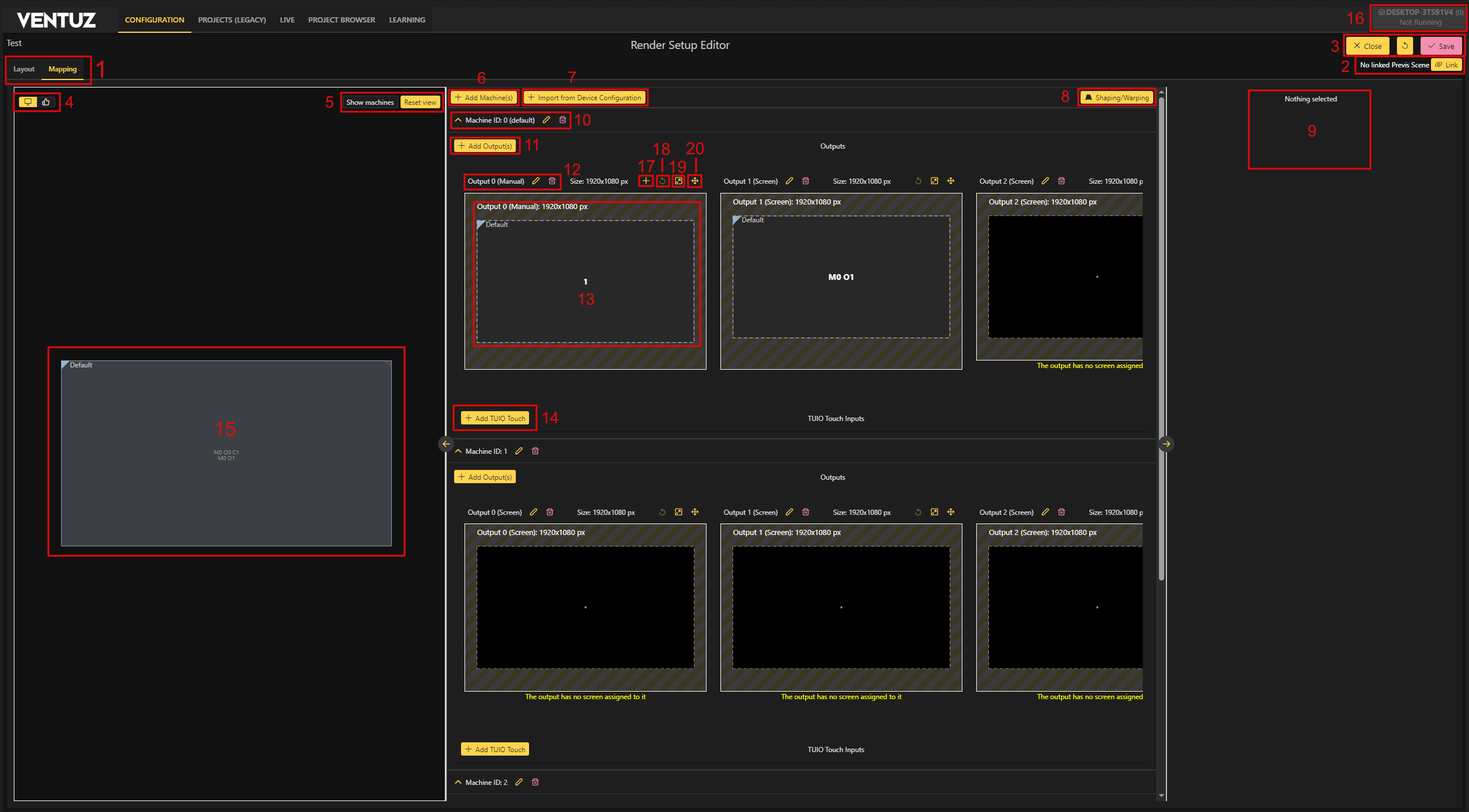

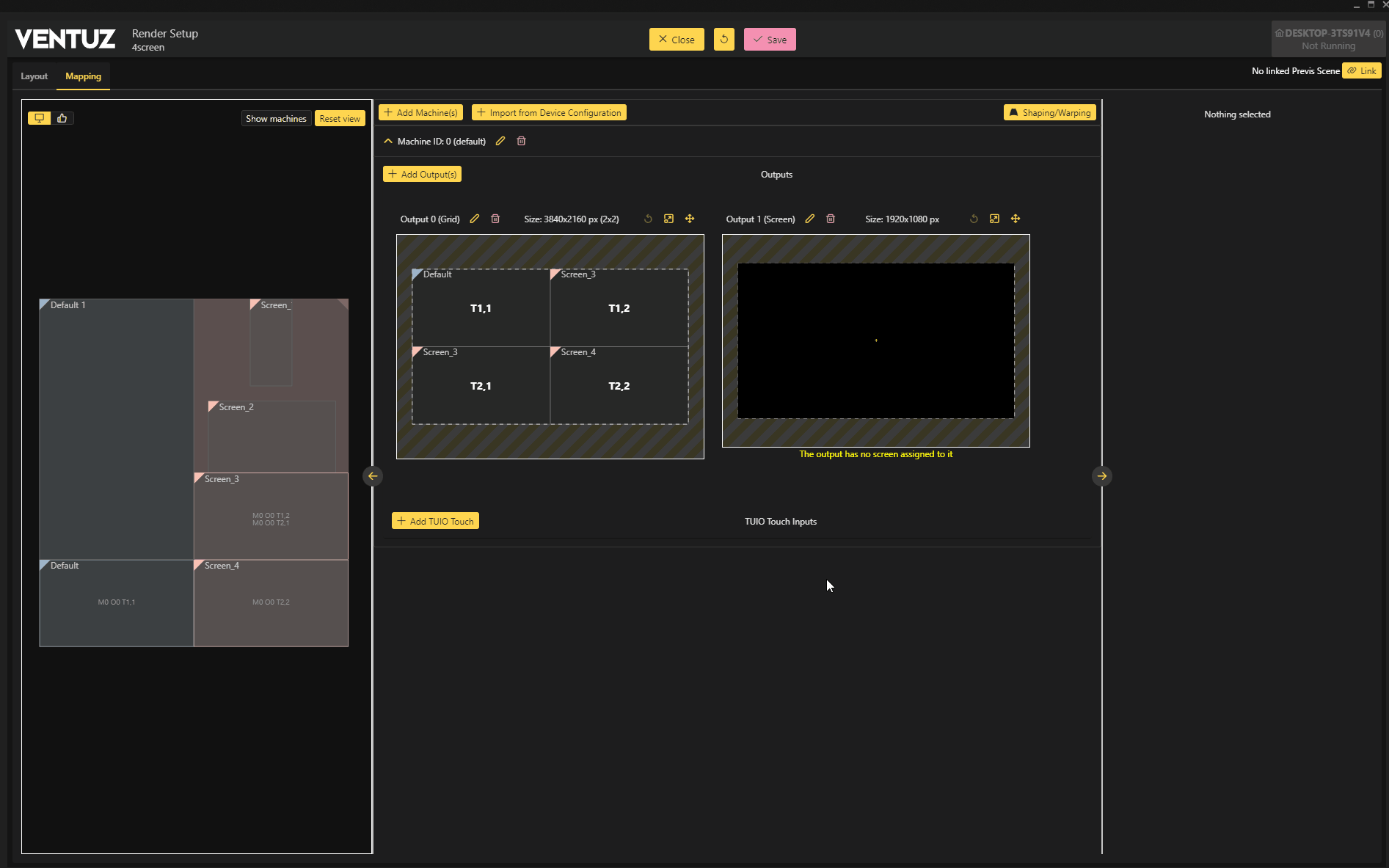

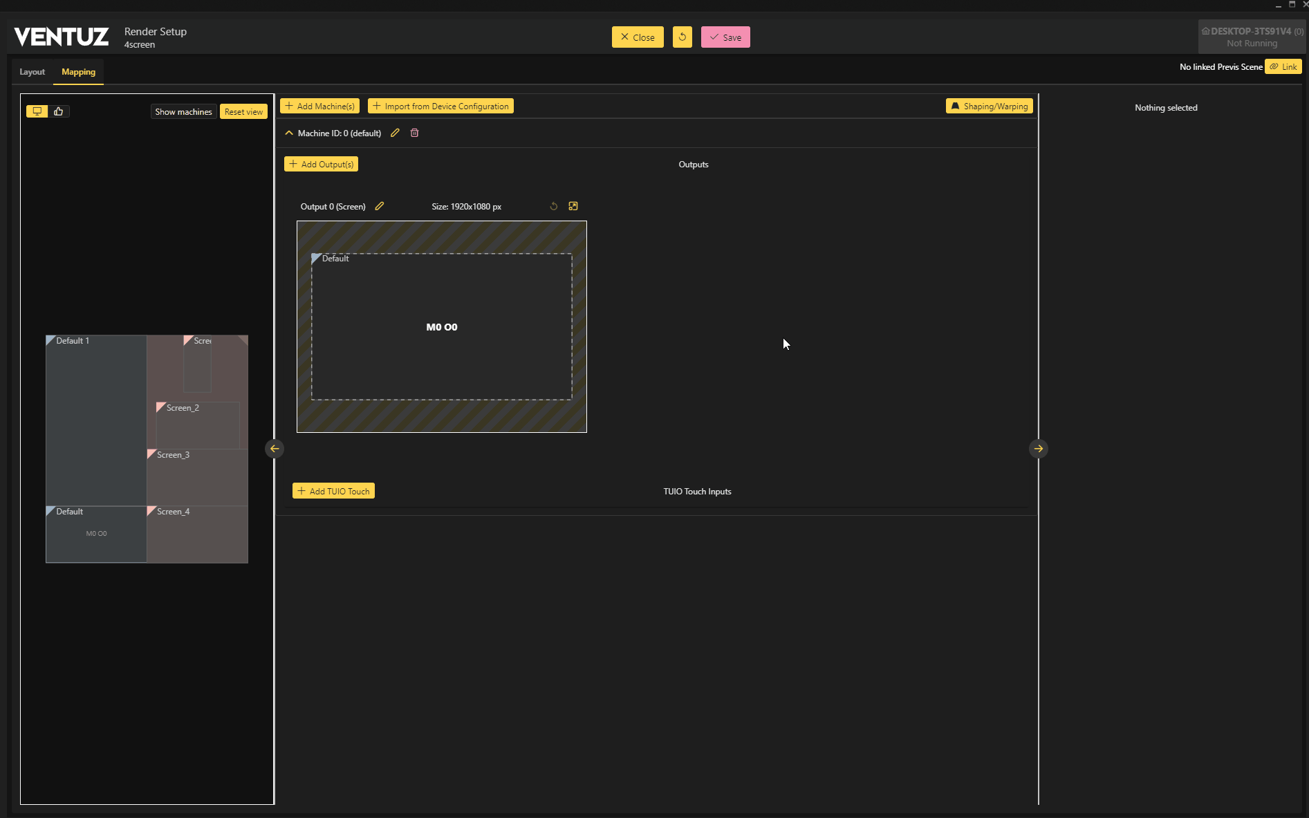

Mapping Mode
With the Mapping mode it is possible to assign Screens to Outputs, add new machines, or shape and warp Outputs.
1. Mode Change:
  • Change between the Layout and Mapping Mode.
2. Previs:
  • Select Previsualization Scenes currently available inside your .vzp Ventuz Project and import them into the Render Setup.
3. Close and Save:
    • If the Render Setup that you're editing is active, clicking Save will apply it to a running Runtime. This can interrupt the rendering of each Runtime!
4. Mode Selection:
  • The Mapping mode has two different modes to show; All screens, or All Touch areas separately.
5. View Options:
  • Show Machines: Will highlight machine borders with a white dotted line.
  • Reset View: Resets the workspace view to 0.0
6. Add machines:
  • Adds another machine to the Output list. Here you can also setup things like the Machine ID how many outputs that machine has and so on.

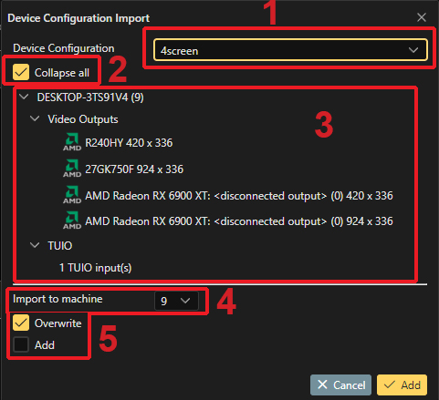

7. Import Device Configuration:
  • This lets you import complete Device configurations currently available on the selected machine. Take a look into the Import Device Configuration section to learn more.
8. Shaping & Warping:
  • Select a screen to Warp and use this button to get into the Shaping&Warping editor.
9. Property Editor:
  • Holds the properties of selected elements. Measurements can be in Metric or Imperial.
10. Machine Options:
  • Use the Pencil to edit the currently used MachineID. Or use the bucket to delete the machine with its outputs. This will also use your current machine ID when creating the Render Setup.
11. Add Outputs:
  • Add outputs to the machine.

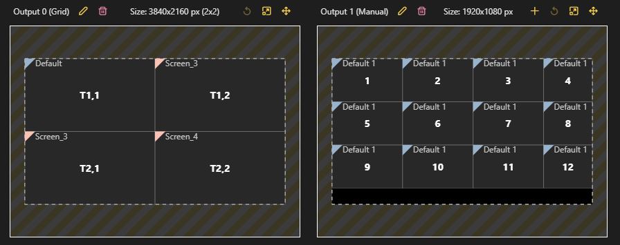

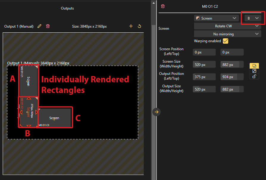

12. Output Options: There are three output types available:
  • Single Screen: the output will only use one screen.
  • Grid: Allows to assign multiple screens to one output.
  • Manual: Adjust the output resolution and screen sizes manually.
  • Name: Here you can change the name of the current output. When imported from a device configuration this will have the name according to that configuration.
13. Output Workspace:
  • Shows the output in its chosen configuration. Selectable with the . Pan the view with the middle mouse button. And use the scroll wheel to zoom in and out. When set to manual and dropping a screen onto it you can hold SHIFT to tile the screen directly.

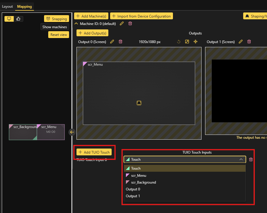

14. TUIO Touch inputs:
  • Add TUIO touch inputs to the output. It is possible to either use the Touch areas in the Layout mode or directly assign complete screens to a TUIO touch input.
15. Workspace:
  • Workspace shows the machine boarder as well as all configured Screens and Touch areas. These can be dragged and dropped on to outputs to configure them. Multi select is also possible.
16. Selected Machine/Group:
  • Shows the machine or cluster group that is currently selected.
17. Adding cuts:
  • When the output is put to Manual mode you can use this button to add cuts.
18. Reset of the view:
  • Resets the view to the center.
19. Maximize output:
  • Use this to maximizie one output to a bigger size, which makes working with a lot of smaller cuts alot easier. You can also double click the output to open and close it. Also navigating through the outputs is possible with the arrow buttons on the top when maximized.
20. Moving of outputs:
  • With this button you can move outputs to a different slot, but keep in mind that these outputs represent your physical GPU outputs! First output will also always be the top one in your Device configuration. And if these not match correctly the outputs will render incorrectly. We advice using the configuration import to minimize the risk of such issues.
After clicking on the Device Configuration Import button you will be greeted with this small helper pop up.
1: Device Configuration:
  • Choose a Configuration from the drop down menu. This will show all available Device Configurations.
2: Collapse all:
  • Collapse the whole tree,
3: Configuration Overview:
  • This shows an overview of the content inside the selected Device Configuration. The names of the outputs will be added to the outputs in the Mapping Mode.
4: Choosing a machine to import to:
  • Here you choose to which machine the outputs should be added. IDs are taken from the currently configured IDs inside the Machine Configuration.
5: Choose to overwrite or add:
  • Choose if you want to overwrite the current mapping or add (append) it to the existing ones.
For a Cluster Configuration Imports, only the currently active configurations from the machines inside that group can be used. Also note that you have to choose the correct group before opening a new Render Setup for that cluster!

The Screens and Compositions in the Render Setup Editor lie in a real world sized coordinate space. The origin of this coordinate space is the middle starting with (0.0.).
Logical vs. Visual Resolution
In the context of the Render Setup configuration we talk about Logical and Visual Resolutions. These terms will be explained here. The logical resolution of a machine can be defined by the Mosaic or Eyefinity configuration of the graphics board. A 2x2 display setup with a resolution of 1920 x 1080 px per display has a logical resolution of 3840 x 2160 pixels.
The visual resolution however is defined by final position of the displays in the Render Setup configuration. In the example below the displays are arranged horizontally and have bezel between each other. This leads to the visual resolution of 8247 x 1080 pixel.
The maximum visual resolution for a GPU currently is 16384 x 16384 pixels!
Manipulating a Render Setup
Selecting and Moving Elements
Elements can be selected by simply  click. Multi selection is possible by dragging a selection frame  drag around elements inside the All mode.
Elements that can be selected are the Screens, Compositions,and Touch areas. Each of these elements have there separate editing modes.
Moving is done by dragging and dropping, scaling can be done by the indicator on the Compositions. Selecting items in the tree view also changes the modes accordingly Rotations can be snapped to 10° or 5° using CTRL(10) or ALT(5)
Use the All mode to quickly move a bunch of elements Scaling only works for Compositions and TUIO Touch Areas, to resize screens use the Property Editor

Output Types
Using the Mapping Mode it is possible to change to different output types, assign multiple screens to the same output or use only specific parts of a given screen by using Cuts.
To change to different output types use the pencil button.
Single
Uses a single screen on the output. Assign a screen by  drag + drop from the left pane onto the desired output on the right.
Grid
Assign multiple complete Screens to a single output in a grid which can be individually customized.
Manual
Gives the user full control of the output size, individual screen size and position. Rotating the output in 90° steps is possible here.
It is possible to use the same screen multiple times by applying them to multiple times to the same output. Notice how the original size of the Screen set in the Layout cant be overwritten by this. You can also choose which portion should be rendered, change this by changing the screen position in the left view.
While in manual mode, it is possible to link the size or aspect of the output to the individual cuts.
Link Size: Links the output size directly to the screen size.
Link Aspect: Links the aspect of the cut to the screen.
Unlinked: Screen and outputs are handled individually. The output will be scaled accordingly.
Overlaps wont blend! They will be stacked on the output, depending on which screen where assigned first.
It is also possible to hold down the SHIFT key when dragging screens onto a output to tile it to the desired size automatically.
Cuts
In general as soon as one uses either the Grid or Manual mode the output will be cut into multiple pieces. Indicated by the label in the middle. For the Grid mode this will show 1.1 1.2 and so on depending on there position in the output. For Manual tiling it will simply count upwards.
M0 = Machine + ID
O0 = Output + Number of output starting with 0
C1 = Cut + Number of the cut counting upwards from 1

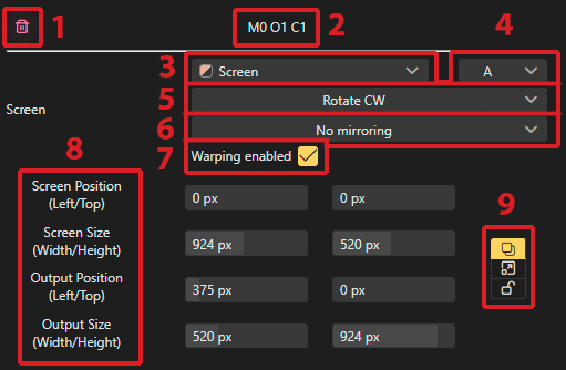

Properties
1:
  • Deletes the currently selected screen from inside the output
2:
  • Output label also shown on the screen itself inside the output mapping in the lower left corner
3:
  • Dropdown menu to change to different screens for the output
4:
  • Seperation groups
5:
  • Choose the rotation of the screen inside the output. This can be also done by using the handle in the upper right corner when clicking on a screen inside a output.
6:
  • Menu to enable different mirror modes for the output
*Mirror H: Mirrors horizontally *Mirror V: Mirrors Vertically
7:
  • Enable or disable Warping&Shaping for the selected screen
8:
  • Screen Position: displays the current X and Y position of the screen cut outside of the output.
  • Screen Size: the current size of the selected screen. This can be independent from the actual output size which will be rendered.
  • Output Position: the current position of the screen inside of the output.
  • Output Size: actual used render size for the selected screen.
9:
  • Link Size: Links the output size directly to the screen size.
  • Link Aspect: Links the aspect of the cut to the screen.
  • Unlinked: Screen and outputs are handled individually. The output will be scaled accordingly.

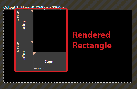

Separation
By using different separation groups for output cuts its possible to use the rendering more efficiently.
Without separation groups:
Ventuz will render everything in one single rectangle.
With separation groups:
Ventuz will render single screens separately.

TUIO Touch Area
The TUIO Touch Area allows remapping of incoming touch data to a custom area of the used #Screens. Ventuz Input Subsystem receives the touch data from attached touch devices. The touch is interpreted in normalized coordinates from 0,0 to 1,0 from the top left corner to the bottom right corner. By default, there is no TUIO Touch Area and will apply to all outputs. To specifically assign touch to either screens or outputs use the Mapping Mode.
Creating Tuio Touch area inside the layout mode is a purely visible helper until the touch are is assigned inside the Mapping mode.
In order to assign a Tuio Touch area to a specific part of a output/screen or to the touch area directly you have to first hit the Add Tuio Touch button and then choose the wanted screen/output or Touch area. This has to be done per individual Touch area and per machine if there are multiple.
Windows Touch is not affected by TUIO touch areas and will always span across all outputs, please use the multi gpu capabilities as well as touch groups to define specific areas which you want to limit!
Windows Touch is does work in a cluster configuration, but with severe limitations e.g: interactive Objects spanning across 2 machines wont update correct

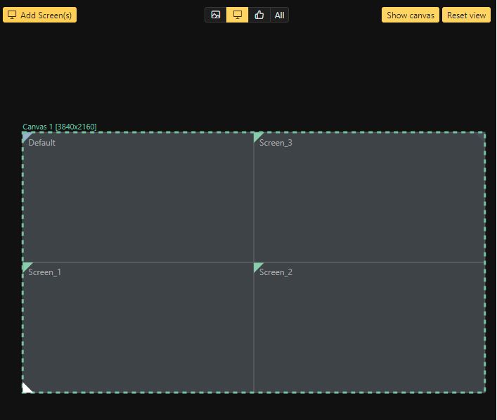

The Default Composition will always scale with the screens used on it. This is only possible in the default Composition.
In this example use the Render Setup Editor, there is a simple two screen setup where the content is spanned two Full HD screens. In Ventuz 6 this required a display span mode like Mosaic to work. Now this can be achieved using several different approaches without the need for Mosaic or Eyefinity.
In this case, add a second screen and place it right beside the default one to achieve a dual output setup.
All the settings seen in the Pop up window, except for the adding of new compositions directly, will also be available inside the property window.
Use the middle mouse button to pan the view. Or scroll the middle mouse wheel to zoom in and out. click and drag on any element this will shift it around inside the workspace. Snapping is also always on which should help you align elements easily.
As you can see the Default Compositions scaled with the new screen inserted, this wont be the case for any other composition then the default. This feature exists to make simpler setups faster and easier to achieve. It can be disabled by unchecking the "Fit to Screens" option in the properties pane.
