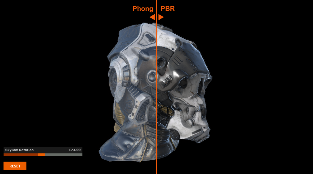

Visualization of Phong vs Physically Based Rendering
With the implementation of PBR (Physically Based Rendering) into Ventuz we will outline all you need to know to get your project working with PBR.
The key to understanding what's happening with the PBR workflow is that PBR separates the Light from the Material. With this approach, you can have independent lighting and material based scenes. Whenever you decide to change the environment, which can be based on an HDRi using the PBR Sky Box Node for example, you don't need to tweak any material settings.
