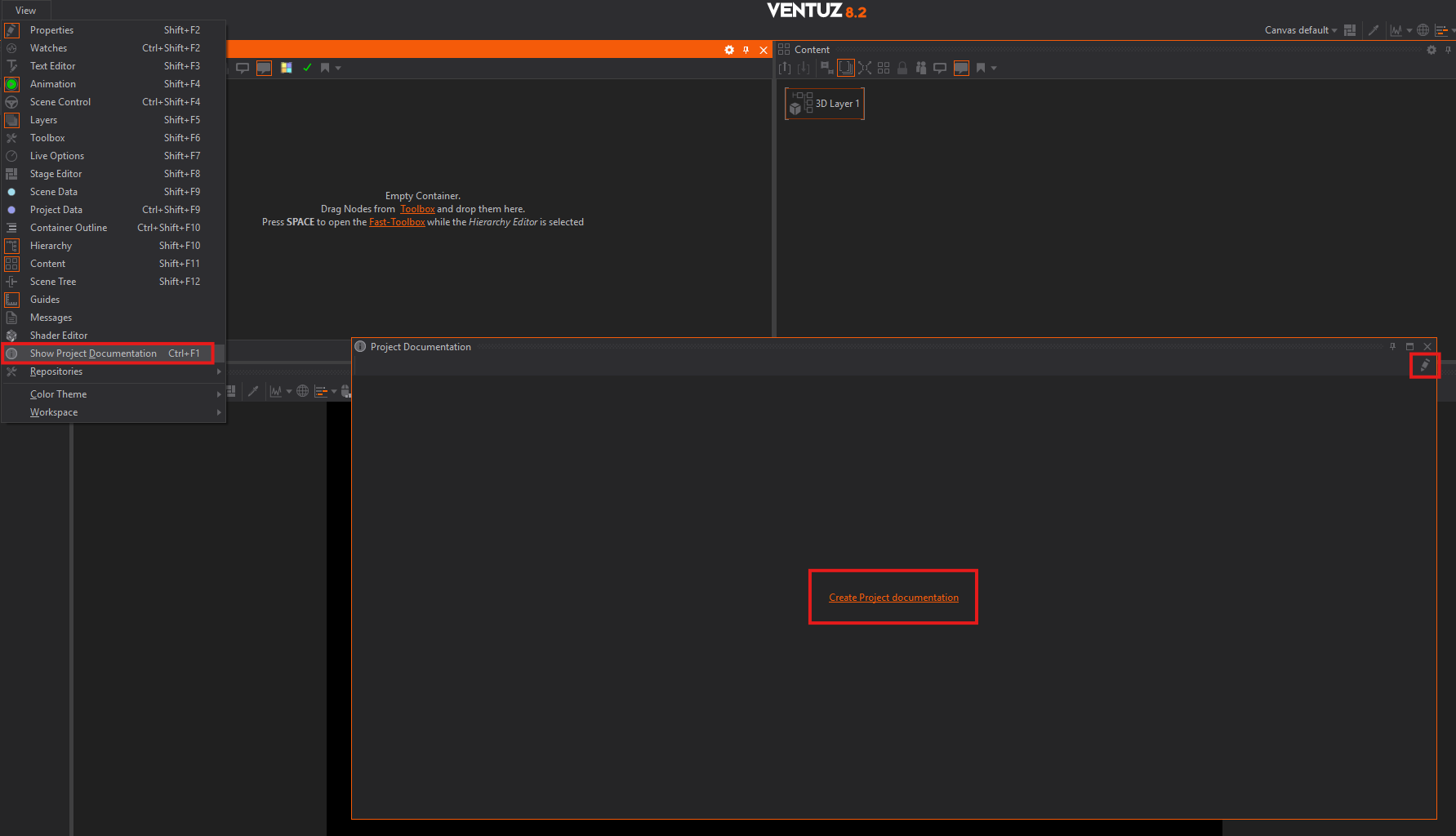

Creating Documentation
After you've created your project head over to the view tab and click on Show Project Documentation. This will open the documentation window where you can click on either the orange info text or the small pencil in the corner to create a documentation file.
This creates a index.md file inside the documentation folder of your projects folder structure.
It will also open you default editor for .md files where you will have a default template which you can build upon.
