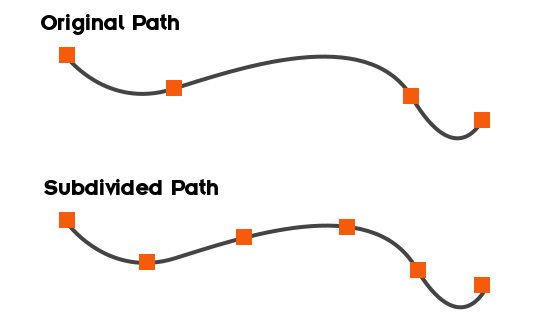

Subdivide Path takes a path and re-arranges its points so that even distances between them are created. This is mainly used to create a constant speed along the whole path - e.g. for animations along it. You can see a simple visualization of the original path and the result in the image below.
